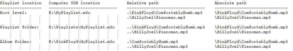

In summary:
Playlist location Computer USB location Relative path Absolute path
Root level: E:\MyPlaylist.m3u .\PinkFloyd\ComfortablyNumb.mp3 \PinkFloyd\ComfortablyNumb.mp3
.\BillyJoel\Pianoman.mp3 \BillyJoel\Pianoman.mp3
Playlist folder: E:\Playlists\MyPlaylist.m3u ..\PinkFloyd\ComfortablyNumb.mp3 \PinkFloyd\ComfortablyNumb.mp3
..\BillyJoel\Pianoman.mp3 \BillyJoel\Pianoman.mp3
Album folder: E:\PinkFloyd\MyPlaylist.m3u .\ComfortablyNumb.mp3 \PinkFloyd\ComfortablyNumb.mp3

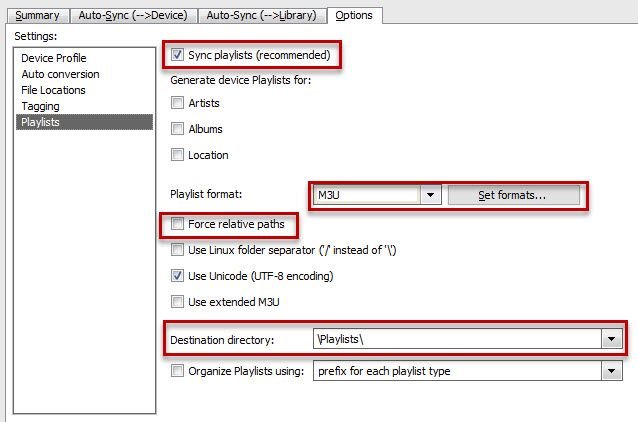

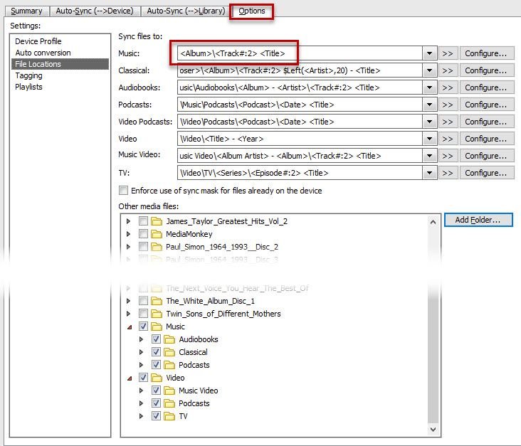

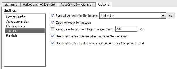

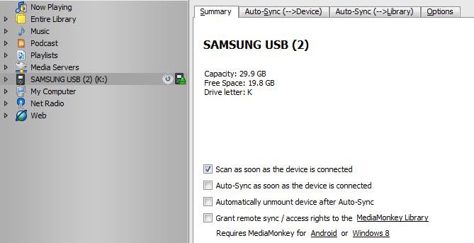

I also use MediaMonkey for my collection and to create and sync my USB device for the RDX. In the sync process there is a checkbox to "Force relative paths", which I leave unchecked.
Here is a sample of songs in one of my playlist files:
\Music\Phoebe_Snow\Best_of_Phoebe_Snow\004 Teach_Me_Tonight.mp3
\Music\James_Taylor\James_Taylor_Greatest_Hits_Vol _2\011 Ive_Got_To_Stop_Thinkin_Bout_That.mp3
\Music\Electric_Light_Orchestra\Out_of_The_Blue\01 3 Mr_Blue_Sky.mp3
\Music\Paul_Simon\Paul_Simon_1964_1993_Disc_2\014 Late_in_the_Evening.mp3
\Music\Fleetwood_Mac\Rumours\003 Never_Going_Back_Again.mp3
\Music\Crosby_Stills_Nash_and_Young\So_Far\006 Find_The_Cost_Of_Freedom.mp3
\Music\James_Taylor\Sweet_Baby_James\004 Steamroller.mp3
\Music\Orleans\Super_Hits_of_The_70s_Have_a_Nice_D ay_Vol_19\001 Still_the_One.mp3
\Music\Paul_Simon\Paul_Simon_1964_1993_Disc_2\004 Gone_at_Last.mp3
\Music\Van_Morrison\The_Best_of_Van_Morrison\003 Moondance.mp3
Probably nothing new to most of you, but it might help some.

I just noticed the summary table didn't format well:

Hey Ron
Thank you will try one more time using Media Monkey
Could you tell me what your settings are for Media Monkey ( A snap shot will do)
Thank you

This is MediaMonkey 4.n, but 5.n should be similar if that is what you are using. Hope this helps.
Here is the FLAC Auto Playlist definition. Essentially, any file with "flac" in the name AND a rating of 3 stars or higher (rating:3..)

Well that didnt help.
Under Audio conversion what are your settings?
