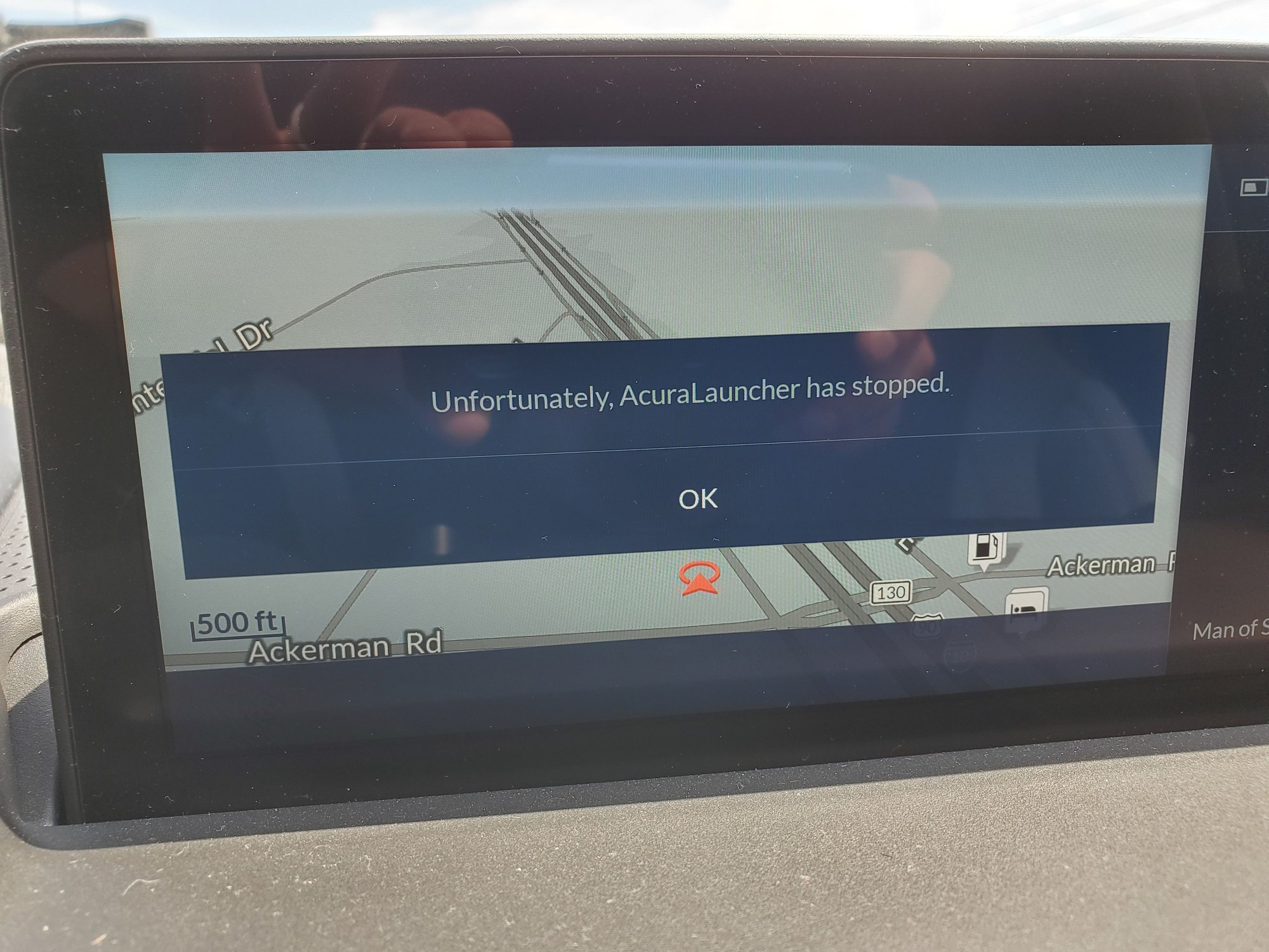

Error message
Anyone else get this message? Turned on my car and waited for everything to boot up before doing anything and this error came up. Had to do 3 finger reboot.
