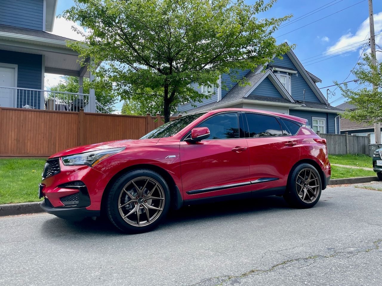

Are you planning to lower your RDX? That amount of additional poke will make the wheel gap look bigger and can make it appears like you're on stilts. I'm running 20x.9.5 with a +40 offset so I poke out another 8mm or so - at stock height it'd look pretty terrible. Lowered on Eibachs it looks fantastic - the wheels are pretty much flush and the car looks pretty muscular.

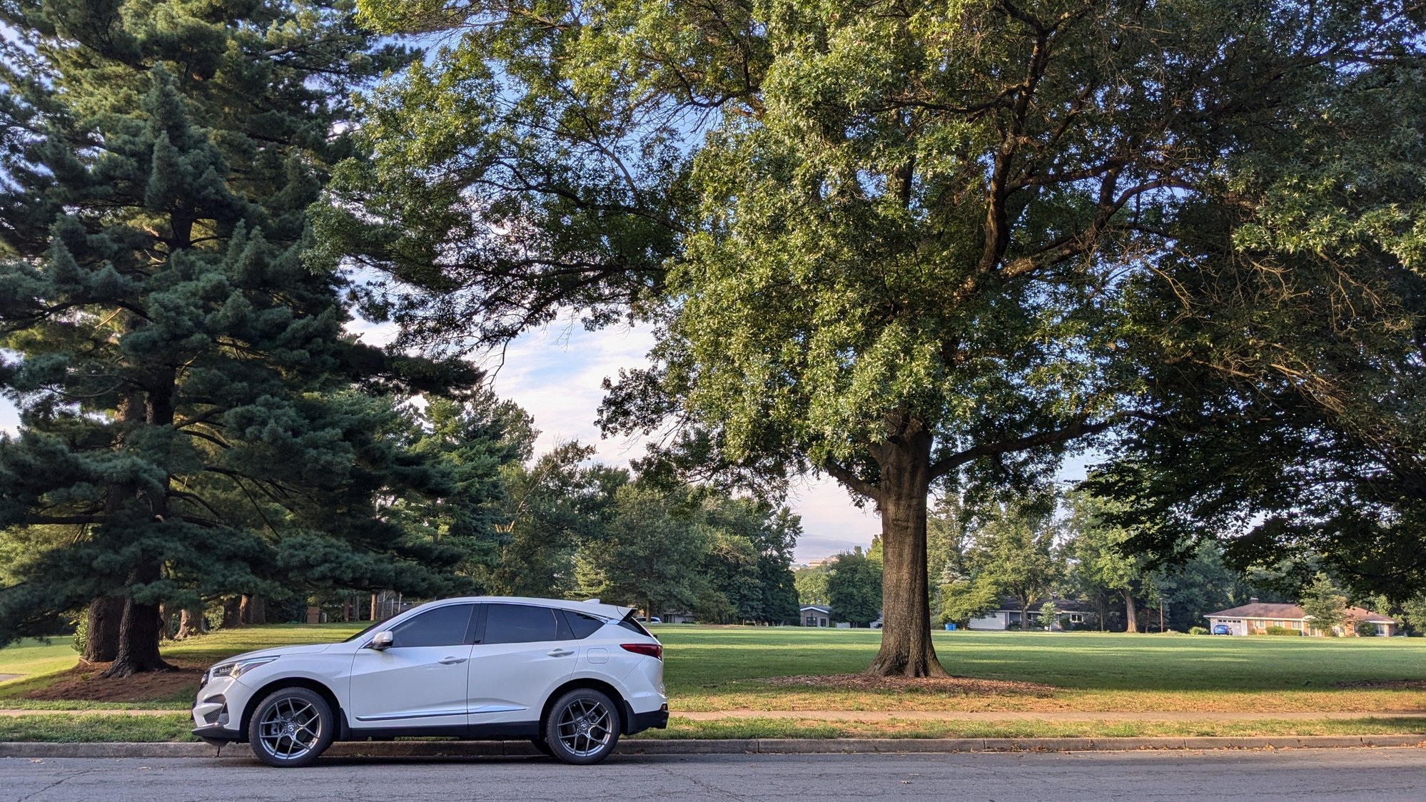

Mine are 20x9 +35 so those will have slightly less poke.
Looks good was thinking on lowering mine. how's the ride

Quite firm. I don't think it's that much firmer than stock but I thought stock was very firm already. The front springs could use more spring rate as I find the front can run out of suspension travel on stuff like speed bumps pretty easily. Head toss became a bit worse but it already wasn't very good to start with (sway bars are still stiff IMO).
I don't know of anyone who lowered it who thought the ride got appreciably worse than stock.
