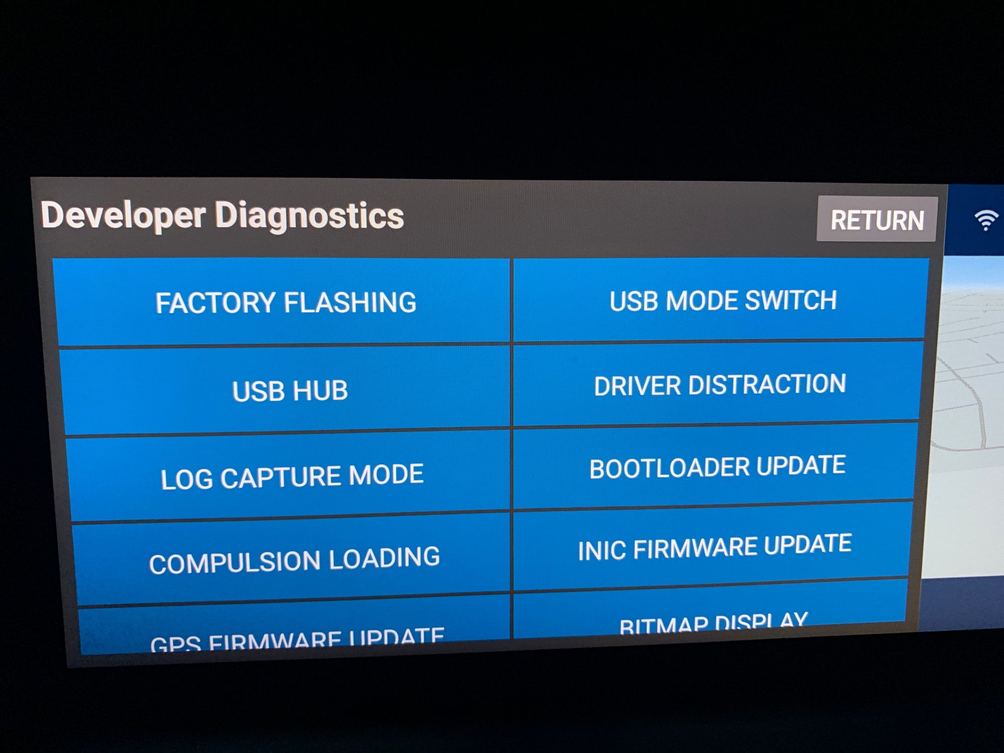

Found this little nugget in the Developer Diagnostic screen! I enabled it but I don’t have a USB Hub to try it out!

What was the default setting? Was it disabled before you enabled it?
Old Feb 21, 2020 | 03:59 PM
kboo74656's Avatar
Joined: Dec 2018
Posts: 701
Likes: 202
From: Hampton Roads Area, VA
It was initially disabled and I enabled it. Now all I need is a USB Hub to try it out.

you can go ahead and try it, I already have. It did not work for me. I even tried a USB switch which is not a hub and that didn’t work either. I enabled /disabled also.

Did you try it on the other usb outlets??
Old Feb 21, 2020 | 07:25 PM
Funz51's Avatar
Expanse me
Joined: Feb 2019
Posts: 902
Likes: 308
From: Virginia Beach, VA
did not bother, they are only power.
Old Feb 21, 2020 | 07:32 PM
kboo74656's Avatar
Joined: Dec 2018
Posts: 701
Likes: 202
Well it was worth the try. Maybe there is a software aspect that has to be “turned on” for it to work??? I’m no super tech geek just a slightly average geek!!!

that was my guess also. Look earlier in this thread and see all the tests we did. Go for it!
Old Feb 21, 2020 | 09:46 PM
NooYawkuh's Avatar
Skeptic
Joined: Jan 2019
Posts: 1,493
Likes: 428
From: NY Panhadle ©
Yeah, poke around those menus and you'll see provisions for a world of shit that's simply not implemented in the RDX. It appears they may have aspirations for lots of future expansion. Makes you wonder if there's wiring for data from those other USB ports to a hub in the head unit. All they might have to do is develop the driver software. There are already separate menus for Bluetooth and USB audio on the home screen.
