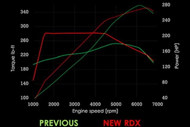

There really isn’t much point going beyond ~6500 RPM as Hp begins to drop, with a 10 speed the shifts are so small that you can keep it in the power band much easier, also all the torque for this car comes on at 1500rpms, maybe you could raise the rev limiter with a flash, but I think Acura tuned it this way to protect the engine/transmission, and power drop off is at this point anyways, as far as first gear, it gets the car moving, it’s not meant to rev to redline, the car is faster in second gear, first gear is crazy small

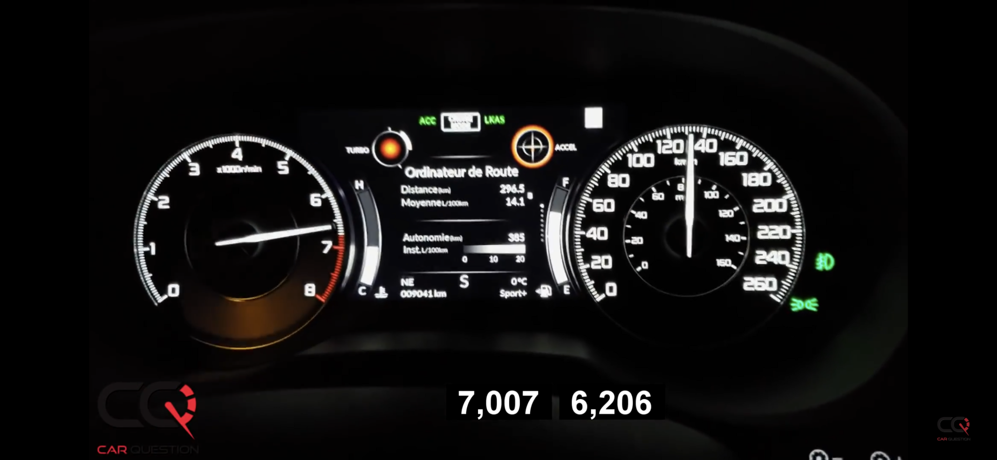

that’s in 4th gear from the video, roughly 6600-6700rpms in 4th gear
here is a nice 0-60mph test

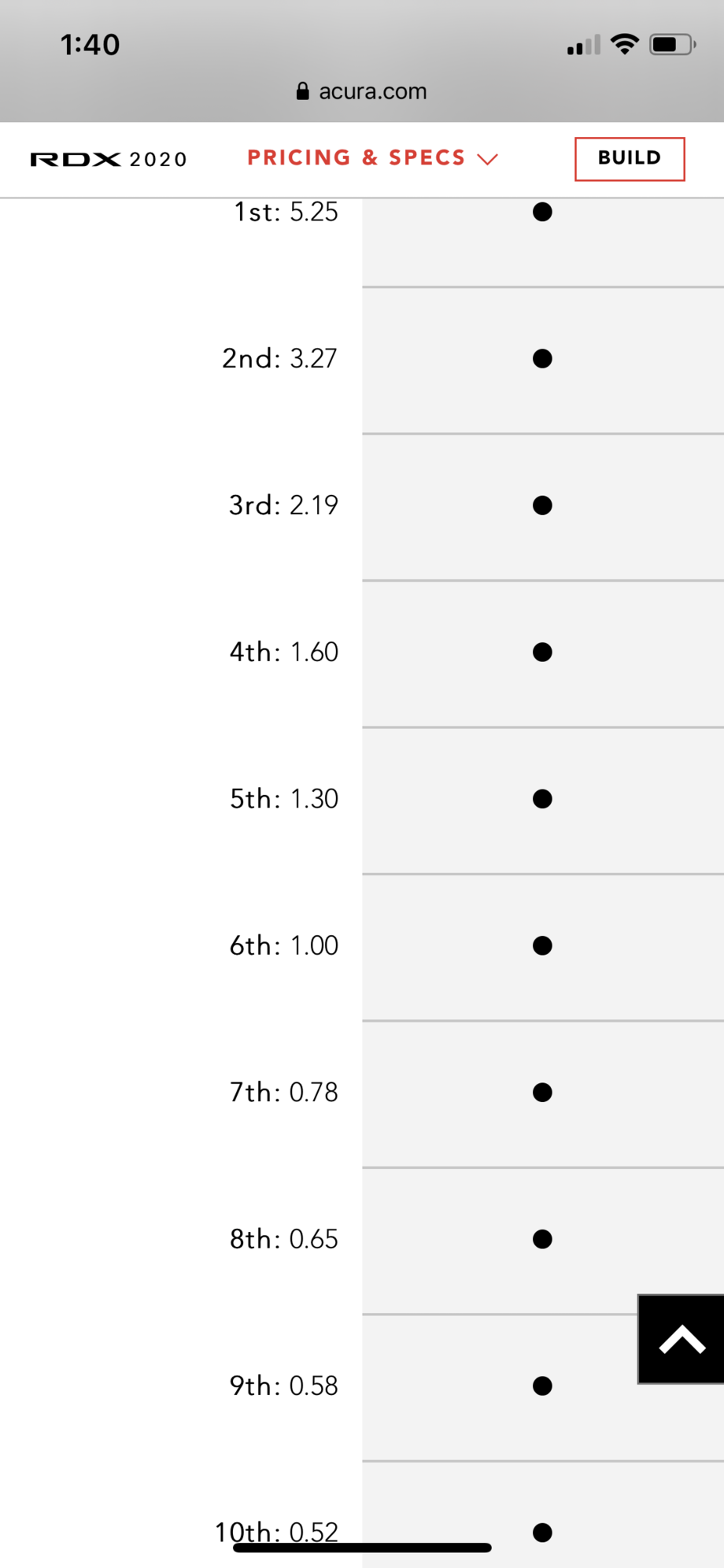

i think people forget, you can obviously always squeeze some more performance out of a car, but they have to balance the tune between reliability and performance, especially with these longer warranties acura gives them Honda, hell I have Acuracare for 120k miles and 8 years, they have to build a product that can handle performing regularly for that length of time, if you tuned for 100% performance, the car would drive like crap for daily driving, although it can be done with drive modes, and you would either cause failures earlier or raise the cost for having to over engineer things more then they already are. I love my RDX, and I think it performs great, I’m 27, but do realize, every time I’ve seen someone driving an Acura, 70% of the time it’s an older person in their 50s+, it’s a balance between luxury and performance, when I went to the dealer to buy mine I thought I was stopping at a nursing home, everyone buying Acura’s were older folks, I do see some younger people don’t get me wrong, but that’s what I’ve seen at my dealer, and yes I wanna be hip, cool and I style when I get older, and still want performance.
to add to my post before, 1st gear delivers max amount of torque but at the sacrifice of fuel economy, so as far as accelerations it’s great, but for fuel economy it needs to get out of that gear as fast as possible, that’s why when driving normal it shifts out of it very fast, when flooring it, it goes to redline
