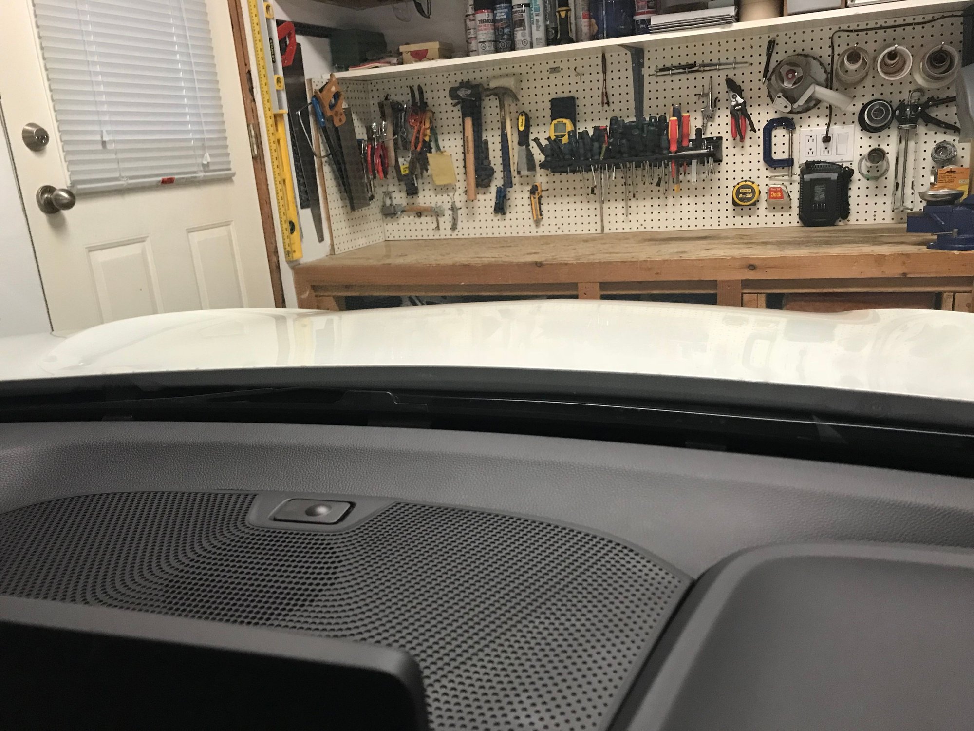

With flash we see the foam
In real we do not see it
Nice DIY fix! Thanks for sharing with the group!!
