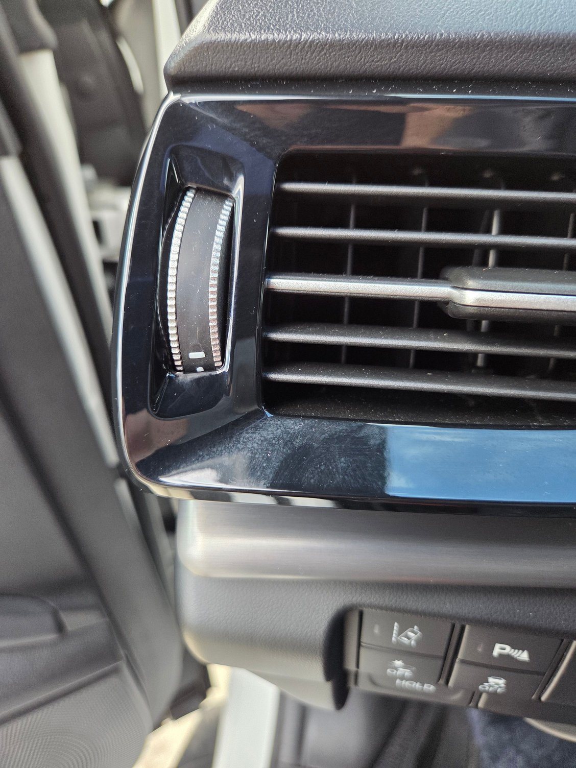

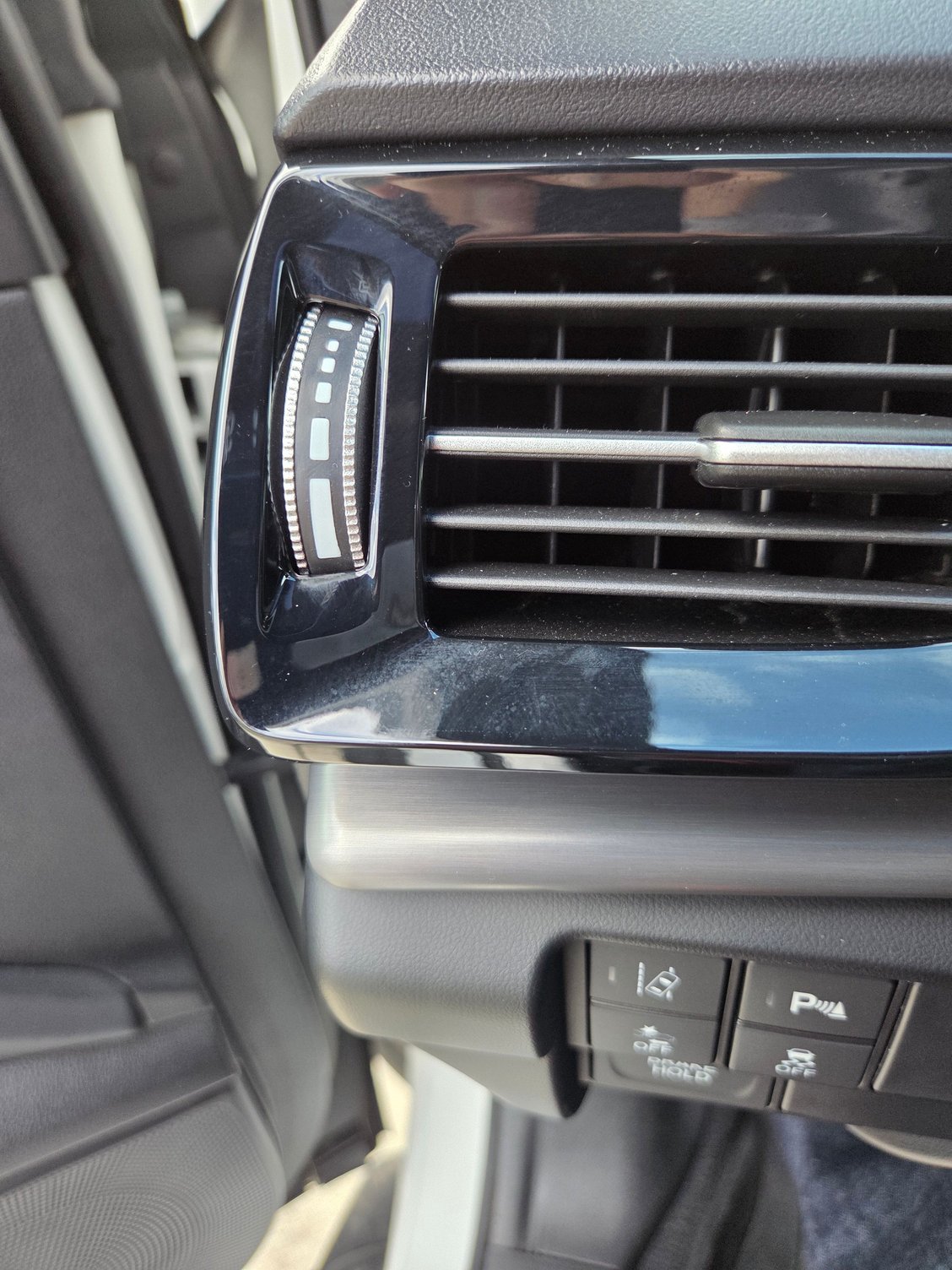

Which direction opens the air vent, do I turn the vent wheel to where the white dotted lines are visible or do I turn it the other way where the white dotted lines are not visible? See attached pictures.

Think of things this way and making reference to your second image. The small round symbol represents minimal air flow, the large rectangle at the opposite end of the dial represents maximum air flow. That being said, if your system is set to auto, and the desired temp is say 72 deg F, and the vehicle internal temp is 73 deg F, not much air will come out of the various air vents. If you like air blowing in your face (like my wife does) you will have to go to a manual mode that allows you to select fan speed.

I have to select fan speed just to get air from the outside to come thru the vent? I am not talking about turning the AC on. I usually don't like to have the air circulate so I like to have fresh air from the outside come thru the vents. On my TSX, I never have this issue. I just turn off the air circulation icon and I get air from the outside coming thru the vents, but on my RDX, when I turn off the air circulation, there is no air coming from the outside thru the vents at all.
