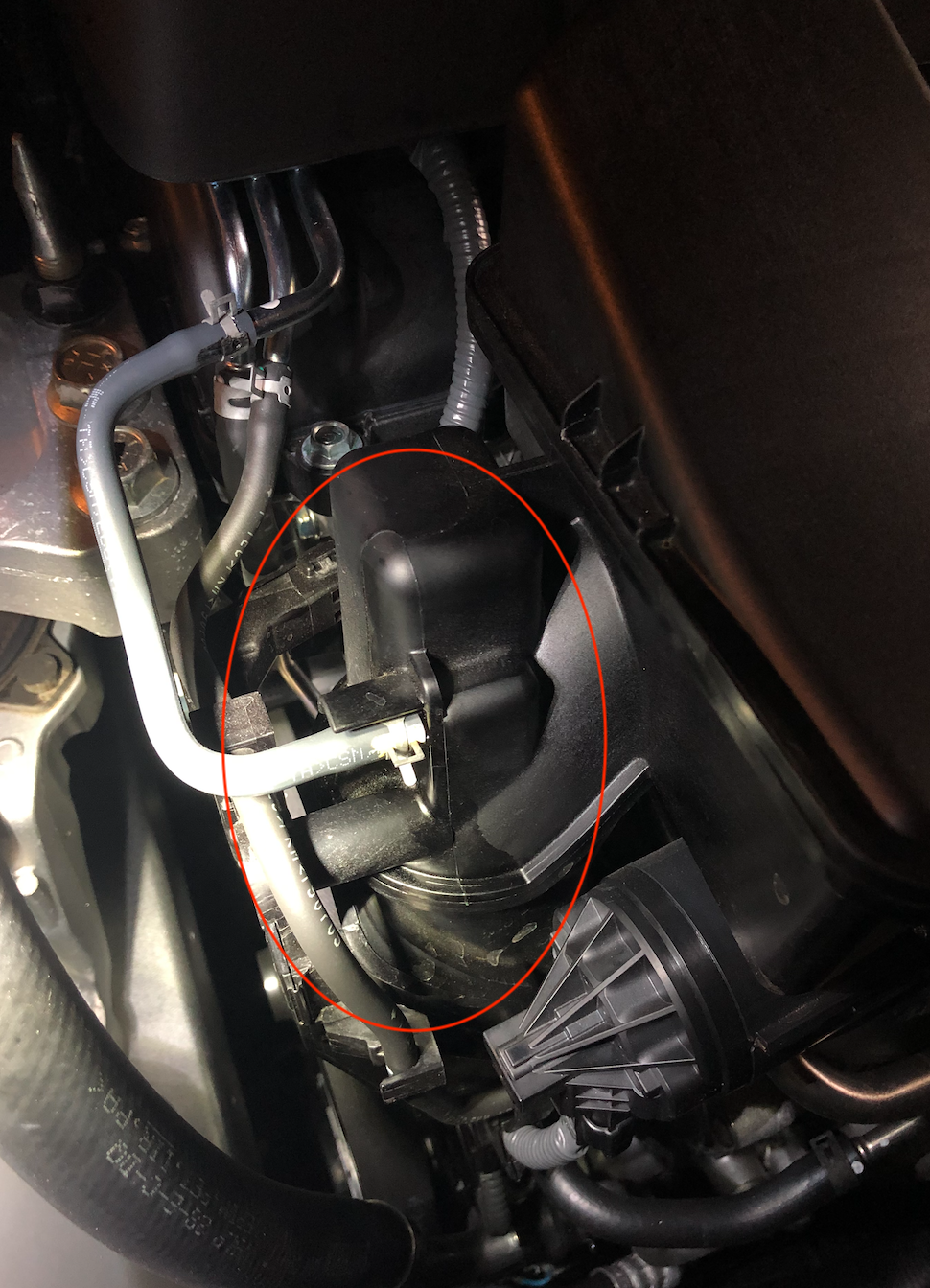

Hey all,
Looks like this is a coolant leak? Can anyone confirm this tube is for coolant? Color of the leak appears to have greenish/yellow haze and is very sticky even though it is all dry. Attaching some pics.. Thanks

That's not a coolant line. I'm assuming it's part of the PCV system. No coolant or liquid is going to run thru there. Are you having an issue with oil dilution? Mine is completely dry.
For the future, our coolant is a dark blue, not green/yellow.

Yea after thinking about it a bit more after posting I didn't think it was coolant either. Ive always been able to smell a scent of gas in the oil but I don't know how diluted it actually is? Why do you ask about oil dilution, how would the two relate? Thanks!!

How's the oil level? If it's part of the PCV system, overfilled oil in the crankcase due to oil dilution could create more of a likelihood for oil to enter the PCV system ... and causing it to seep out at that port. Try removing that hose and seeing if the inside of the hose is coated with oil. If so, there's the issue. Mine is bone dry upon removal. Really just speculating, but makes sense to me ...

A hose that doesn't carry fluid appears to be leaking fluid that looks like coolant, but it's not the color of coolant used in this car? Nothing leaking from the engine, that I know, should be 1985 Prestone green. Nothing makes sense here.
Has anyone done work inside the engine area? Maybe a wet funnel or something similar rested on that hose which dripped down to that cover, simulating a localized leak? If it's me, I clean that area and watch it closely for fresh signs of an actual leak.

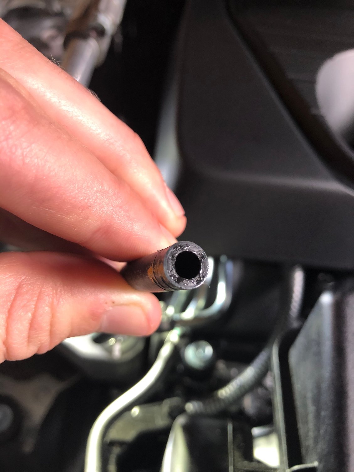

So...I pulled the rubber tube this morning. I found that there was definitely a small amount of residue on the outside edge of the rubber tubing but the inside was dry. I took a toothpick and gently ran it through the plastic male connector (pointing to with red arrow in attached photo) and there was definitely a small amount of some type of liquid in there. I cleaned the area thoroughly and will take it for a good long drive today.
If that is part of the PCV system, I think some oily vapor residue inside the tubing could be normal. But the greenish color is a head scratcher. Whether or not that's an active leak is the next logical test...
