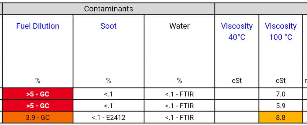

Well, take a look at my last oil report with 5% fuel dilution and viscosity down to 6.6 https://acurazine.com/forums/3g-rdx-.../#post16863656
Still want to use 0w-20??

Have you done UOA on this car? My viscosity has dropped by 2cSt, running one grade oil higher lets me keep oil within 0w-20 spec. The 5w-30 thins out so much that it looks like Xw-20.

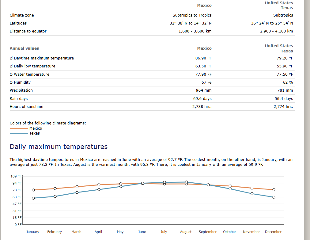

https://www.worlddata.info/climate-c...co&r2=us-texas
Looks very similar to me. How is your viscosity looking in UOA for this engine, or you just listening to what Jason says and trust Honda engineering?
You said
there is no climate difference between Mexico and Texas/Florida
is not "very similar". If you're gonna hyperboi, stick with it but don't backpedal.

2. I dont claim to be an expert, but I do send my oil to lab to measure fuel dilution and its impact on viscosity.
We are still waiting on your UOA and viscosity numbers for THIS engine, and not generalization about all thin oils. FYI: Jason is sponsored by Mobil1, and even he could not name a single side effect (other than worse MPG) from using thicker oil

For those that want to have serious conversation, here is my multiple UOA. First two had 0w-20, which started out with 8.8cSt new, but ended up 6.6-6.8
The lab found high fuel dilution.
the 3rd sample had 5w-30, which started at 10.0, but finished at 7.7 which is in range of 0w-20.
I drive 70% highway, and found others having similar experiences with this engine.

Old Sep 4, 2025 | 07:40 PM
  #114
Optical Toxin's Avatar
Joined: Mar 2016
Posts: 101
Likes: 46
From: DMV
Btw, 20 viscosity range for 100C is 6.9-9.6cSt.
if you are under 6.9, its a problem
Originally Posted by Optical Toxin
^ I'm hoping to contribute to the data related to viscosity and fuel dilution.
I have had 2 samples done by OilAnalyzers using the oil changed by the dealer each time, which is 0w20. Both times before getting my oil changed, I smelled the dipstick and it smelled like fuel. Oil Analyzers confirmed the same ">5 - GC" on both of those reports. I changed my own oil in the spring and used 5w30, which I'll have analyzed when it's time to change out.
Following up with data.
Top two oil samples were dealer oil. Unknown miles on top, about 5500 miles on the middle row of oil. Dealer said it was 0w20.
Third sample I had switched to 5w30 when I did my own oil change. Just over 5000 miles. It's the bottom row in my screenshot. Oil dilution is lower and viscosity is great, right where 0w20 starts at 8.8 according to RussianDude.
Seems like a positive trend. I'm going to keep doing 5w30 every 5k miles.

Looks nice, 8.8 cST is within the range of Xw-20.
