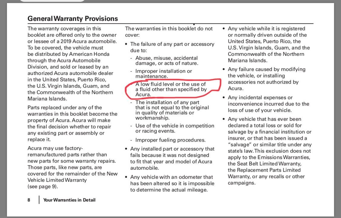

Sure you live somewhere that the car experiences 110f but the engine experiences 212-240+ oil temps. I think honestly running the weight oil is not smart, and the engine is not designed to handle the thicker oil you are running, and ambient temp or not, your engine gets much hotter then the ambient temp, so that is not a huge factor. This will cause bearings to be starved and other parts that require a super thin oil when the engine is cold to be starved of lubrication. Also the engine is most likely designed with very tight tolerances to be used with 0W-20 that the thicker oil can not properly work itself in between.
The warranty specify it recommended 0W-20 and does say using fluids specified could void the warranty, id say your in a grey area, but really your call, I don’t think it’s smart, if anything run 5W-20 or maybe 5W-30. I think you went very extreme and will end up in the long run wearing your engine out much quicker.
Think of it this way, what’s the difference of your engine internal temp being 220F let’s say and the external temp being 115F, vs where I live where the engine would also be 220F with an external temp of let’s say 50F, nothing because the engines both get up to ~220F and maintain that temp using the coolant to do so. So in reality your probably just risking starving bearings in the turbo/engine and causing high amounts of wear when you start the engine up every time
