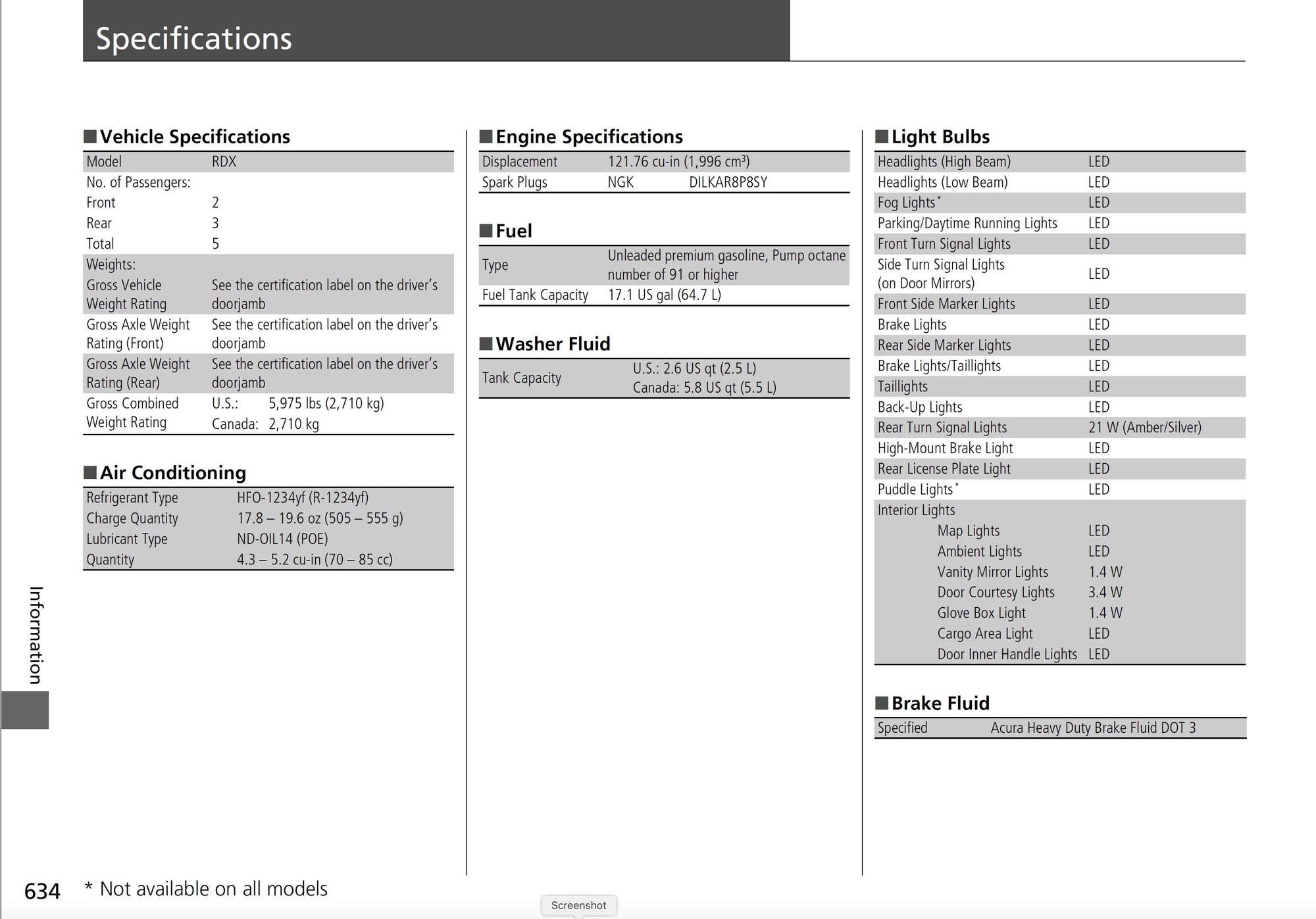

Originally Posted by EXCALIBUR1
Wrong answer. Pencils down. Every interior light and even the rear turn signal lights on the 2019 Acura RDX are incandescent. They can all be retrofitted to LED and will be brighter.
Are you suggesting that the fine manual is wrong? But if it makes you happy, tear apart your dome lights and check it out.
Old Jul 16, 2020 | 05:31 AM
EXCALIBUR1's Avatar
Joined: Sep 2018
Posts: 320
Likes: 140
From: USA
Point of clarification Mr. President: By interior lights, I was referring to Vanity Lights 1.4 W, Door Courtesy Lights 3.4 W, Glove Box Light 1.4 W,. Exterior, Rear Turn Signal Lights 21 W (Amber/Silver). I have changed all these lights in my 2019 RDX Tech to LED. Apologies.
