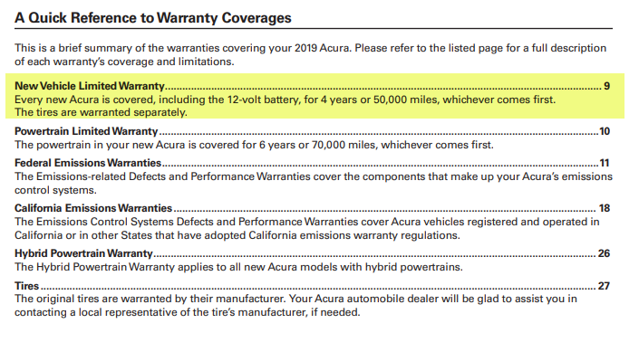

Originally Posted by anoop
Interesting. Is the battery considered a warranty item? Is it covered by the 4 yr/50k miles warranty?
yes sir!
see page 6 warranty booklet
