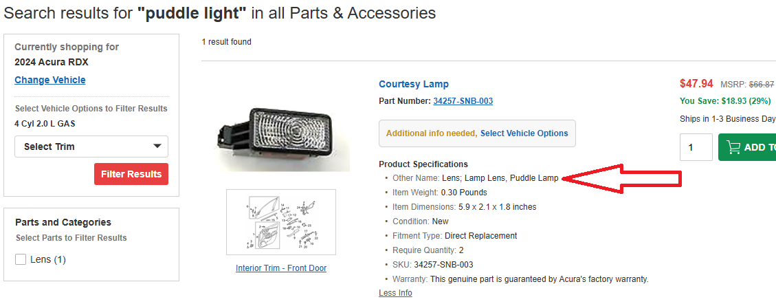

Is #3 the puddle lamp you guys are referring to?

No, the ones on the bottom of the side view mirrors next to the camera….

Originally Posted by retiree
Would anyone have the part numbers for the 2020 RDX Premium Elite mirrors puddle light assemblies and the form fit and function LED replacements versions of the Pilot Elite? Thanks a million.
#8; Right & left side part numbers:
Here is an example of what the OEM Honda pilot one looks like.
Part numbers are no where the same as the OEM Acura P#'s, nor the price.

forgive my ignorance on this, I don't even know where the puddle laugh is supposed to illuminate. I've only had my 25 Advance for a couple of days....
drove once at night and didn't see anything out of the ordinary light up
According to the diagram in post #9 I supplied above, the puddle lights are on the bottom of the Front door-Outside mirrors?
