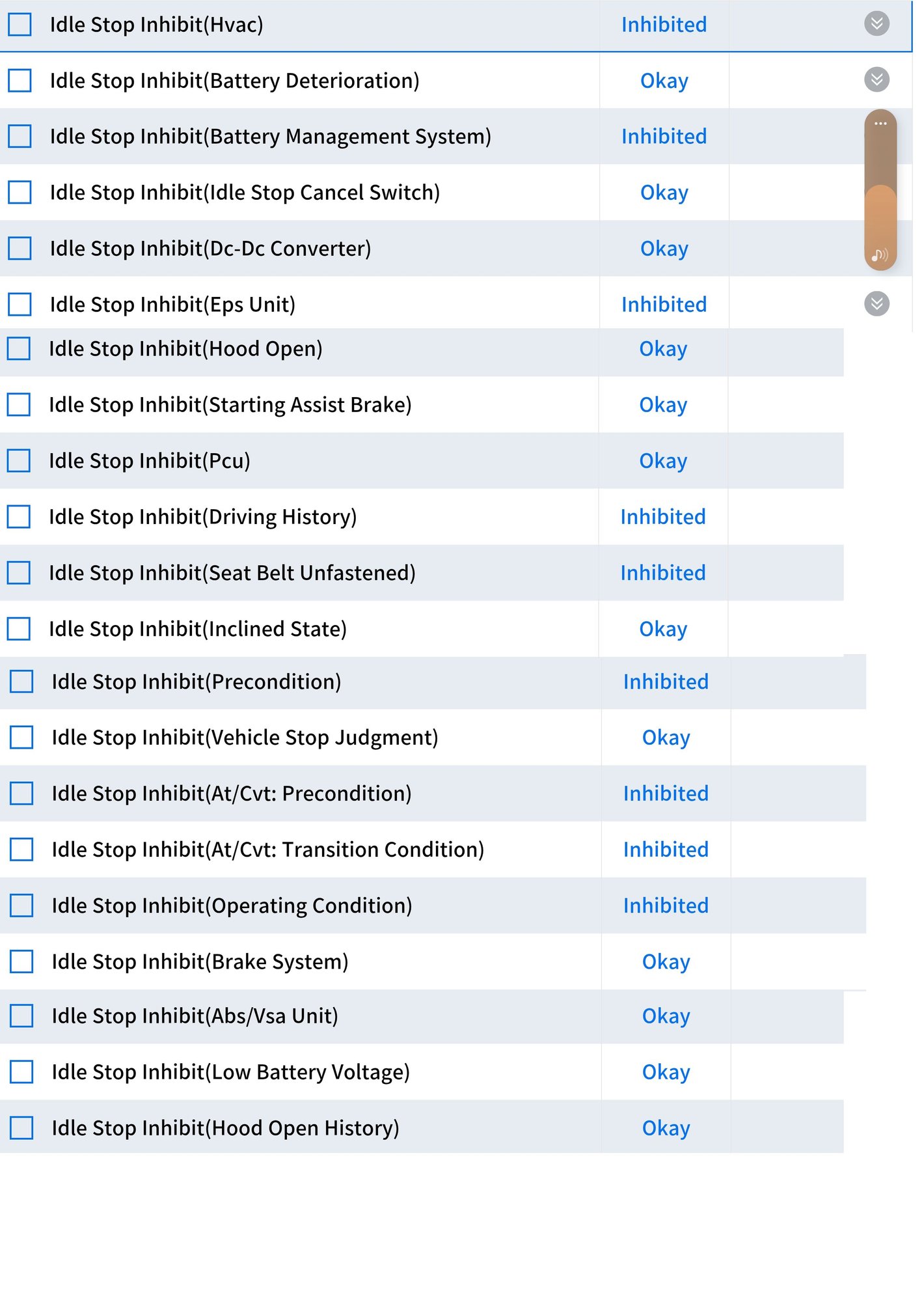

There are actually a few other things that can inhibit AIS from activating. For example, the brake pedal needs to be depressed firmly, the HVAC can't be in min or max modes, the steering wheel can't be moving, the hood must be closed, etc.
The following is a list of items for my own RDX (as shown on my XTool OBDII scanner). Please note that not everyone of these items may exist on my RDX. What is actually available depends on options and country of use. I would have to click on each item to confirm if it is available, but hopefully you can see that battery condition may not be the only reason your AIS isn't working.
Your dealer should be able to diagnose your problem in a few minutes.
Edit: My car was parked, with the engine not running, and I was not wearing my seatbelt, at the time these screenshots were taken. That is why so many items were shown to be inhibiting my AIS

^ Thanks. I guess they didn’t find anything wrong with any of the diagnostics specifically related to AIS. For now I’m just driving it as is. Let’s see what happens in the next week or so.

​​​​​​Most mechanics will scan a car for trouble codes, when looking for a problem. These trouble codes occur when something abnormal is detected in the cars computer systems. For example, the air/fuel ratio is out of normal range, or the crankshaft sensor is not providing a signal. Your dealer probably scanned for trouble codes, and found that none existed, and then sent you on your way.
The screenshot from my earlier post shows the various inputs that determine when AIS is enabled to operate. They include things like seatbelt buckled, HVAC set to maximum, or steering wheel being moved. If the HVAC is set to maximum, that's not abnormal, and therefore will not create a trouble code, but it will create an inhibit message for AIS operation.. The same applies to most of the items in the screenshot, no matter what their value, they aren't considered a problem, and won't be displayed when performing a scan for trouble codes.
There are literally several hundred signals available in a car, which feed about 20 different computers in our RDX (triple that in the fancy cars). I feel it's safe to say that most mechanics aren't aware of a lot of the so called "Live Data" that is available, and will simply perform code scans. I only discovered those AIS parameters while searching for some non-related data in the engine computer.

An interesting thing has started happening the last couple of days and today. AIS kicks in at the very first time that I come to a complete stop after I start the car. Thereafter, it never kicks in for the rest of the drive. Not sure what to make of it. Let's see if it changes within the next 2 weeks or so. Otherwise, I plan to contact both Acura (have a case open already) and the dealer.
Yeah, that doesn't sound right at all. AIS never activated on our car until the engine was up to or darn close to normal operating temperature. I have a feeling you're going to be contacting Acura again.

Since the last couple of days or so, it appears AIS has started working as expected. So it looks like the service advisor was correct and the system does go through some learning before it starts kicking in regularly.
Initially, it never kicked it (about 2-3 weeks).
Then, it started kicking in only the very first time that I came to a full stop (about 1-2 weeks).
Now, it's started kicking in at most stops as expected.
If something changes and it seems to not be working right, I'll come back and update this thread.

Originally Posted by daRthDX
I'm going to back up to here... Have been following your saga with AIS and was hoping that you would have the success with what John from PA calls the "AIS relearn" procedure that I have had! I do a variation of it that has not failed me yet. Have had to do it several times with my RDX, whenever I've noticed over a couple week span that the AIS has stopped working. If what I write doesn't work for you, maybe it will work for somebody else.
For those who don't want to hunt back in old threads, the gist is that one of the many conditions for AIS to work is that the system thinks "all is secure". But due to a suspected software glitch there can be times where the system thinks the hood is open (so obviously all is not secure), could have been opened during servicing or whatever but it did not get the message the hood was closed. I see in the great list that RDX-Rick posted that hood open is a condition of AIS not working. Also seatbelt unfastened is in that list. In my procedure I've incorporated fastening the seatbelt, due to instinct? but now that I see it in the list maybe I'm on to something.
Here's what I did the last time it worked, which was TODAY! Needed to top up the washer fluid and thought I'd kill two birds with one stone and do The Procedure again:
- Hood open, engine off (like you would if you were topping off washer fluid!)
- Get in the vehicle, close driver's door, fasten your seatbelt
- Start the vehicle
- Oops, hood is open. You'll see the warning message on the dash
- Keep the vehicle running! Get out and close the hood
- Get back in, close driver's door, fasten your seatbelt again
- Shut off the vehicle
- Get out
- Lock the vehicle
Now everything should be in a state where the AIS will work at the earliest opportunity of conditions being met. Sometimes when I do this it works immediately. Today it didn't so I turned AIS messages on and instead of the dreaded "System charging" message it had the much easier to deal with "Adjust climate control" (or something to that effect). So I turned the temperature down a degree so the fan wasn't working as hard, and that did it. (Later as the car warmed up turned the temperature back up and the AIS was still working.)
If this works, you're welcome!
This worked for my TLX thank you! It usually doesn't work but it worked the same day right after I followed your steps
