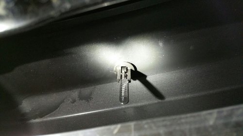

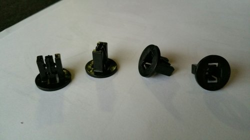

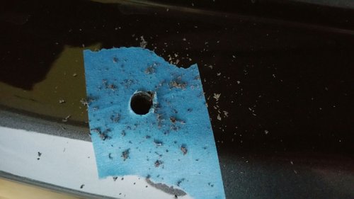

So I went ahead and installed the rear bumper protector. I was on the fence about drilling holes versus using automative double-sized tape--ended up with drilling the holes. Here are some pics for anyone who might be considering the same.
I used painters tape to attach the template. Also put a piece of painters tape on the bumper beneath the template where the holes would be made. The picture also shows the spare tire (only for AWD models of if you installed the spare tire kit) lowered to provide access to underneath the bumper for the clips.
These are the clips for underneath the bumper. Basically works like a zip tie to secure the bumper protector.
There are 4 of these on the bumper protector--these will go through the holes that you drill in the bumper. You can see the ridges on each strap--works like a zip tie.
I didn't have any metric drill bits (instructions ask for 10mm for the final size), so I used a 3/8 drill bit. I didn't start with a smaller bit and gradually move up to the final size. Since you use a push-pin to mark the hole, I just used a 3/8 brad bit. Very weird feeling putting a drill bit to the car.
Be sure to remove the burrs from both the top and the bottom (under the bumper).
Here a pic from underneath the bumper of the clips attached the the straps. Making sure the burrs are removed from the hole will help to get this clip on securely.

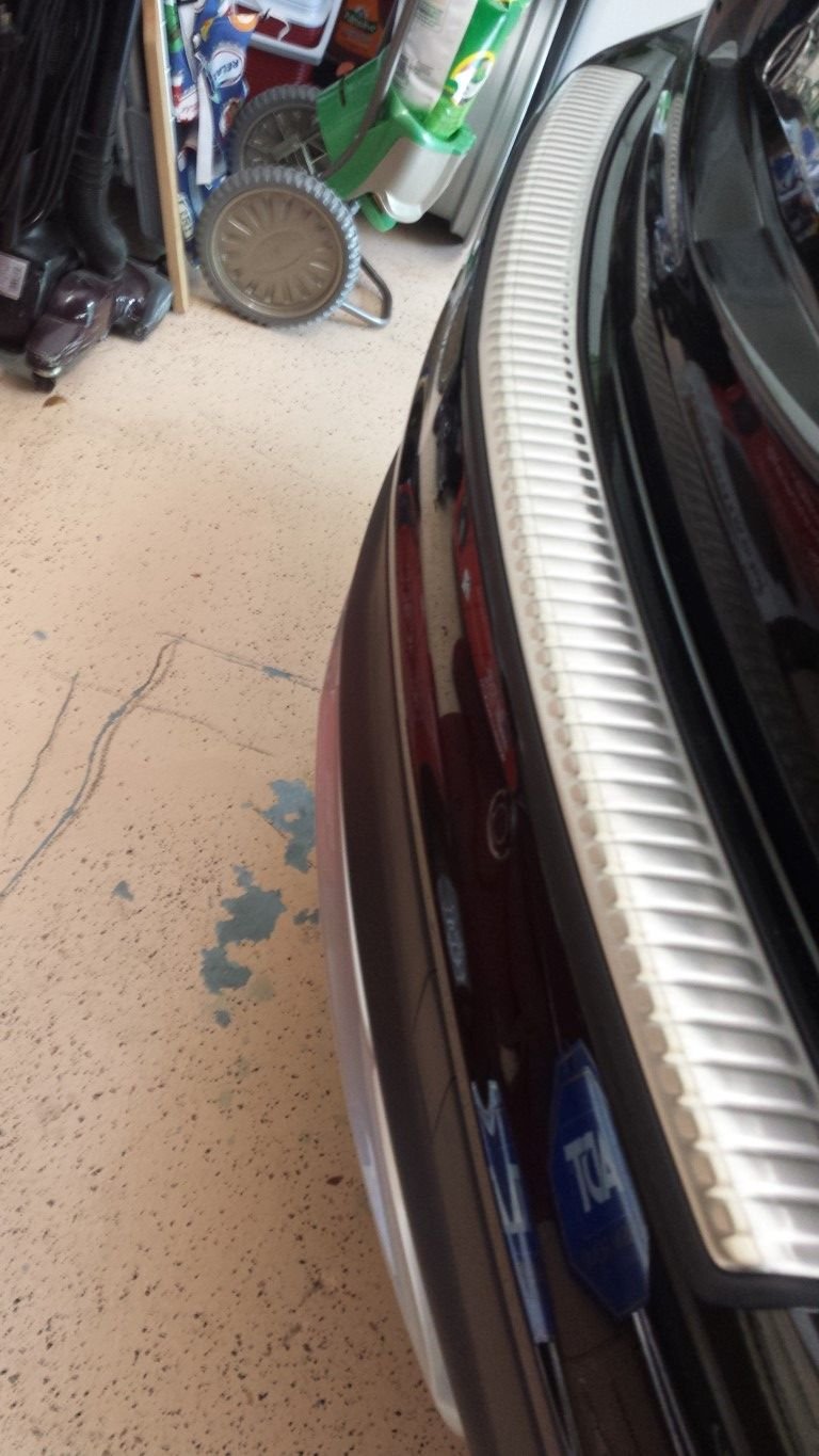

Here's a pic of mine with the Tape. I've had it on for 10 months and absolutely 0 issues. I just couldn't get myself to drill holes in the bumper.
