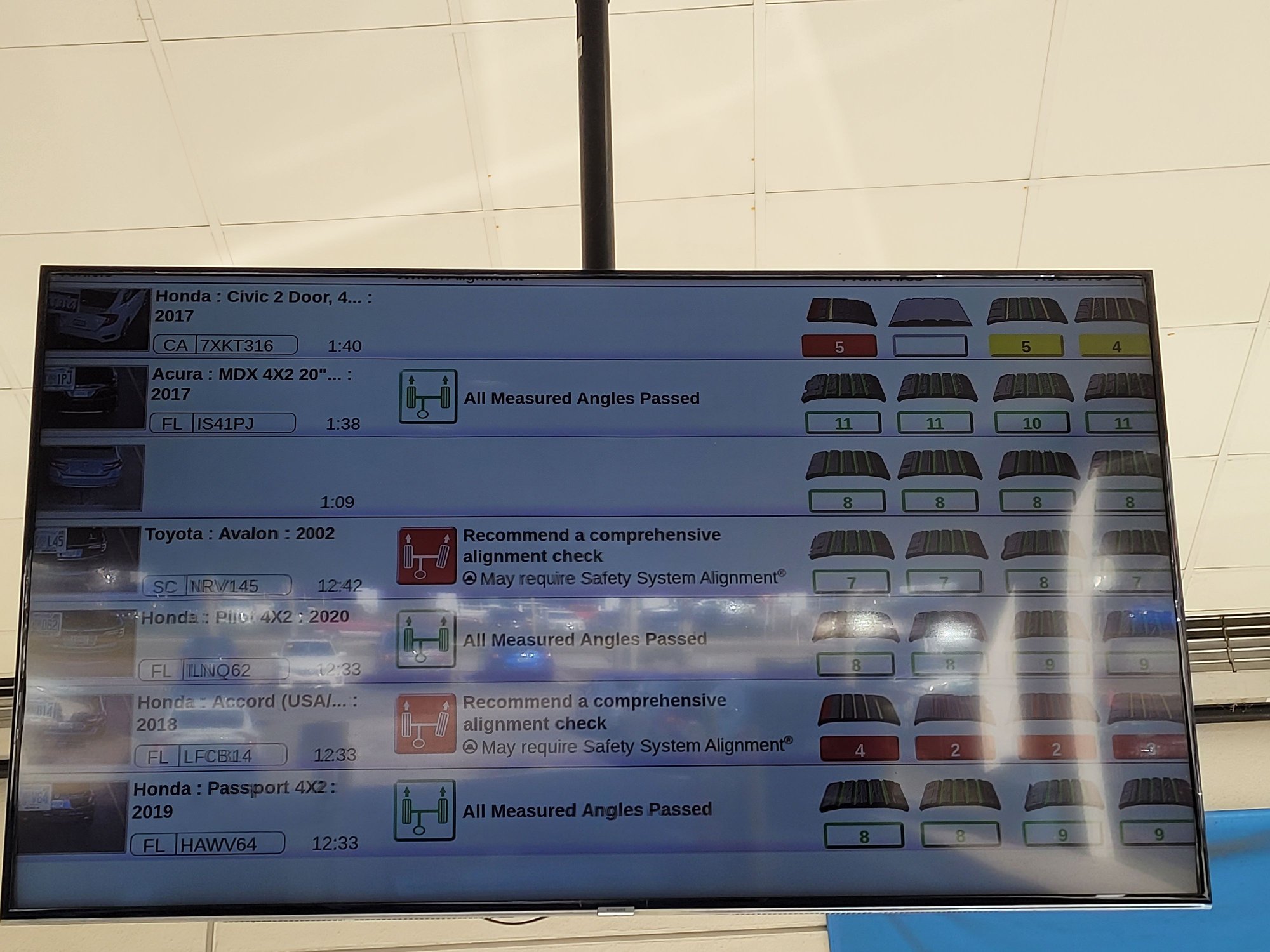

Just checked in with the tire guy, and PapiFlyy (if you guys know him or heard of him) just got the alignment rack delivered to the shop and they are getting it finished installing (in two to three weeks).

I just came back home from Honda and got the alignment report as well. Report says my alignment is perfect on all sides.

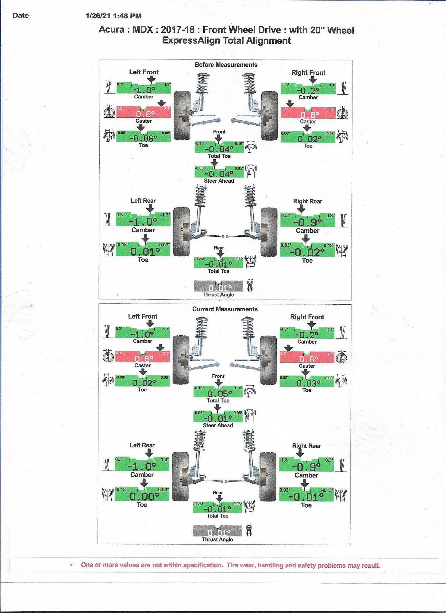

Here is the detailed alignment sheet. I had to go to a Pep Boys. Its still shimmying like a MF and I literally have to argue with Fountain Acura to fix this damn thing.
I am 100% sure that its the bearing that Fountain Acura replaced that is causing this issue. I contacted a drivetrain shop and they are booked till end of next month.

This new SA that I had to use at Honda since my go to SA was sick (maybe dude got rona?). First thing this dude said my Alignment FAILED. And then forced me to do an Alignment job AGAIN.
I told him I need a detailed copy of the alignment, and when I saw it, the rear is out of limits. Its showing the right rear tire that Discount Tire noted as being bumpy. The camber is at -1.4 degrees (out of specification range) and the rear cross camber is at 0.8 degrees, also out of specification range, according to the Hunter alignment system.
