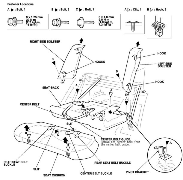

Are they clips or bolts securing the front of the bench on a 2010 TSX?
Old Jun 7, 2014 | 07:39 PM
leo200617's Avatar
Joined: Jun 2012
Posts: 49
Likes: 13
http://d3nevzfk7ii3be.cloudfront.net...AupHeqdB.large
Its two hooks at the front and a slit at the back. You've got to pull two latches to release the hooks
