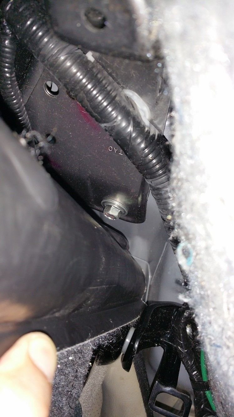

Should I use any of these bolts for the ground wire?
Should I use this seat bolt for the ground wire?
Should I use this bolt for the ground wire? It's behind some of the carpet lining behind the rear seat.
I tried grounding the amp to this bolt here, but the amp is still going nuts when I start up the car. Any suggestions for a grounding point in this picture?

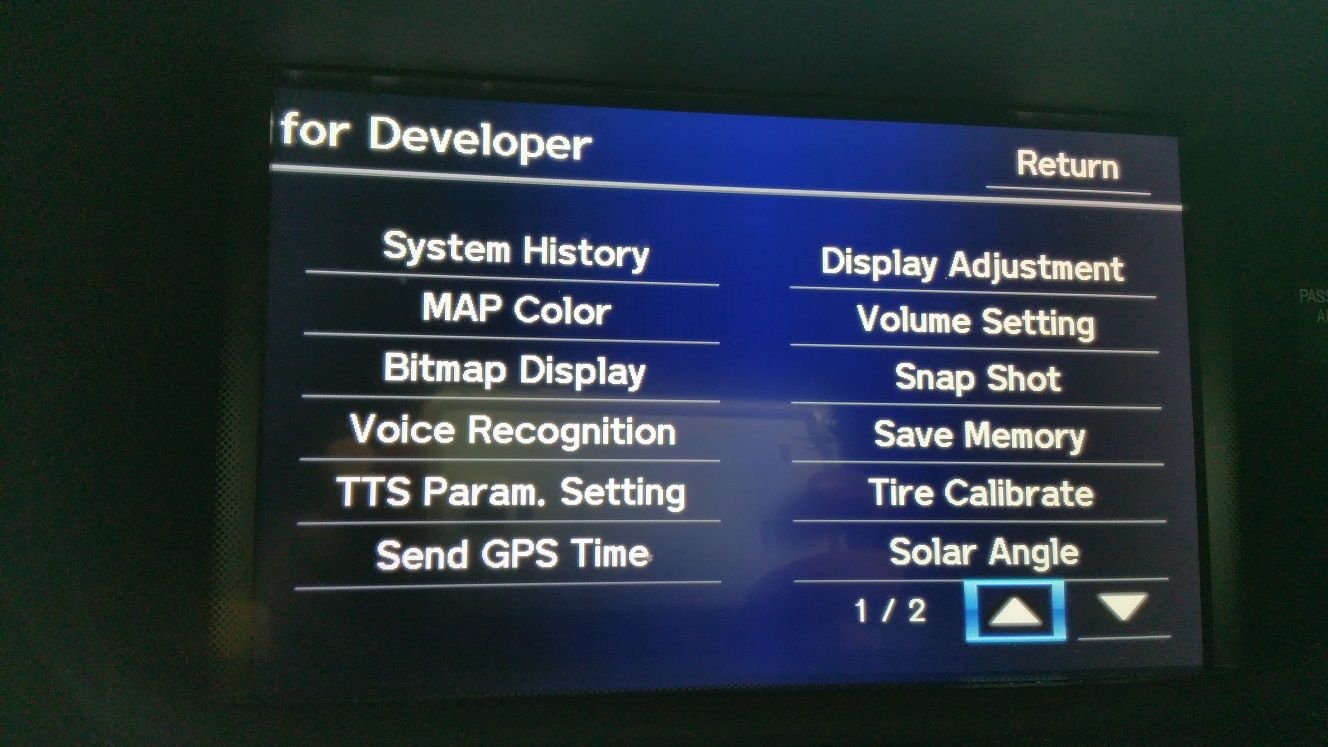

I looked for a way to disable ANC, but I couldn't find the option through the stock head unit... Page 1...
...Page 2

Lastly, your best ground is on the floor, the extra bracing by the seat is added later and is not electricity part of the chassis. I don't have access to my install photos but I did post the pics of my ground connection years ago.
