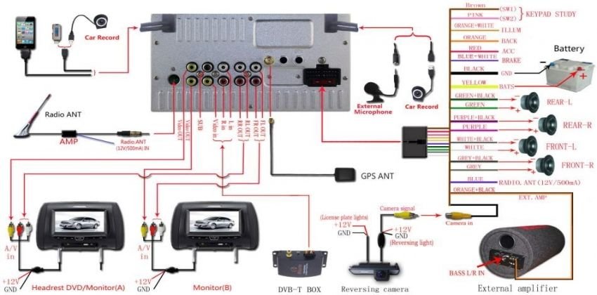

Joying Android back outputs

I'm in the same shoe. Euro Accord Premium Sound System with 6changer. The main problem that the amplifier need digital control from the headunit. (Fader, balance, levels etc.) You cannot wire it correctly with aftermarket headunit which not prepared for it. I found only barand headunit for the Australian market which can control the factory amp, but cost around 1500USD, and the import would be also impossible. So I decided to replace completely the factory amplifier.
The joying harness is containing only amplified speaker level outputs, I guess you're driving the amplifier with this (3-20V) instead of line level (0-2V theoretically, but there are some toleration in the car amplifiers, they usually accept level 0-6V). When you raise the volume the amplifier gets too high voltage for input and that causes the humming sound. There are devices available which can convert speaker level to line level, but the line level already exist in the RCA outs on your headunit, you should wire it to the amplifier. It requires some electronic skills, and you still won't be able to adjust the Center/Subwoofer level separately.
Sorry but the factory amp is not ok. It's actually garbage and should be replaced so that fancy Android HU can do what it's supposed to. It's like putting Pinto wheels on a Porche.

Factory amplifier is easy to find. If someone need it i can show the right place with some photo's. I have allready removed it. MNow i have a JBL GTO5355 5 ch amp and wanna install it.
It is true, confirmed by my local Honda garage/dealer. Original factory amp is only working with original head unit. Because it receives at least 2 data signals to process sound then send the sound (cross over) to all speakers and subwoofer. There is no way to get it work with an Aftermarket radio unit.
It is an actually piece of shit that original amp. Very small and 4ohm at 2 ch. Unbeliavable how it works with 10 speakers... And i still think my original head unit has a good quality sound... At least it was good enough for me.
From what I understand, the OEM HU does all the processing and EQ'ing on those unlike the base where it is the opposite. It's all or nothing on those so it looks like you have gone all in!! What about speakers? Are you replacing those or staying factory?
