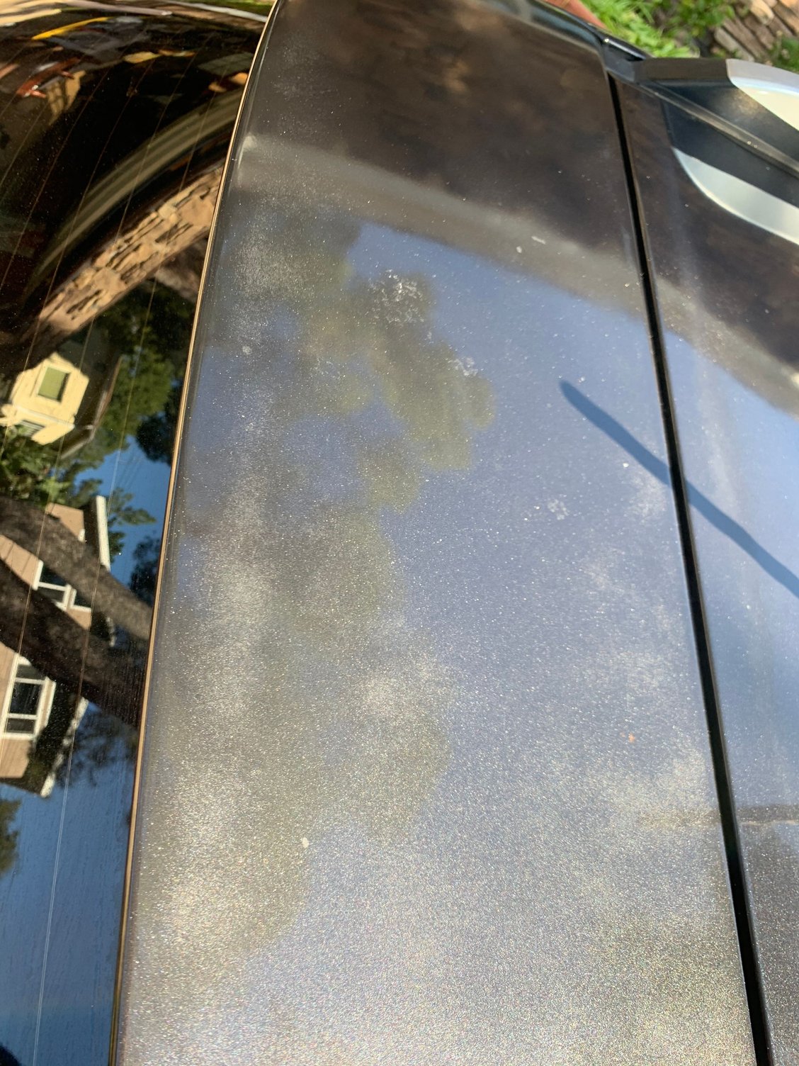

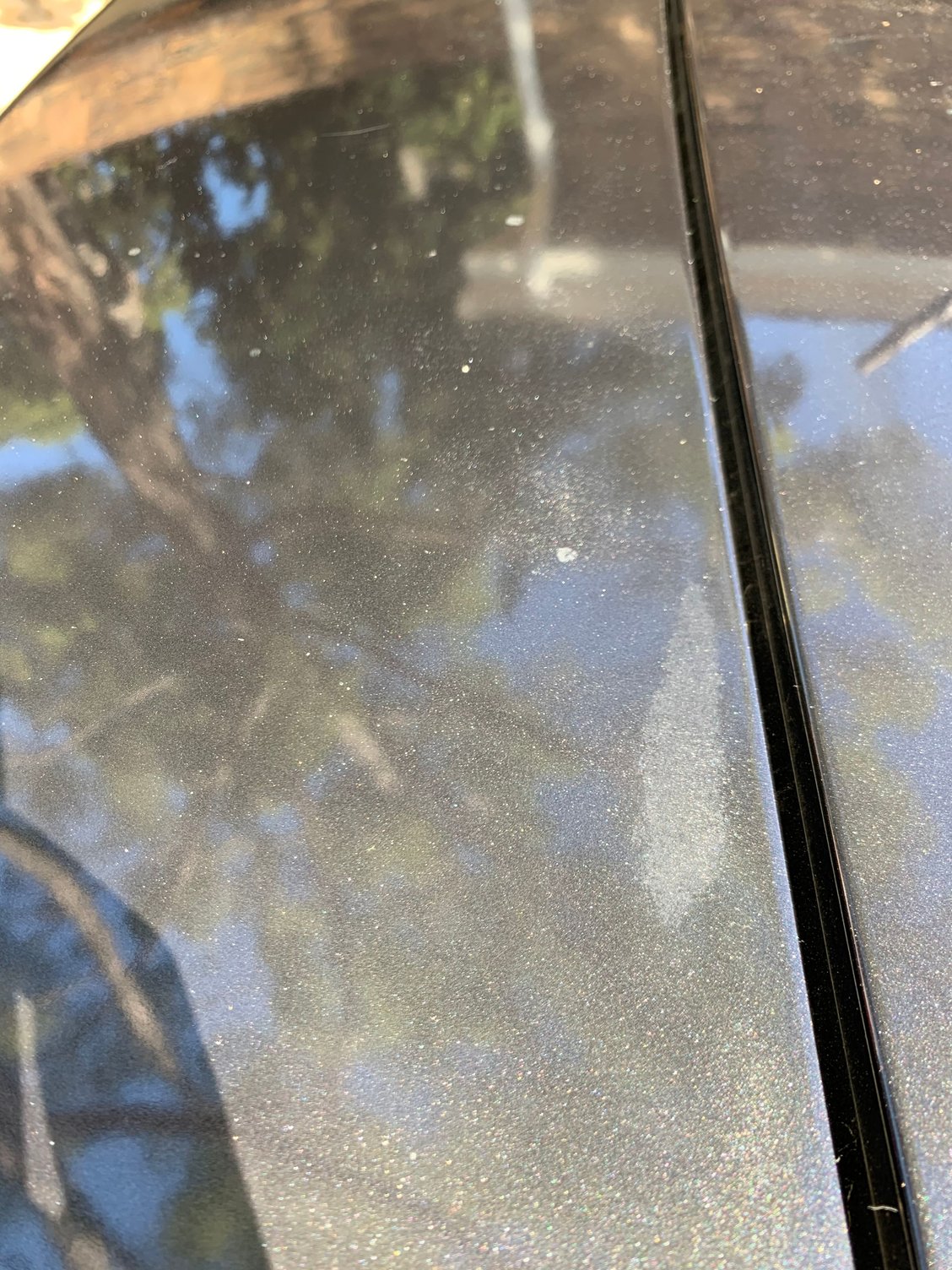

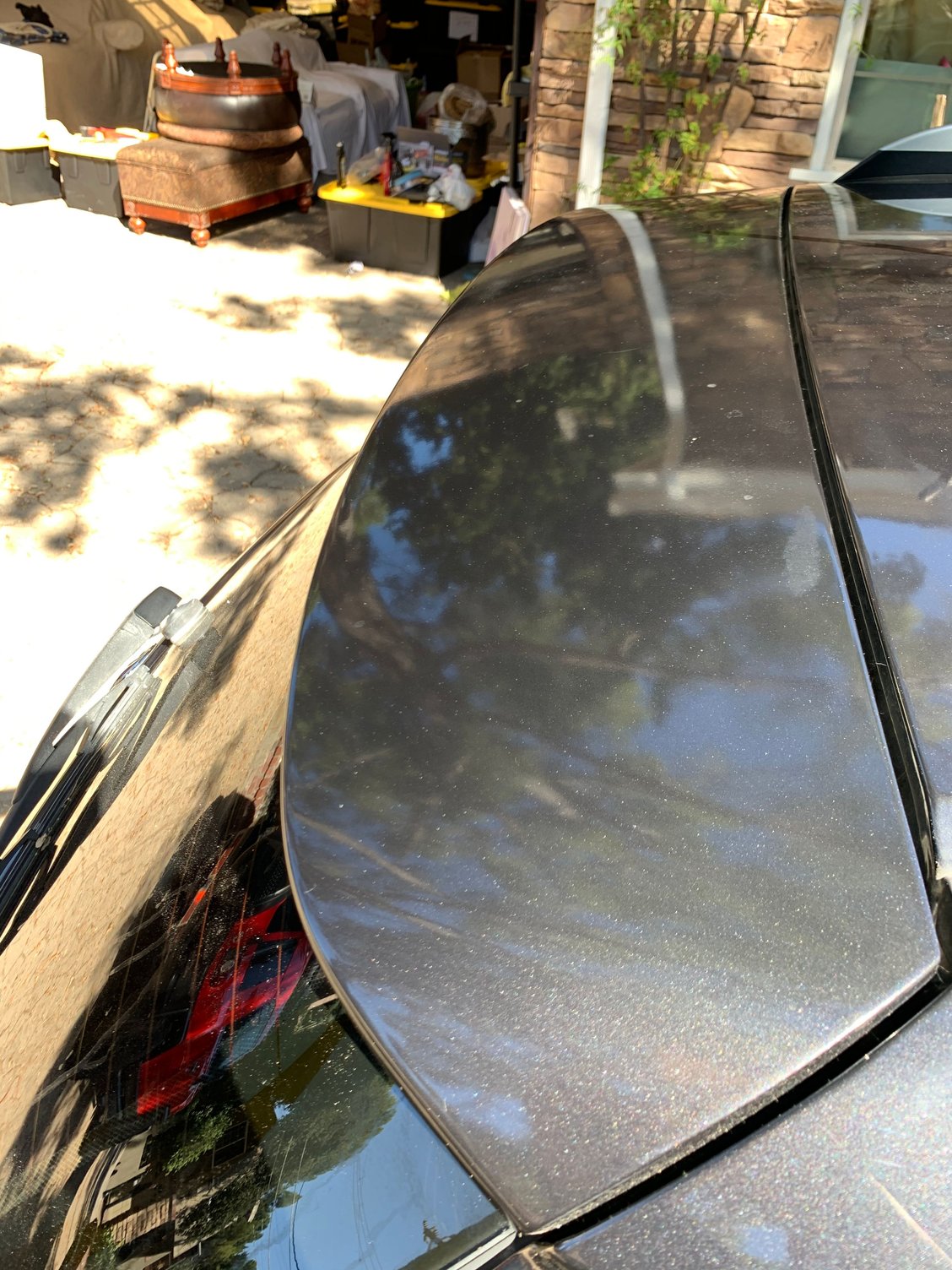

Typical of hondas after years, I have some start of oxidation on spoiler
I didnt catch it in time.
1) would wrapping or painting be the way to go?
2) how difficult is the part to take off?

a few corrections; it's only typical because of the sun. the sun's harmful UV rays ate through the clear coat...you cant catch it "in time"....it has to be protected from the sun at all times to prevent it...by keeping the car out of the sun and having a wax/sealant/ceramic coating on it.
wrapping would be putting a bandaid over it and calling it good.
to do the repair correctly, it needs to be sanded down and then resprayed with a clear coat.

Mine did the same thing and I fixed it with rubbing compound, polish and wax and using a DA polisher

You should nave been using Meguiar 20 or 21 from the day you bought the vehicle. Minimum twice a year with these products. There are other good brands you can find here > https://www.autogeek.net/
It is too late to use the twice a year method in your case. The sun has already damaged the clear. Best to have it re cleared by a reputable shop. Start here https://owners.acura.com/collision/
