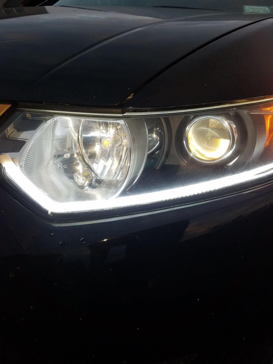

LED Lights

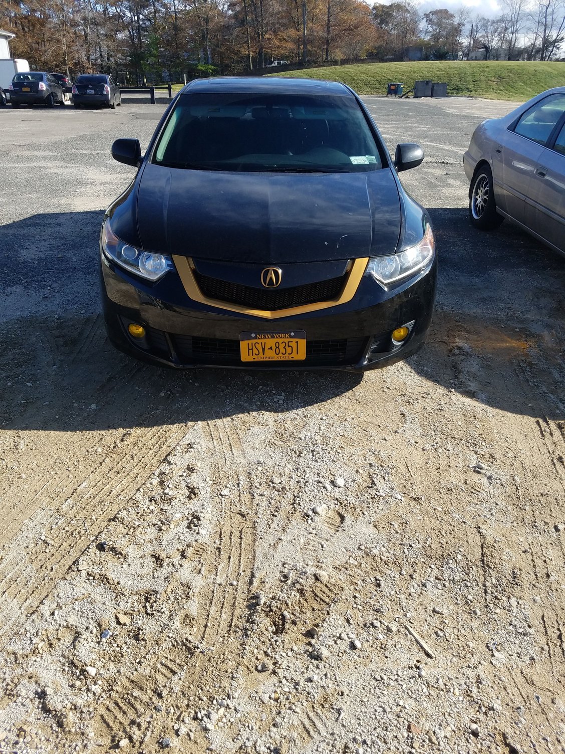

Car is so dirty😐
Was bored so I picked up some led strips and went to town today.. they look okay hard to get a night pic tho.

Are those mounted inside or outside the headlight? It's really hard to tell.

They are mounted inside.

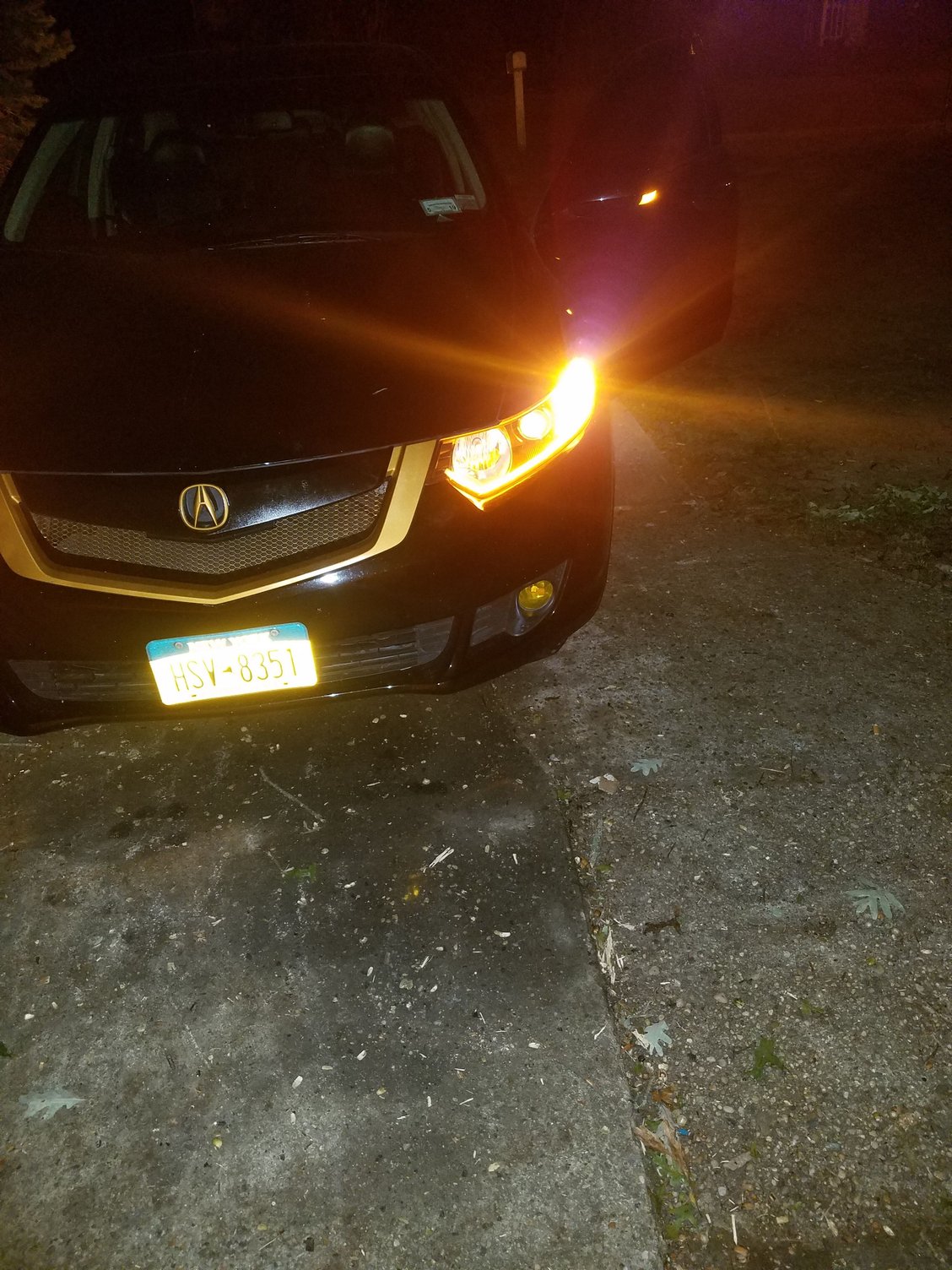

more pictures please. some with them off in the daytime maybe

My bad forgot about this post. I'll take more pics tomorrow.. I used I zip tie(Cuz i lost the brackets ) and double sided gorilla tape

The question is though... why did you bake your headlights to put this LED strip in, but didn't take out the amber reflector???

I thought about it cuz I absolutely baked them 2 different times. But I actually like the amber turn signals😏

All together the cost is less then 50$, lights were like 30$, tape was like 6$ that's really all you need. You'll have to bake the headlights and open them, and cut a notch in the bezel for the strips to fit. I drilled a hole where the strips bends and put a zip tie cuz the tape wont hold on that bend. I have them wired to my park lights. I've had no issues with the tape still holding strong.
