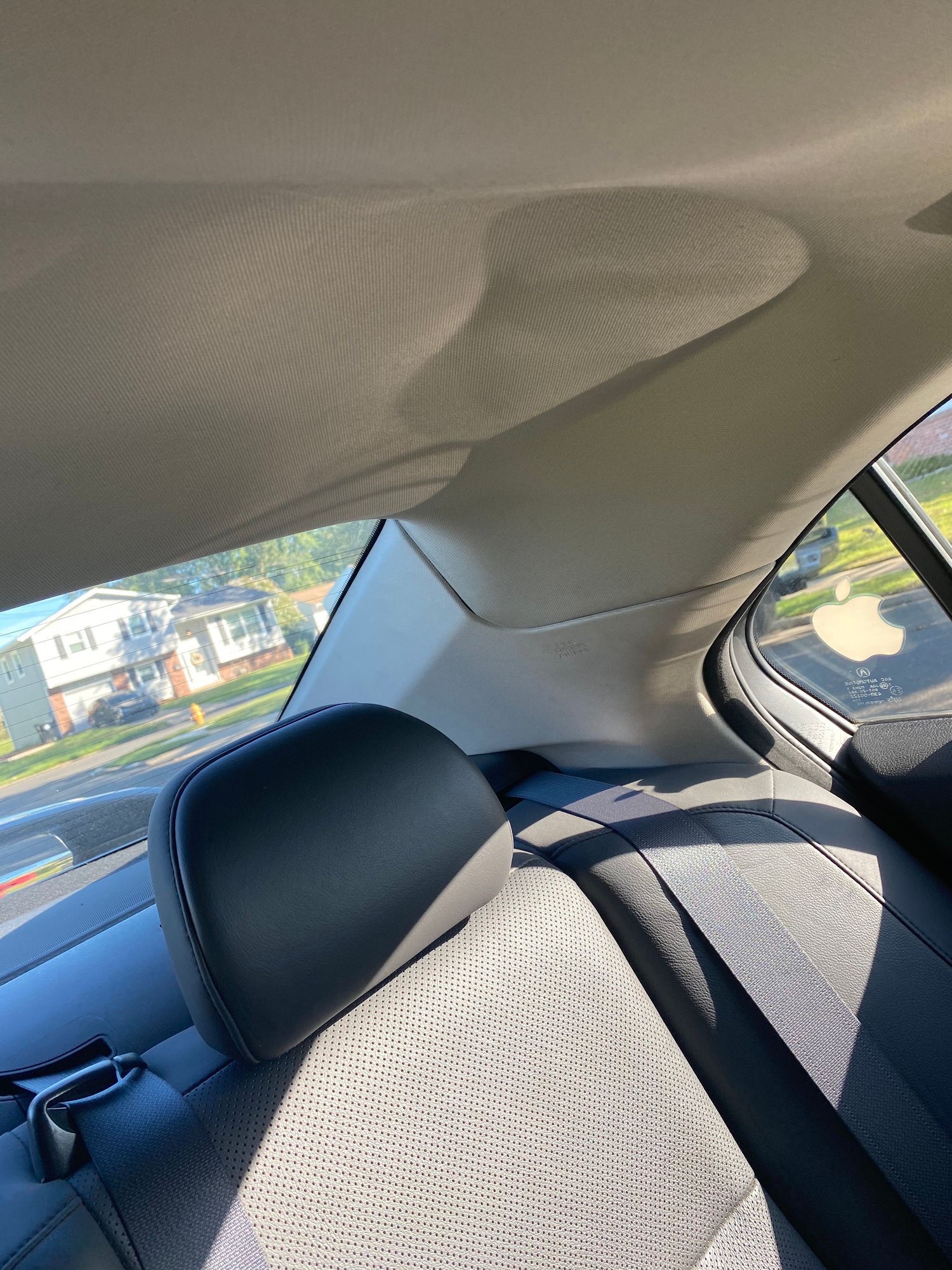

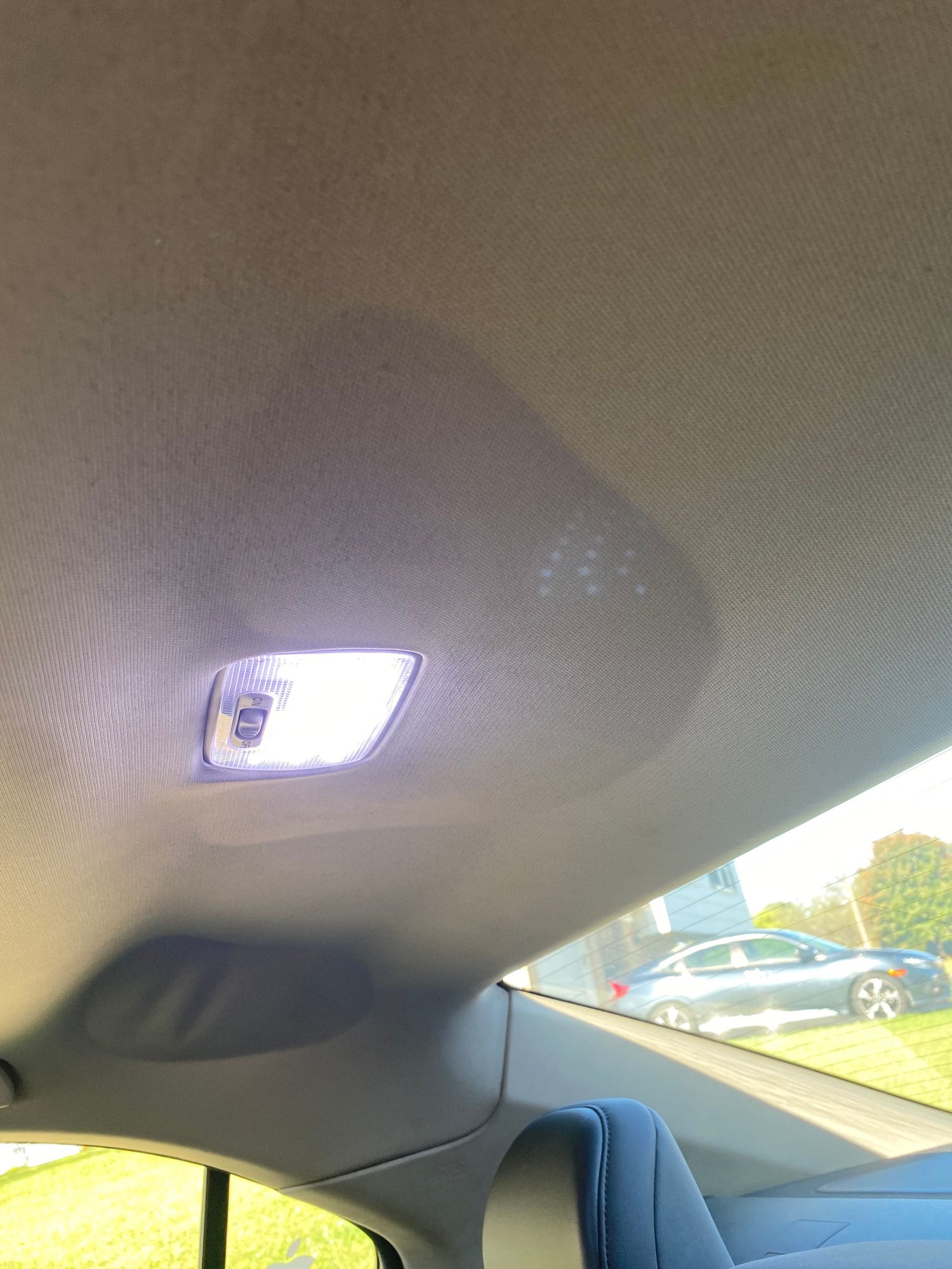

Pretty disappointed, I owned a 93 accord for 19 years and 0 issues with the headliner, I have a 2006 for freestyle with 0 headliner issues, but my 2010 TSX ...

Same happened with my 2011. Looks exactly like your first picture. For now, it's not a big deal, but if it ends up obstructing the rear window, I will have to have it fixed. Pretty sure I've read online that someone said they had it done at a local shop for $200-300, but of course, YMMV.
As a temp fix, I was thinking couldn't you just slice a straight line, spray some glue inside and push it back so it's flush? It probably won't look like new, but as a short term solution it might suffice?

It might work for a little bit, but will probably start to fail again. I think the root of the problem is that there's a thin layer of foam between the fabric liner and whatever is on the backside. When it starts to fail, it crumbles, so when you spray the glue back up in there, it's trying to adhere to something that's continuously failing. So once it crumbles a little more it'll sag again.
But I guess if you're at that point, what do you have to lose?

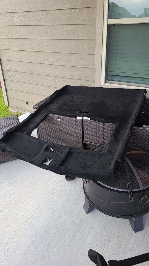

I'm about to redo mine in suede.
I posted a picture of my buddies DIY Suede headliner from his 2001 Lexus IS300.
he said it really wasnt that hard.
he went from an all tan interior to mostly black now.
which i'm about to do as well. my headliner is tan. and I want to refinish in black
taking out the front seat isnt very hard.. I took his passenger seat out.
also helped him swap a 1JZ into his IS300

Did he just apply the suede directly to the headliner backing board or did he put a layer of foam?
I'd think that the suede might be thick enough and/or have enough texture that the foam isn't necessary. Both for contouring and for sound deadening.

so the toyotas/lexus'(lexi?) have a carpet material. he just stretched the suede right over the carpet material.
it would be harder for us honda folks, as we would need to remove the foam layer and possibly add another layer of foam

I like the black headliner, but for some reason the suede drives me crazy because of how it changes color if you swipe your hand on it.
Guess I would just be happy with a black cloth headliner.
