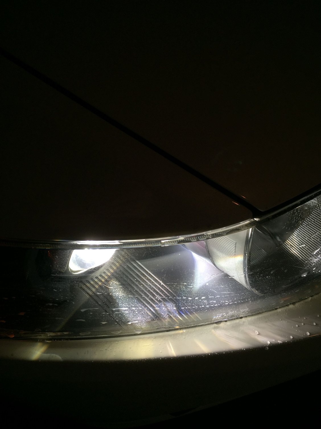

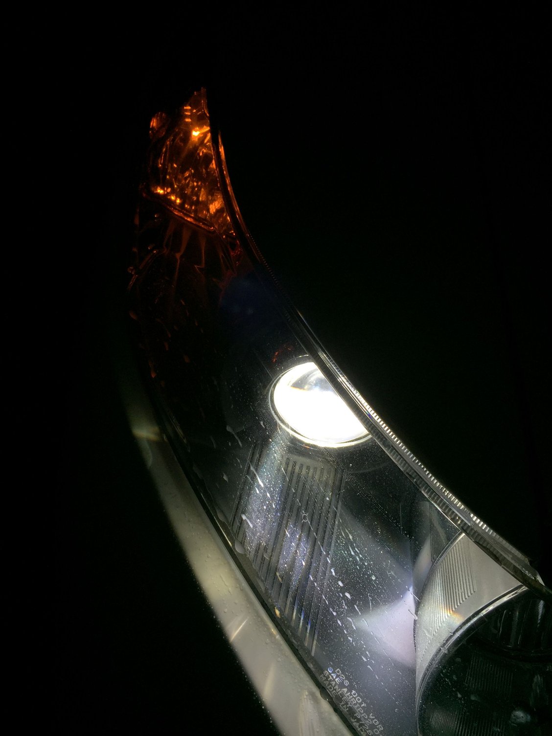

Here are photos ladies and gents,
No I havent had any accidents. The haze on the headlights are producing small amount of glare. Any clue?

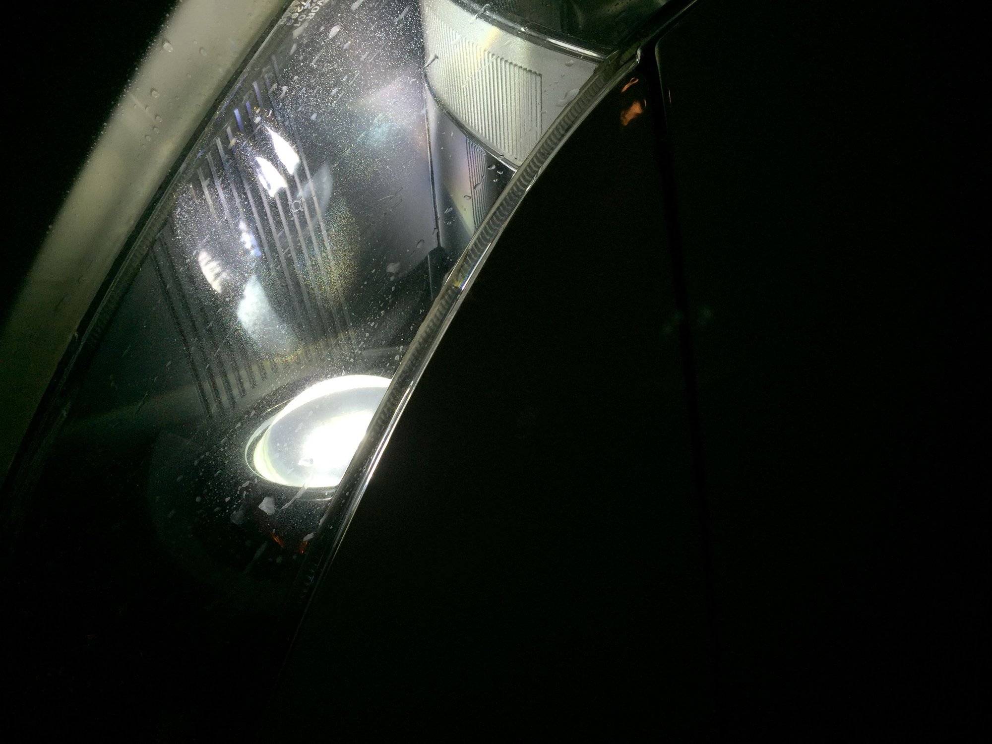

Alright heres some better photo of the haze. Notice the glare produced on the left headlight by haze. Any idea what can remove that haze? Rubbing alcohol perhaps?

That looks like normal wear from daily driving. Keep on mind small rocks and stones and sand etc are kicked up everyday when on the road and the highway. Over time the uv coating on the headlights will get worn away from the tiny rock chips. You can try a headlight restore kit like meguires but I'm not sure if that polishes away the remaining coating. You will most likely have to keep reapplying it to remove oxidation.
Mine ate worse than yours but they aren't to the point where they are cloudy yellow. If they get to that point I will use a restore kit depending on when this is and if I still own the car.
Your Headlights look to be in pretty good shape. Just keep them clean with soap and water.
