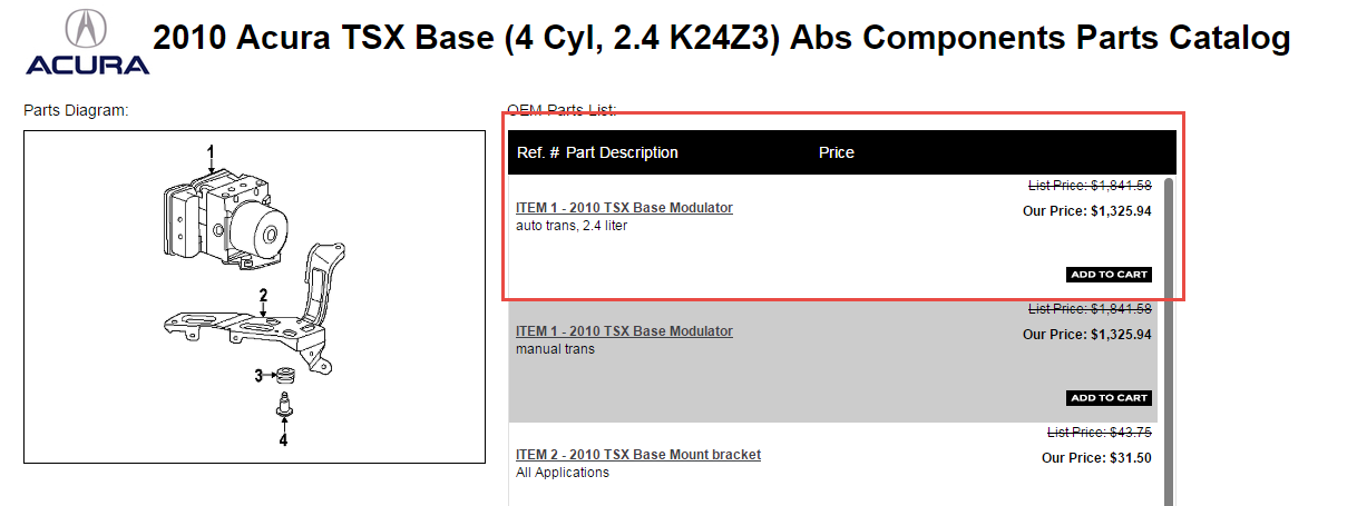

So I did some research and back then every website had the TSX V6 ABS modulator for $1,850 maybe $1,700. I called back the rep and told them to proceed with the service, knowing that I would pay just about $2k.
I just did a quick research the the module is cheaper! $1350 so I would definitely ask for parts price match if they can or buy the parts and bring to them (OEM of course)

JDMaccord - Where did you find the module for $1350? Can you post a link pls?

Nevermind, I found a couple links where a new OEM module is listed for $1300. That helps a little.
2010 Acura TSX Base (4 Cyl, 2.4 K24Z3) Abs Components Parts Catalog

That seems reasonable. FWIW, I just looked it up and the factory part is listed at between $810.xx and $2066.16, so...not cheap.
I would dive deep into the internet and try to find out why the ABS modulators fail on Acuras first. Buying another used one is a crapshoot, unless there's a way to test it first. Considering the cost of a new part, I would be inclined to test and check the known bad modulators you have (was the old one saved by you?) and go from here.

I am just now seeing the new posts. What you are experiencing in the video (that video is an excellent demonstration, by the way) is EXACTLY what I did. It was extremely stressful, attempting to drive home with the brakes like that. I'm pretty amazed that Acura has allowed for this kind of issue. From what my dealer told me at the time, a lot of people with this model have had this same issue. Imagine someone having a serious accident or running over a child because of Acura's faulty abs module!!
As I wrote above, I found the part for around $1300 and ended-up getting the service done. For the next year I drove with panic attacks wondering if my brakes were going to work, and always driving extremely softly so as not to put a lot of strain on the abs system. What really disturbs me is that these parts are obviously faulty, and even if you opt to buy a new one, that one is liable to go bad too.
