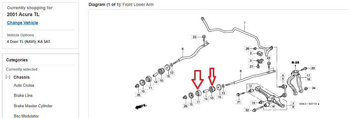

Have you examined the 24+ year old #10 & 11 left radius rod bushings (or their associated components below) to see if they have perished?

Great idea, I actually didn't think of checking those. Will check them out to see if they are good or bad.
