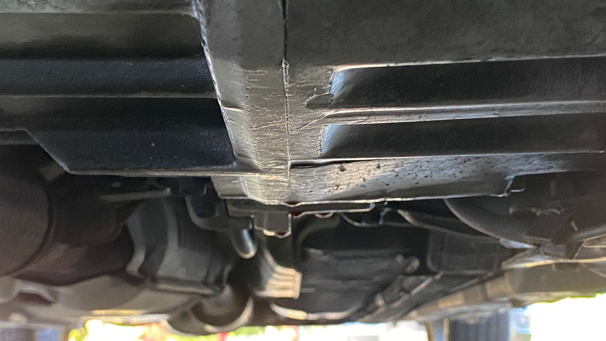

Hello all-
I'm new to the site. I thought I'd start out here, and see if I could get some early advice. Here's a view from the front of my '03 TL Type S, looking to the back. You can see the drips. I'm wondering if this looks familiar to anyone, and this might be a telltale sign of something specific. Thanks.

You can check if it's oil or transmission fluid by inspecting the color of those fluids from their respective dipsticks and comparing it to a sample what you see dripping.
I'd say this is the rear main seal or oil pump seals leaking. More than likely the rear main which is pretty common given the age of our cars.
It's probably the single most costly item to replace given that the part is a few bucks, but requires removal of the transmission to replace.
Mine weaps so little that I just bought a oil drip pad for my car when it's parked in the garage.
