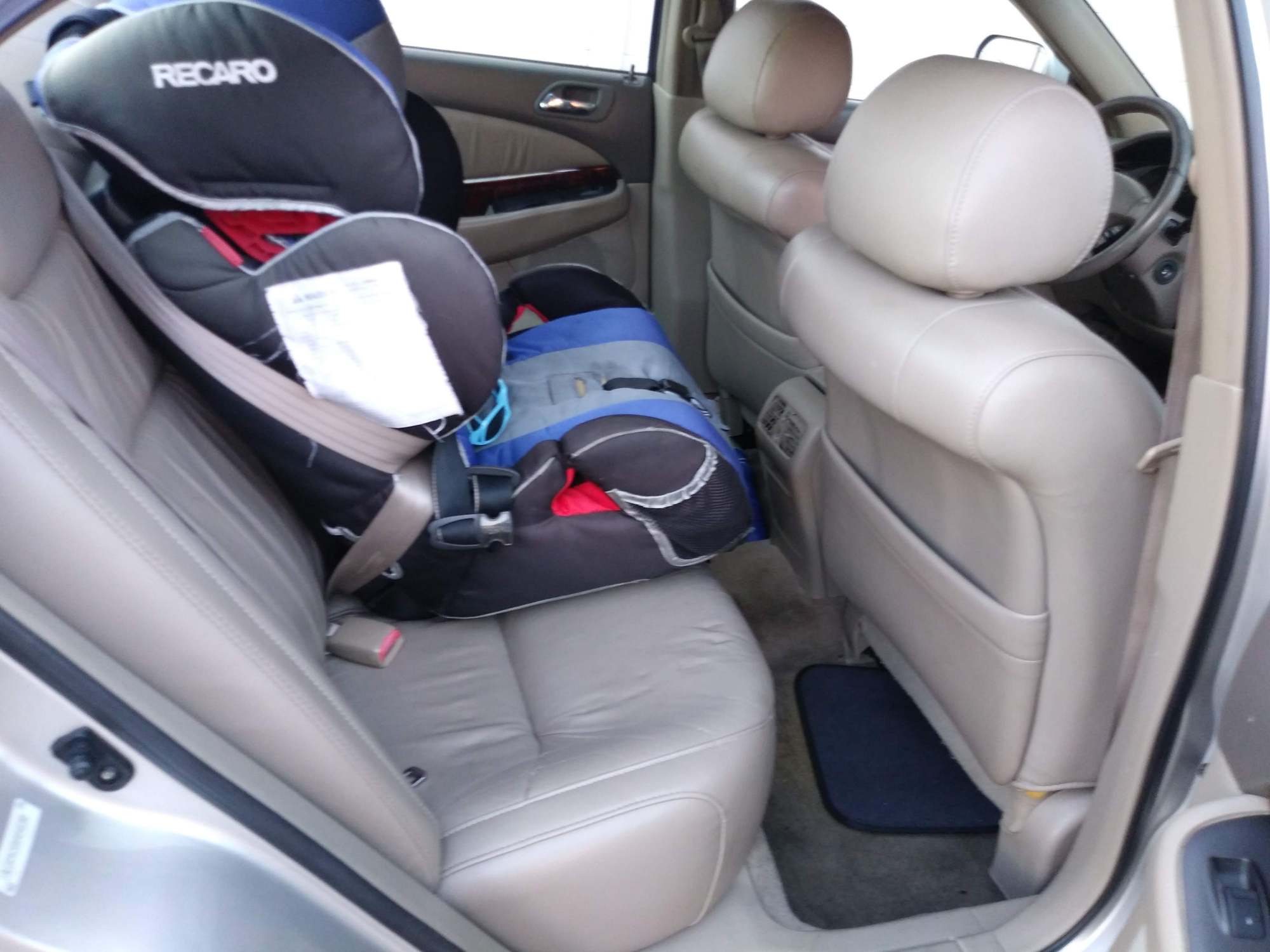

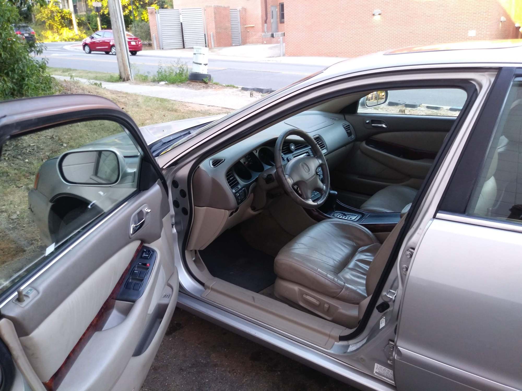

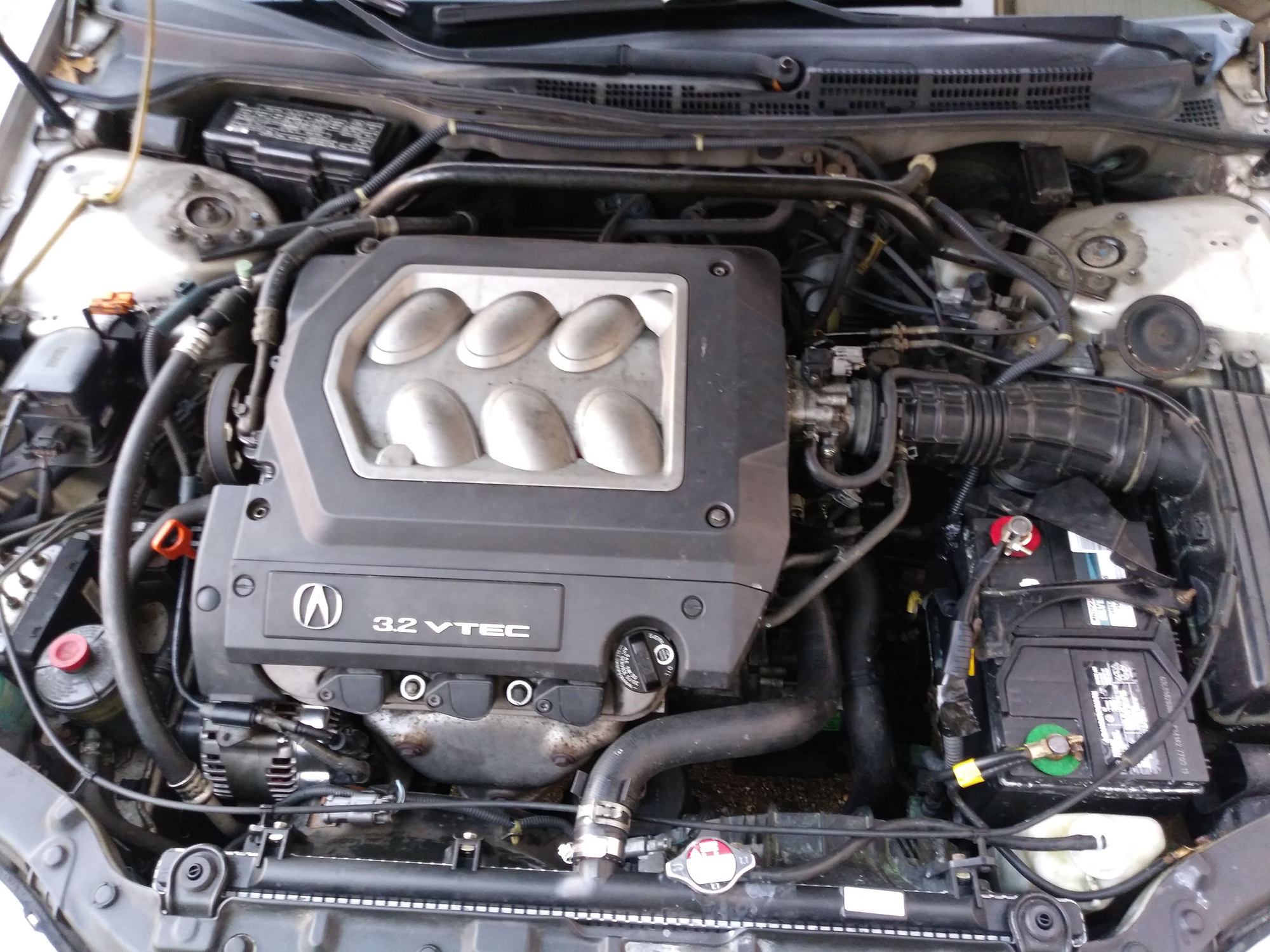

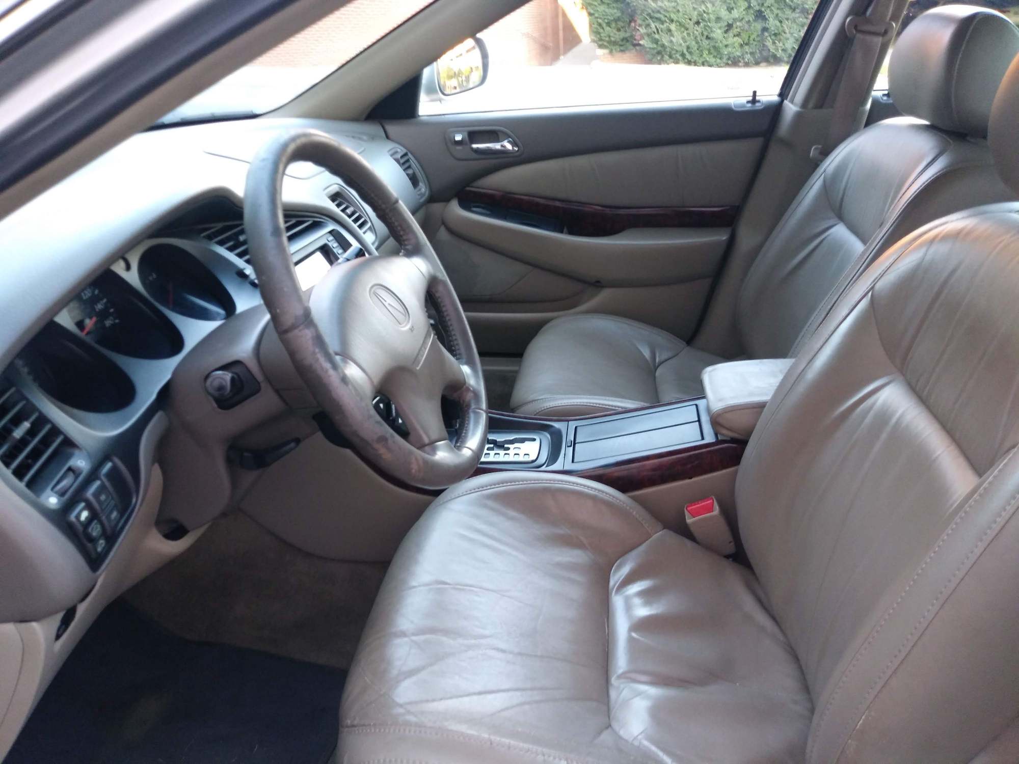

Hey, guys. New member here. Bought my first car -- 99 TL -- about a year ago with ~150k. It's up to 165k now and I've noticed jerks while going from drive to reverse; reverse to drive; and going from 1st to 2nd. Recently, I can hear a clicking when it downshifts to stop at a light. It's been 4 months. The jerks appeared after I did my radiator. My car heated up after the new radiator (not enough to go to red zone) because there was still air trapped in the system (apparently, 20 minutes of bleeding does not suffice). I changed engine and transmission oil after this slight heating incident just to be sure and..
I had both changed after I got the car. I didn't have any trouble, then. I didn't do a 3x3 on either occasion. Just simple drain and fill. Oil levels are fine.
I had both changed after I got the car. I didn't have any trouble, then. I didn't do a 3x3 on either occasion. Just simple drain and fill. Oil levels are fine.I'm a student and can't afford a new tranny so decided to do some fixes myself. I checked the A/T Clutch solenoid screens. They were a bit clogged and cleaning them made a tiny difference but the jerking is not completely gone.
Should I spend money on the switch solenoid C? I haven't checked resistances on any solenoid. I checked grounds today and voltage regulator and alternator. They're fine.
Also, my wife made a video with the movement of the engine (
.. pardon the PS sound). Do you think it's just a mount? From the videos I've seen, I can't tell much. Pardon my ignorance -- I just learned how to drive a little before I got my first (this) car!
By the way, awesome forum. You guys make me wanna keep the car sweet and clean.

You should be able to see deterioration of the side mounts...they should be changed if not already done
The front needs a change if not done already. Check for a vacuum leak here.
The rear is a pain and usually done when timing belt done.
Check your CV joints for leaks or damage, as a possible source of jerking. Both of mine were done in the last year...~90K. Easy to install and cheap.
GL, post again. You have one of the prettiest cars on the road.
