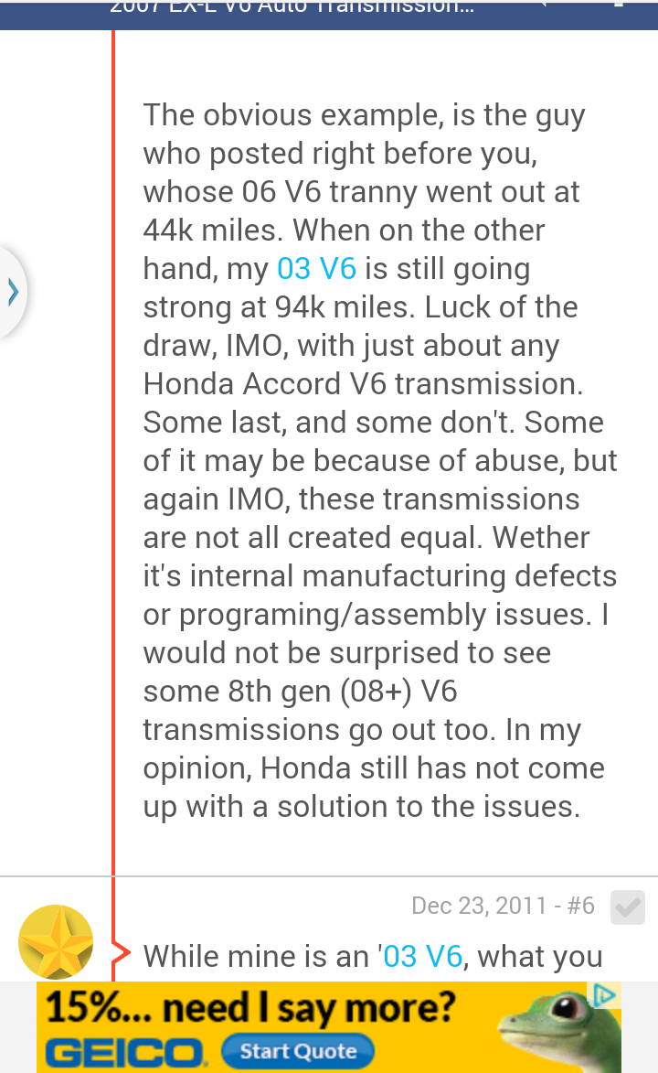

FYI... Link is below.
2007 EX-L V6 Auto Transmission Problems - Drive Accord Honda Forums

Originally Posted by 01tl4tl
and still they are a better option than rebuilding a TL trans!
Easy for you to say. I dear you to go tell that to the two poor saps that just did their av6 swaps on another thread here that are having problems and now pleading for help?
I'd be piss if I spent around $1500 dollars and still having problems in 1-2 shifs... erratic shifting... flares... etc.
