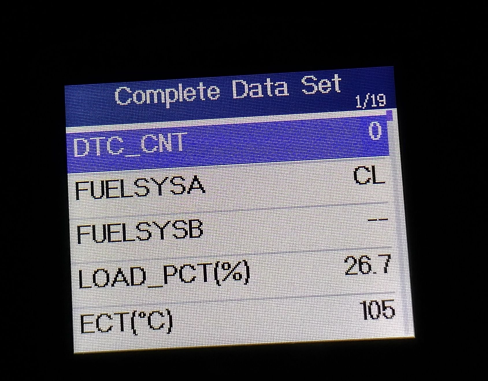

Jon, I have not done any of those you mentioned.
Here's the data reported by my scanner.

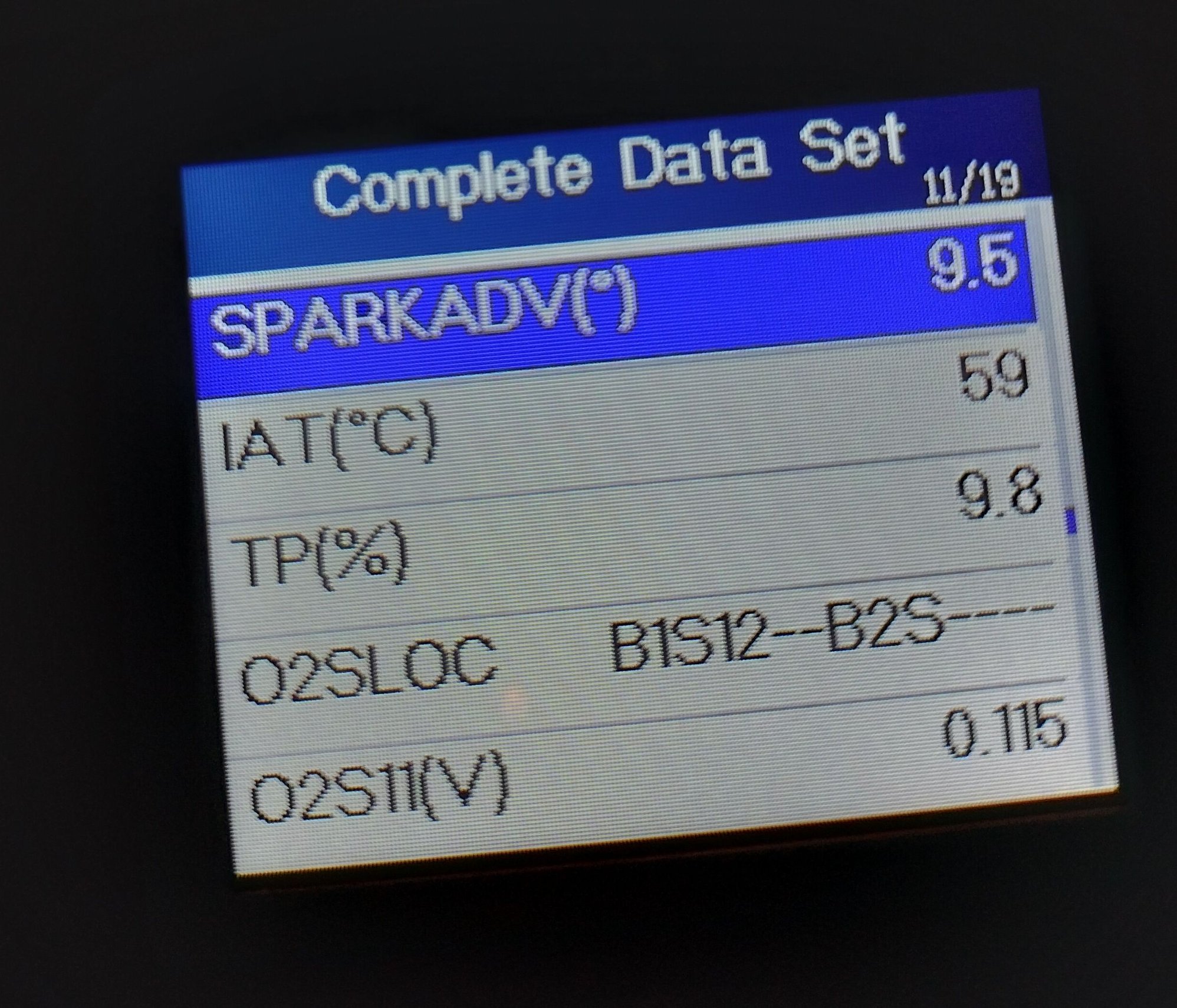

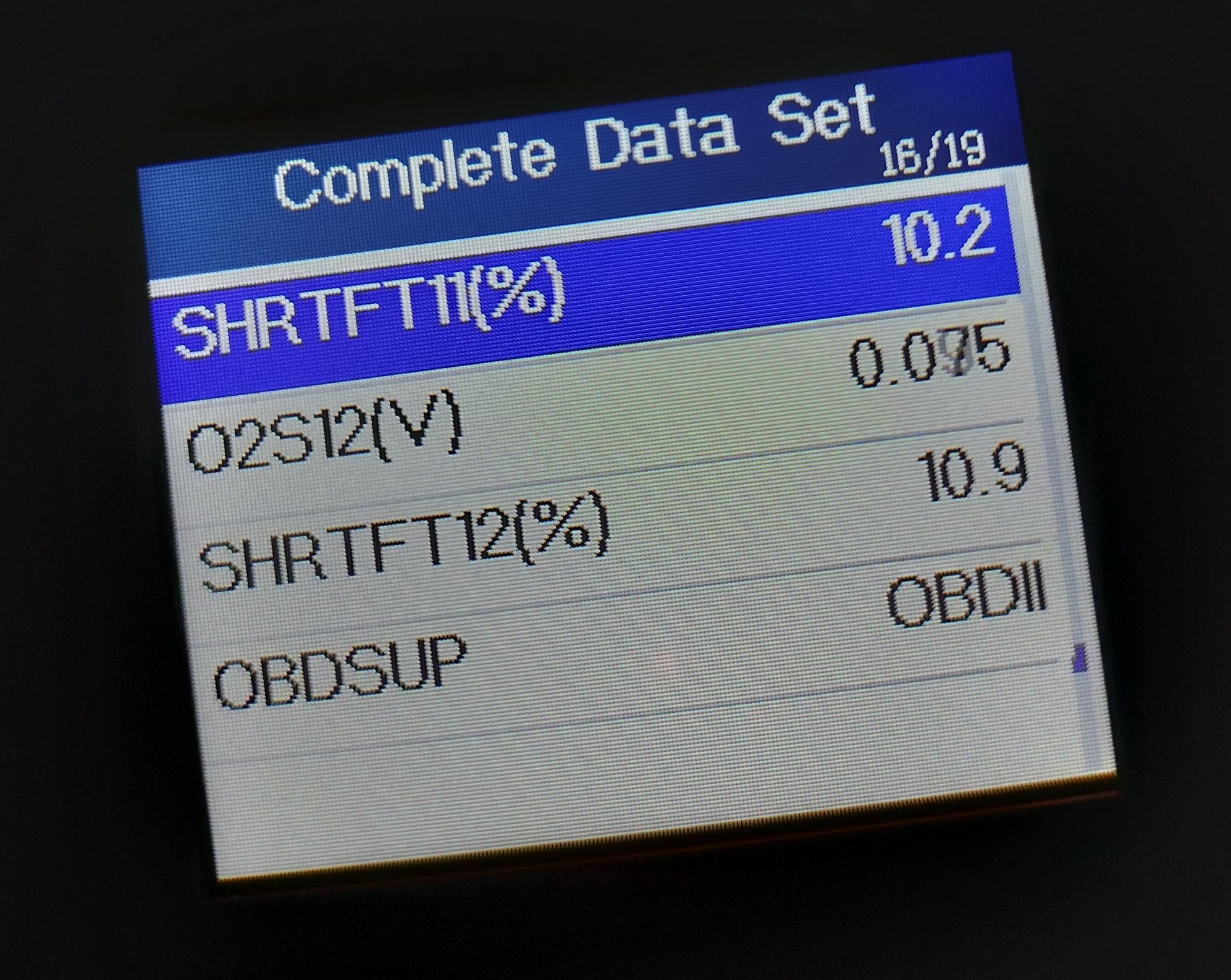

Looking at the OBDII data there are a few items that to me seem questionable. Going through each reading below:
DTC_CT = 0 means there are no reported error codes.
FUELSYSA =CL means that the fuel system is using the ECU to control the air/fuel mixture. This is how it should be.
LOAD_PCT(%) = 26.7 this is the calculated load value based on the MAP reading which at idle should be around the barometric pressure where you live.
ECT(C) =105 this is the engine coolant temperature, in this case in Celsius (C), in F it would be 221. To me this is high although at the top of the spec for the radiator and the fans should be on at this point. I would expect to see 190F-200F.
SHRTFT1(%) = 10.2 This is the short term fuel trim. Ideally this would be +/- 5% but over 10 indicates an issue. This number can go from -20 to +20. A reading of -20 would indicate that the ECU is trying to reduce fuel input trying to lean out the mix. A reading of +20 would indicate that the ECU is trying to enrich the mixture as there is too much air in the mix. This fuel trim is used for short term fuel needs due to immediate differences in loads, such as climbing a hill.
LONGFT1 (%) = 10.9 This is the long-term fuel trim. It is the same as above but changes slower. It is stored and used when the car is shut off and later started. The same explanation above applies.

SparkAdv = 9.5 Timing reading in degrees. Looks fine.
IAT(C) = 59 degrees C (138F). This is the Intake Air Temperature. When the car is cold the IAT and ECT should be close to each other within a few degrees.
TP(%) = 9.8%. This is the throttle position sensor and at idle it should be around 10%.
O2S11(V) = .115v. This should be the first O2 sensor (before the catalytic converter). The readings should be a square wave but unless you have a graphing unit you will see a number that is taken at a moment in time. You should see it changing. Ideally the average would be around .45V over time.
O2S12(V) = .075v. This is the second O2 sensor (after the cat).
My thoughts and maybe other people have more, is that from all that you replaced and from what I think is a high temperature reading the thermostat could need replacing. It is not hard but it does mean you will lose antifreeze. If you haven’t replaced the hoses in the last 3 years, I would replace them at the same time. The top hose should be hotter than the bottom hose as that is the function of the radiator, however if the top hose is extremely hotter the thermostat may not be opening up all the way I would then recheck the OBDII readings.

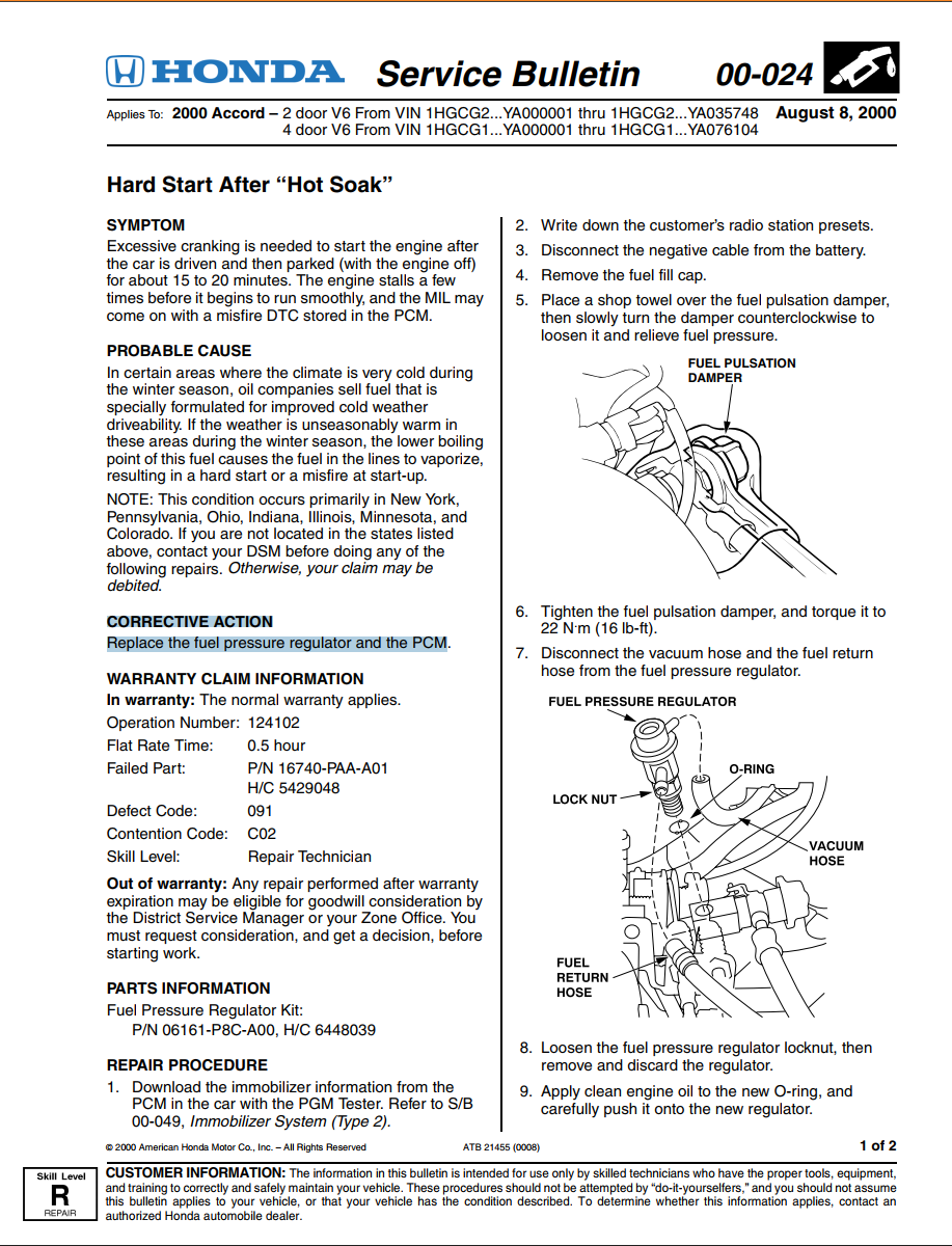

Some google search shows this hot engine installing issue is rather common on 2000 Honda Accord V6, which shares pretty much the same engine with the TL. In 2000, Honda issued a service bulletin on the so-called "Hot Soak" issue. Their fix is rather quite expensive: replacement of both Fuel Pressure Regulator and PCM.
While some people have fixed the issue by replacing the fuel rails from Honda Odyssey or Acura CL and fuel pressure regulator, some others fixed it simply disconnect the vacuum line from the manifold to the fuel pressure regulator for a month or two while they still drive the car. Of course, they use another vacuum hose with a seal to stop vacuum leak on the manifold, and then add fuel injector cleaners to the fuel. My question is whether or not such a simple solution will damage the fuel injectors.

Jon, Honda blames the stalling on the ethanol vaporization in the fuel rails when the engine is hot, which explains why some 2000 Accord owners have had the same stalling issue that I have with my TL. It doesn't matter what type of terrain I park the car. It can stall right in my garage or any level ground as it can stall on any unleveled parking surface. Perhaps my switching to use regular gasoline since 2008 has something to do with it. I just recently learned the sad fact that regular gasoline contain much more percentage of ethanol and foaming agents than premium gas does. So I need to switch back to premium gas for sure. Per your suggestion, I am going to replace the thermostat and water hoses soon. Also, I feel I need to clean all the fuel injectors as well. If cleaning them can't solve the issue, the next stop will be to replace the FPR.

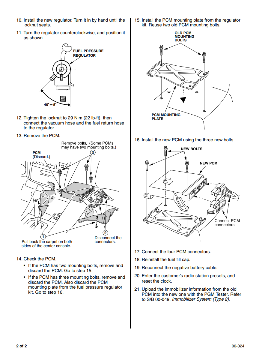

No, you don't need to replace the PCM if you replace the FPR with the exact same type FPR. You only need to replace your PCM when you install one with capability to handle large pressure.
​​​​​​A YouTuber had fixed the installing issue on his 2000 Accord by disconnecting the vaccum line from the FPR to the manifold for a few weeks. You need to make sure you seal the vaccum line on the manifold so there won't be any leaks. Also, he used premium or pure gas while adding fuel injector cleaners in the fuel. After a few weeks, the installing can go away.
Old Nov 15, 2022 | 02:29 PM

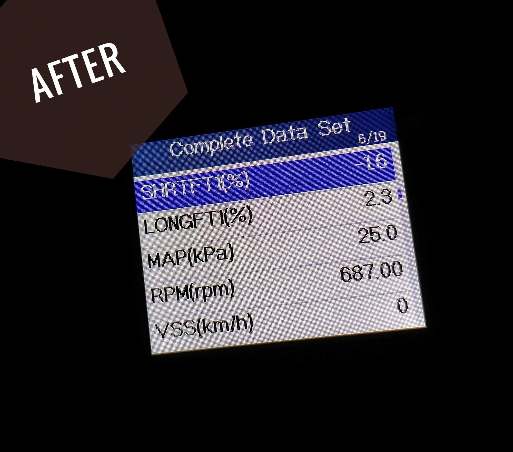

I replaced the thermostat and another ECT and cooling fan switch switches, along with water hoses, last week with Honda factory parts.
​​​​​​Yes, there's a issue with the 22-year-one, the rubber gasket on the pointy head has become disintegrated. After the replacement, I switched to pure 87 gasoline (without any ethanol added). So far, the car seems not having the installing issue anymore. But, perhaps the weather is not hot. I have to wait and see.
Another thing is that both the short-term trim and long-term trim numbers are getting better after putting in the pure 87 gas. Attached before and after readings here.

DBL,
Great! There was some discussion concerning the gas and it may be a contributing factor; so I an wondering if you are up for a short experiment. You can try using the gas station you were previously buying at and see if it makes a difference, as this was put forth due some vehicles with a hot soak issue, if the problem was mostly the thermostat being block it would have increase the temperature of the engine by not allowing the full flow of coolant which could lead to a hot soak type of issue. In any case, best of luck with the car with many miles of safe driving.
