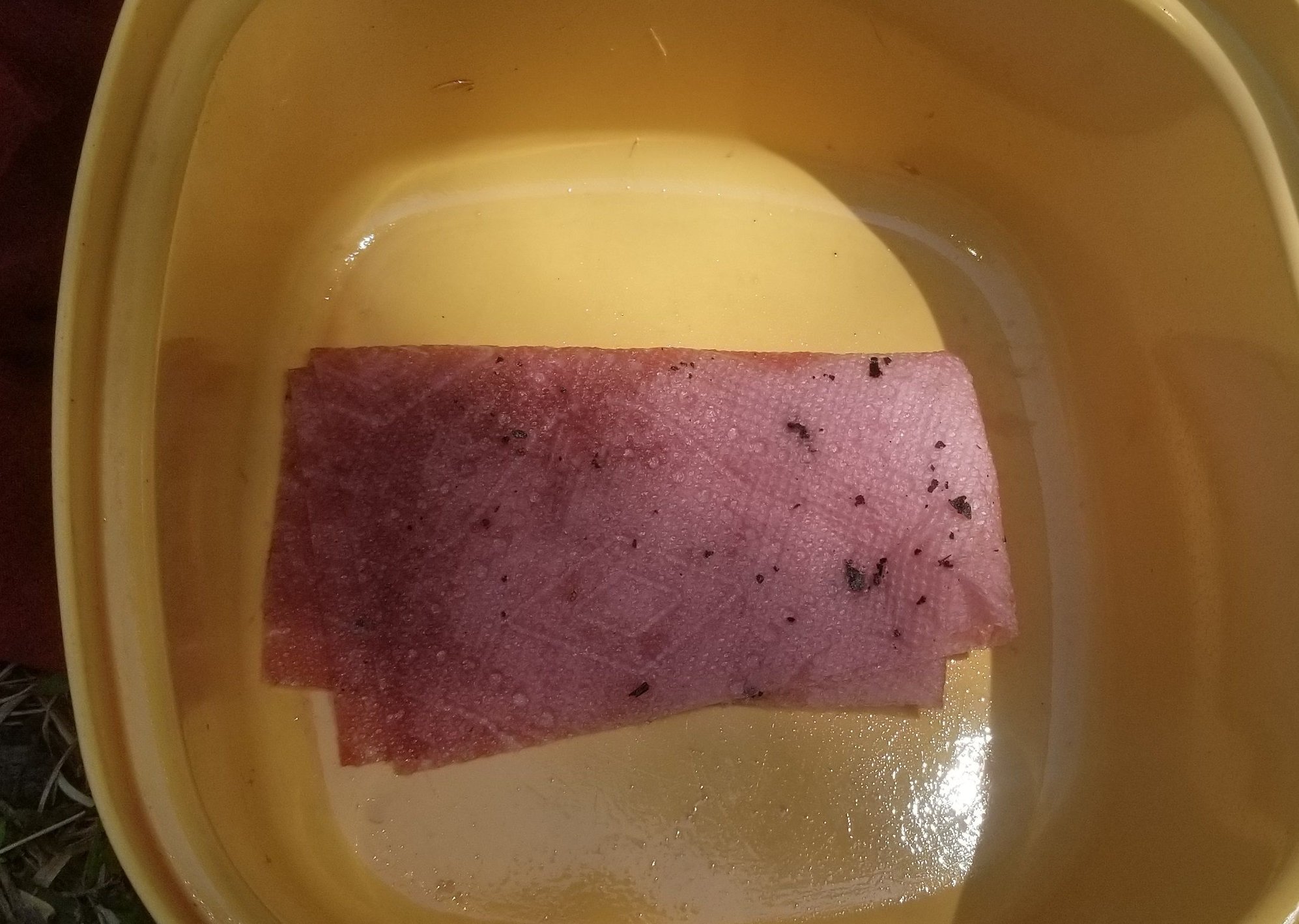

This shows the 'flakes' drained after back-flushing the LP Port (Pump). In multiple flushes, I've removed about 5 times this amount. It doesn't come from drive-testing, only from back-flushing my pump.
OVER-FLUSH: Yeah, who'da thought? My first test drive (after back-flush) was to the auto parts store, where I picked up a can of Sea Foam, hoping to get a maximum gunk removal before my last 3 x 3. My second test drive, with a can of Sea Foam in the case, left me stranded on the side of the road, 4 miles from home, with a completely disengaged transmission. The pressure gauge confirmed the pump was clogged all over again, and the ATF, which I had thought was about 2/3 of the way cleared up, was now a dark black-burgundy again. I had to do a road-side back-flush and drain to get home again. The instructions on the can had said to pour it in and drive 100 mi. then drain. Well my ASM (Automatic Sludge Maker) only made it about 30 miles. I should have kept this flushing exercise to driveway testing.
