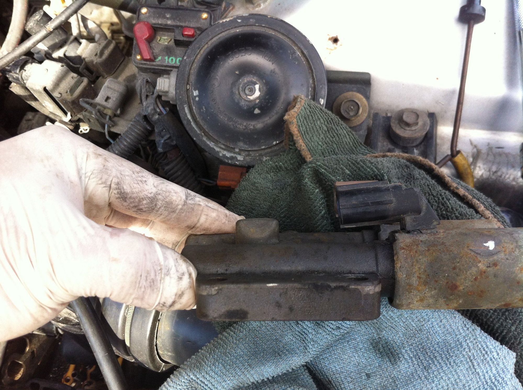

3.2tlc Check the control solenoid valves A/B right by the battery tray, Sometimes the black connector comes into contact with the tray and damages the connection.
Also make sure the valves actually move freely inside.
Lets say you put an AV6 trans and you swap over the solenoids, you could face the same issues.

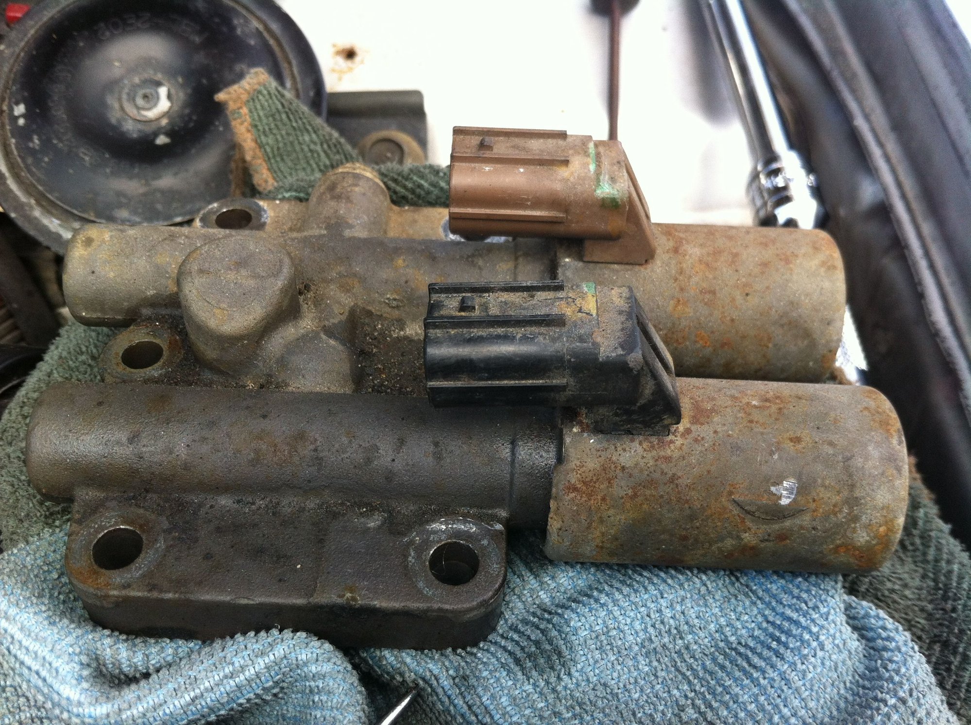

The P1750 code which indicates a mechanical problem within hydraulic system led me to to checking that A/T Clutch Pressure Control Valve linear set A & B which you showed in the above pic. The one on my car's tranny appeared much better than the one shown above. After pulling the valve's top and applying power to the solenoids, they seemed to work ok. The internal middle feed tube's bottom screen was gunked up, while the other's looked good. After road testing, problem persisted.....flashing D5 and CEL came back on with the P1750 code again.
As of now, I'm thinking of replacing the pressure switches and the shift control solenoid valve C.
