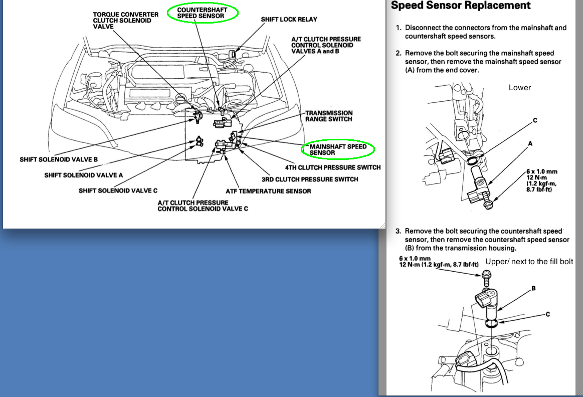

If the D5 light flashes as soon as you turn the key to position II that tells me theres an electrical fault.
You mentioned the speedometer doesn't work, Any sensor or solenoid that the ECU doesn't detect will make D5 flash and turn on the CEL.
More than likely the sensor is ok and its just a bad connection, Have a look at the wires and connection before buying anything.

I agree with Erick on this one mainly because I had the exact same thing happen to my TL. Although it happened to my 99 its essentially the same as the 00-03 minus one gear. Anyway I had the D4 light flashing on as soon as the ignition was turned on. I thought it was a bad trans and needed rebuilt. I started looking for obvious things after I pulled the code P0753 which is a fault in the shift solenoid A circuit. The code P0753 came back immediately after I cleared the codes like 2 seconds after the ignition was turned back on again. I looked everywhere for the problem and researched day and night. It turned out to be the wire in the pcm connector under the middle console that went to the Shift Solenoid A was not connecting. I fixed it by unplugging and plugging the connector back in. Anyway during the entire time the code was lit my speedo did not work at all. After I fixed the wiring issue, the speedo magically worked again and no more D4 flashing. It is most likely an electrical problem causing your pcm to shut off the speedo. The speedo in these cars rarely fail because its based off the countershaft speed sensor. Find out your code and go from there. Hope this helps.
