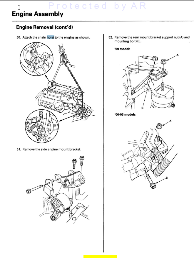

I have a spare JDM J32 I plan to drop in, but first I want to replace the timing belt etc.
To do so I need to lift it onto a tire on a table.
As it is just the engine, I'm not sure what lifting points to use.
Can I safely use the bolts in the spots where the exhaust manifolds would be?
I know this may be a dumb question, just trying to be safe.

B.TL, in the manual the locations are in the engine removal section. If I remember correctly there is a metal loop near the power steering pump toward the firewall and there is a bolt hole on the driver's side of the engine in the head that you can screw a bolt in with a bracket.

I lost my manual so big thanks.
Saw the one loop, but couldn't find another spot to hook things up to.
