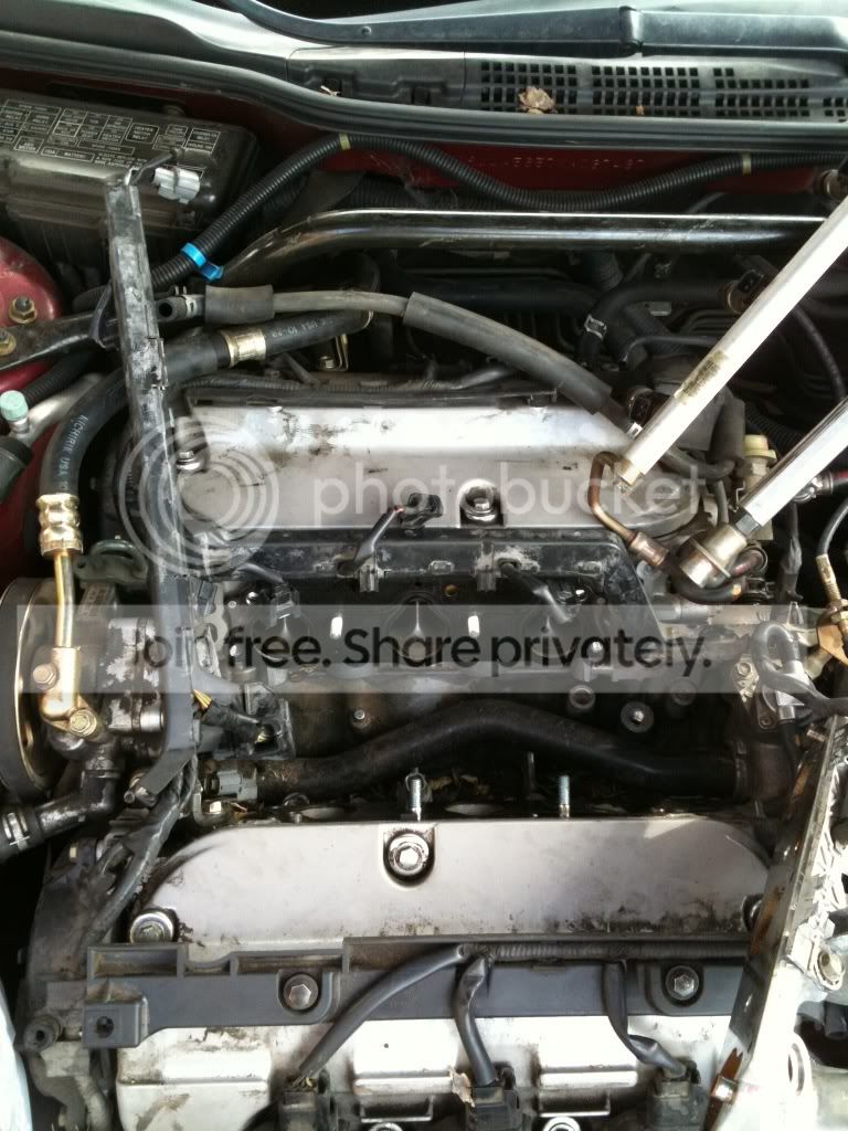

I had to get into the knock sensor about a year ago.
I had to move to maryland for a few months but couldn't take the car with me, so it stayed in CA for a few months in a friend's backyard. When I came back to move the rest of my stuff and get the car, it was throwing codes and one of them was the knock sensor. Only had about 12 hours in town to get my stuff before I drove it entirely across the US back to maryland. Only had a few tools available in my toolbox in my storage unit. Proceeded to take the car apart in the storage parking lot. Found out that rabbits and squirrels had made a nest between my upper and lower manifolds and chewed the entire wire away.
Had to steal wires from an old battery kit I bought from radio shack a few years back and soldered it in place of the missing wire. Got it working within a couple hours. Worst luck I had with rodents, best luck I had with tools and experience available to make the repair.
They left me almost nothing left to work with for splicing the wires.

Hey Stimpy, thanks for the info and pic. Great job at improvising and rigging !
