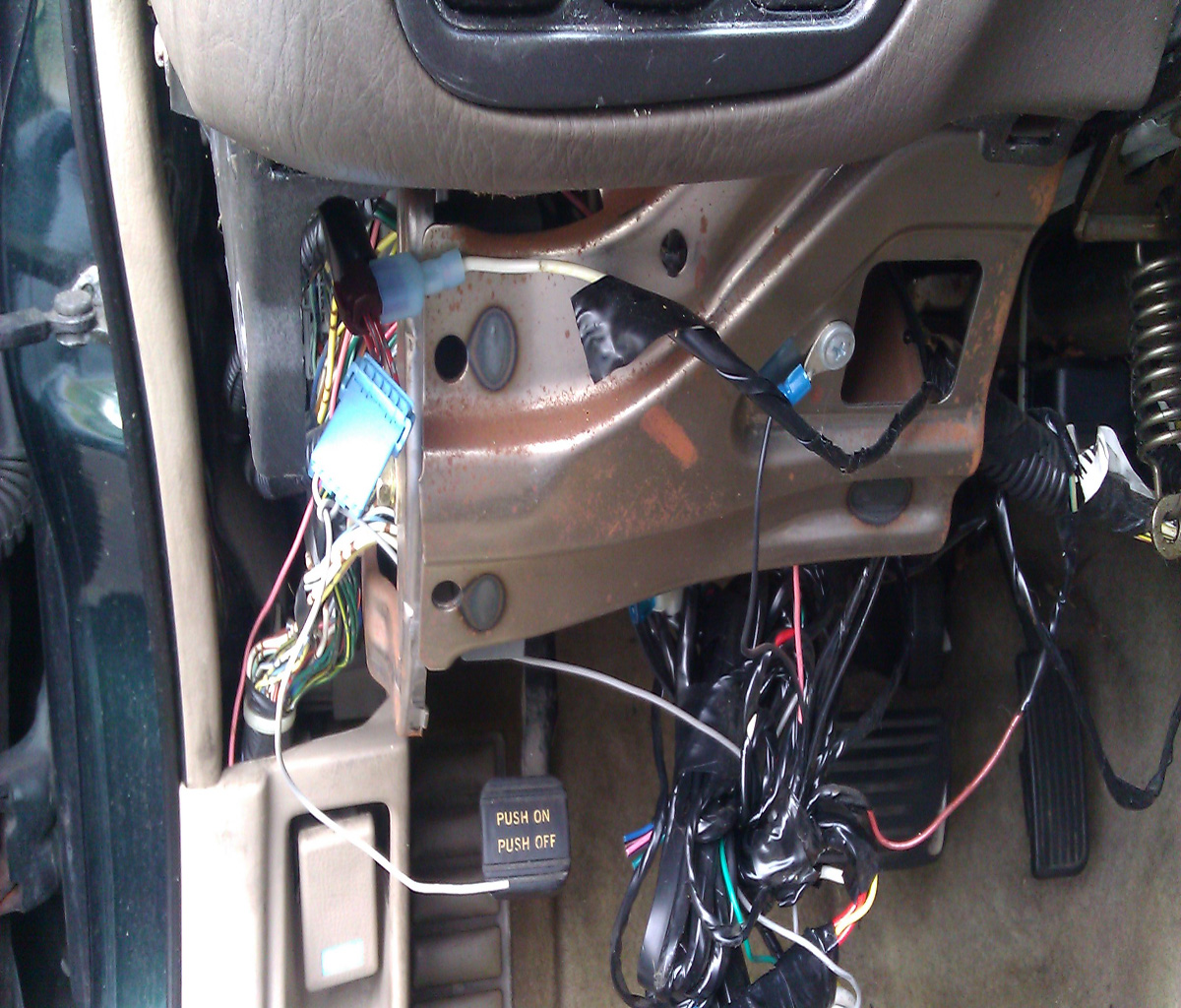

I pulled everything apart, unplugged the switch from the socket, and unscrewed it from the column and then realized the alarm is wired into the switch. There are open wires everywhere and this just doesn't look like a Acura Dealer job. My alarm has not been working from the remote since I got the car. I figure maybe the immobilzer or these open wires are killing the car. I don't know how to check though. I tape up the wires, and put the old switch back. Went driving, and it still nearly died.
Is there any way to put this switch on without splicing into the wires on the new switch? Can I just leave the alarm wires off until I can take it to a shop and get it looked at, or will something get damaged. I see my dash dimmer is wired into it as well and it's not currently working so maybe someone screwed the wiring up. I have no original radio, and the navi comes on when it feels like it.

Hey Rebirth82, that's quite a mess you've got tucked away in the black tape.
Judging by the overall appearance, I'd be very surprised if that was something that an Acura dealership would've done at the time of the recall work for the ignition switch.
It'd be safe to assume that whoever replaced the factory radio and alarm, butchered the wiring. It appears unsafe and needs to be all redone utilizing a wiring schematic to get it all back to normal working order. Unless you feel competent enough to undertake this challenge, perhaps it would make sense to leaving a pro tackle this mess ! Yuk.....!

I have no idea. The honda remote won't program to it. The receiver in the window says echo on it and has a button. Not sure what each setting is on a button press. I did leave it on once though and it killed the battery. It was daytime, and I didn't see the l.e.d in the window until the next night.

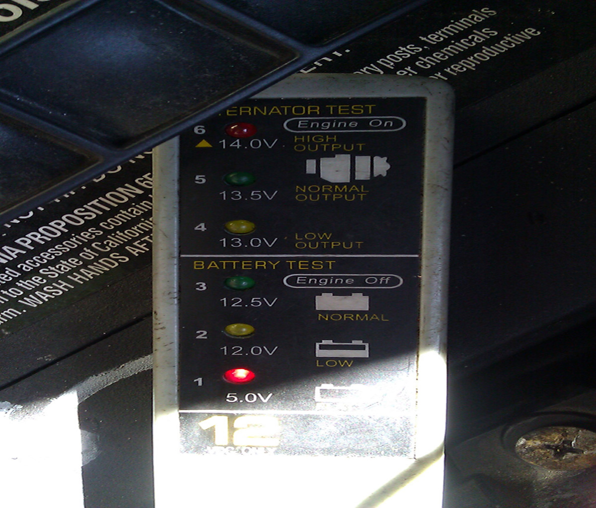

I pulled the old switch off again and just left it hanging with the wires it was attached to. I put in the new one, changed the battery terminals since one was kind of loose. Jumstarted it, and the lights are still on dash, and still dim. I tested the battery which usually passes but now it says flat, and there are no lights for the altenator at all. maybe it is going out, or maybe something is missing from the wires that are not attached to the new switch. battery is at the store charging, so going to put the old switch back on again tomorrow, and test with battery again. I may end up sucking it up, returning the switch, and having it towed to Acura, or Honda since it's closer to me. I'll post tomorrow once I check it again. Any ideas that would save me $125 for a Acura diagnostic, + more $$$$$$$ for the repair would be appreciated.
Picture is with the car on
If you recently replaced the battery, and you're still experiencing starting issues.....chances are that the alternator is going bad. You have several different things going on, but need to have a good working electrical charging system in order for the car to start. There could be a problem with the main cables from the battery, check connections....especially ground.

I initially thought it was the alternator, but after the passing tests multiple times, and reading about other people having the same issue, I wanted to check the switch.
More than likely, something is shorting out and causing a drain on the battery.
A wiring schematic would be helpful. Check any and all connectors, grounds, etc.
There are tests on the battery that could indicate a slow scavenger drain upon it.

Hey just an update and to thank everyone for their help. I ended up putting the factory switch back since I didn't want to cut into the new one like the old one is. I was testing the battery and alternator that same day and wasn't getting much reading from the alternator for the first time so I took it to have it tested. It had failed but for some reason would always pass while is was in the car. Reason for failing was the power steering fluid got inside of it and fried it. Previous owner didn't have a cap on it when I purchased it.
Ordered a used one from http://www.automotix.com/ way cheaper than the parts stores, and it came with a 1 year warranty. It came pretty fast, had it tested first and it passed. I put it in, and so far so good for about two weeks now. I was going to change the alt belt and power steering belt and hoses while I was at it, but I am getting my trans done soon. I don't want them to toss brand new Honda fluid, and put cheap stuff in it. Also the power steering belt looks like a major pain to get on and off. Looks like the engine mount needs to be removed first.
