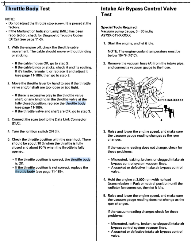

I think we recently through this but there can be several items. You have eliminated the vacuum to start. I would say the next likelihood is the IACV or throttle body issue. See Below.

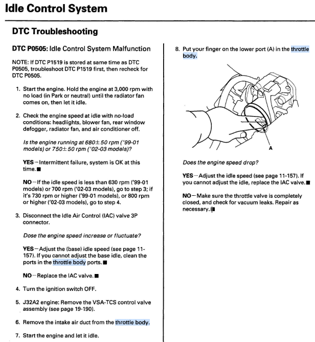

Have followed the procedures you mentioned. After keeping the RPM at 3000 till the fan comes on, the idle is around 700. According to the manual, there's no issue with the IACV Also the OBD reports the throttle is at about 10% and 90% when it's closed and fully opened respectively.

Few questions.
1. When you were running the above procedures did you do the whole procedure or did you stop where it says intermittent failure since the idle was 700? You should complete the rest anyway it might lead to the intermittent problem. Also, you mentioned that the idle changes after the car is hot after being driven (which you can do instead of idling at 3k to get it hot), you can turn off the car let it set for a few minutes and restart and run the tests again.
2. What happened when you disconnected the connector and when you covered the hole in the throttle body?
3. Have you cleaned or replaced the PCV valve and hose?
4. When it idled at 700 RPM when you tapped on the pedal did the RPMs start to fluctuate?
5. Any play in the throttle plate when cold or hot? (shaft movement the same?)
Didn't do the whole thing and stopped at "YES-Intermittent failure, system is OK at this time"
Didn't do this part since the idle was around 700 after the engine warmed up.
