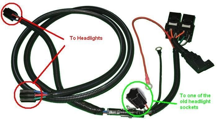

Old Apr 24, 2015 | 11:41 AM
Posts: 48,296
Likes: 9,170
alright so you've connected the positive/negative leads OF your relay properly, now, you just need to energize the input to the relay with 12V so that it will let the headlights draw power straight from battery. The input is where you'd usually tap into the older headlight output. YOu can use two alligator clips but just make sure they don't short out.
just a stock photo from internet so the plug might not look the same but the one in green will need to be energized
