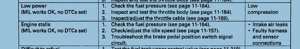

The 3rd gen cars has a throttle by wire design whereas we have a physical accelerator cable. there is a throttle position sensor; you could check that but the official information on that part is it's non-serviceable as it requires some additional skill/tools to set in place.
looking at page 11-9, I see:
Do those indeed describe your problems and is that what you have looked at?

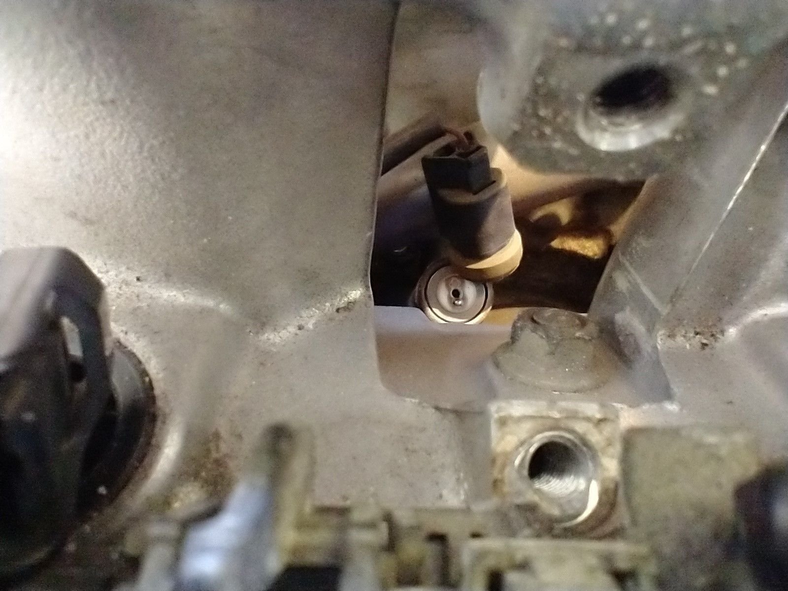

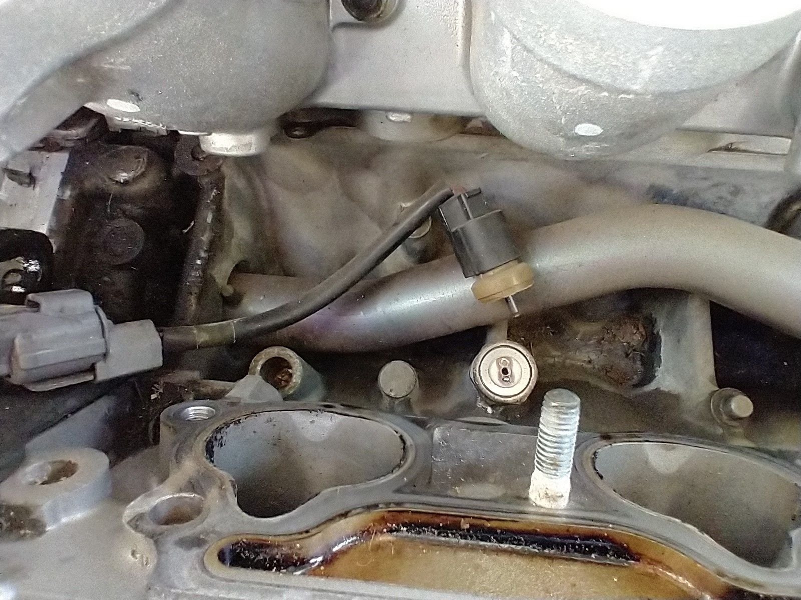

In the ongoing saga, as I was disassembling the intake I looked through the lower intake plenums and saw this:
Sorry for the big picture I don't know how to resize for the forum.
So, the knock sensor is/was completely broken off and apparently bouncing around. I don't know how the PCM would interpret the information it would receive, I imagine it would go from an open to a short as the center conductor bounced around. I have no clue as to how this got broken as I have never taken the lower intake off before, from the condition of the broken edges and the weathering it looks like it has been this way for a long time. Maybe breaking off slowly but who knows.
Do you think this could be the cause of all the issues or just some???
I have a knock sensor and an new wire, I was planning to do this last year when I took apart the upper intake to clean intake and replace the fuel injectors but when I saw what else I would have to remove I didn't do it, At that time it looked like the sensor was connected but it obviously was already broken I just didn't see that then. Gaskets arrived today but the injector rebuild kit has not yet arrived. As I am looking for a potential vacuum or fuel leak I am trying to replace all gaskets and seals.

I did go through the items in page 11-9 as you suggested a while back. I have a hard copy of the manuals and went through them first before I posted here. The fuel pressure I measured was 31 psi and this with two different pressure regulators. it is low from what the book says and I can't seem to find a fuel leak. This is one reason I started taking apart the intake to make sure there was no leaks or clogs in the system starting from the fuel injectors.
Thank you again. I think I am making progress but it will take me some time to clean every thing and reassemble. Still plan on adjusting valves once I put back the lower intake plenums (makes it easier to lean over to get to the back 3 cylinders).

I don't know enough to say that the broken knock sensor could cause those issues, but it sure wasn't helping the car! Either way, spotting that and replacing it is progress!

Well...your knock sensor does influence ignition timing. there's a good chance that was the culprit.

After getting everything back together I now have a screaming power steering pump. I had to move the power steering pump while pulling out the lower intakes, I disconnected and plugged the input line but that is all. No idea where this came from, It gets really bad moving the steering wheel.
FYI bbsitum,
Was able to work on the car and put it back together. I measured the voltage drop across the relays and fuses (from alternator to battery) and it was a steady .03V. The alternator is putting out 14.4 volts. There does not seem to be a problem in that circuit.
When apart I cleaned everything, really well. I replaced the broken Knock Sensor, and cleaned all injectors, replacing one that had a cracked pintle. Adjusted the valves, new plugs, fixed vacuum leak to motor mounts, replaced vacuum lines, and engine compartment purge lines. I am still trying to make sure the Idle learn is completed (thought so but not idling correctly). The car starts and runs when cool but when I rev the car it starts surging after I get off the gas. It was also still hard to start when hot but did manage to start. Looks like all the fixes didn't solve my problem(s). When I it is idling when cool it does idle nicely.
Ideas?????

I used the scan tool in a Scan Mode that has Acura/Honda specific tests. I can go into details if anyone wants them but it does test the PGM-FI, the ABS/VCS, and the SRS system among others. I ran those tests and got errors I didn't have using the OBDII scan. First, the SRS error I have had for a year and was not able to clear with the OBDII portion of the software was clearable within the Acura program. Second, as I ran through the test I saw the following errors:
P0505: Idle Air Control System
P0325: Knock Sensor 1: No Signal
83-1: which says it is a ECM/PCM relation failure.
This is after I replaced the Knock sensor and the sensor cable. After seeing this I thought I would look at the IAC valve. I followed the procedure in the manual (pg.11-148). After I removed the TCS assembly, I started the car, This set the idle really surging from 800 to 3000 RPM. I didn't know if this invalidates the test but covering the lower port in the throttle body did lower the RPMs and smoothed out the idle. Once I removed my fingers from the port it went back into the huge surging idle. I reassembled the TCS and all but the huge surging just continues. I cleared the errors it caused with no difference to the idle. I can't even hold an idle at 3500 RPM it just kicks it down and starts all over. I can see on the code reader the fuel system going from open to closed, The long term fuel trim and the short term trim are about equal. I think I have been looking at this so long the long term fuel trim is all based on the time I have been trying to troubleshoot the problems. I have sprayed carb cleaner, and water all over the engine and can't find a vacuum leak yet from the surging I would think there was one.
I am wondering if the PCM is the item that is broken.
Help Please!
Jon
