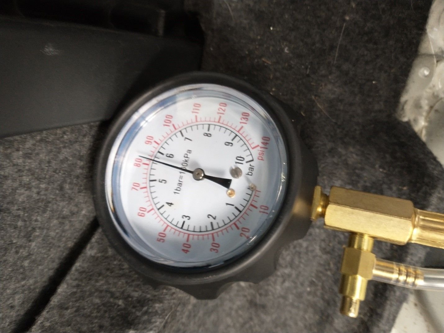

I rigged up a setup that allowed me to see the input and the pressure output of the filter. I previously measured over 100 PSI directly at the output of the fuel pump. The setup was put together as shown below:
Test setup for before and after fuel filter testing
After getting this mess into the fuel tank I applied 12 volts directly from the battery to input connector using 16 gauge wire and some lugs into a old fuel pump wire harness with one side cut off to allow the correct voltage orientation.
The picture below shows the two gauges when the fuel pump is energized.
Fuel pressure when 12.5 volts applied. Larger gauge is out of the fuel pump while the smaller gauge is from the filter output.
The before and after fuel pressure is the same. From this I would have to conclude that the new fuel pump is not working properly, although after thinking the new fuel filter was bad since the pressure dropped so much I am not sure if I can say the pump is bad. I still can't believe a pump putting out 100 PSI would fold back so much when a filter is placed in line.
Am I looking at this correctly?

I have previously measured the same fuel pressure at the pulsation dampener (before the fuel rail as prescribe by the manual) as I do at the output of the fuel filter. The engine running or not won't effect fuel pressure that is lower than the specification, there would be little fuel returned to the tank and the fuel pressure regulator will not work as it can't increase the fuel pressure. What the same pressure at the output of the fuel filter and the input of the regulator says to me is that there is no blockage in the fuel lines. The manual states that the fuel pressure at the regulator should be 48-51 PSI for a type S. At 20 PSI you would be lucky to get the engine started and if you did get it to idle correctly you couldn't drive it.
I hope I am not wrong like I apparently was about the fuel filter but I think the fuel pump needs to be replaced. The reason I tested it directly was to remove all other car components from the loop, so it couldn't be electrical or other blockages along the way. Hopefully this make sense.

My basic understanding of the Fuel pressure regulator operation is the OEM version is set to regulate within the engine specifications as long as the base fuel pressure is present. A high base pressure would have the fuel routed back to the tank a low fuel pressure it cannot regulate as it doesn't meet the pressure threshold of the spring inside the regulator. When the base pressure is there the vacuum will allow the free flow of fuel as the pressure differential across the fuel injectors is within spec. When you hit the gas the vacuum decreases and there is a little ball valve that no closes boosting the pressure across the injectors as it closes out the fuel return line. In a fuel injected system the base fuel pressure would have to be somewhere around 40-60 PSI for the system to work, in a carburetor system I think 12-20 PSI was require I believe this is the basic way it woks. Hopefully someone here can tell us if I am out to lunch.
I agree with following the manual and I have but now I am in territory that is not covered by the manual. The manual states that a 2002 should have 48-55 PSI with the vacuum line disconnected and clamped. If not connect the vacuum line and reconnect then disconnect and make sure that the pressure rise when it is disconnected, which it does but it is still very low and the manual states check for fuel leaks and clogged fuel filter. Which is what I have been doing although without any resolution.
I REALLY need someone with more knowledge than I apparently have, I have two new fuel filters, and two pumps and I cannot get the proper fuel pressure at the regulator. I put in a Denso fuel pump which measured 82 PSI directly out of the fuel pump but when I go through the second fuel filter it measured 21 PSI. When I use the first new filter the output pressure is 34 PSI.
I connected everything back up and it measure 22 PSI at the fuel pressure regulator when the vacuum is disconnected. I have used two fuel pressure gauges and both agree have the same readings.
I have no idea why I can't get the 48- 55 PSI out of the fuel filter. HELP!!

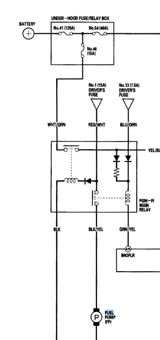

when you get goo pressure from the pump; is it under normal power (I think you mentioned that you were hooking it up directly to the battery to test) or through the ignition/fuel relay?
Have you checked all the fuses associated with the fuel supply system? pic below just in case any were missed...

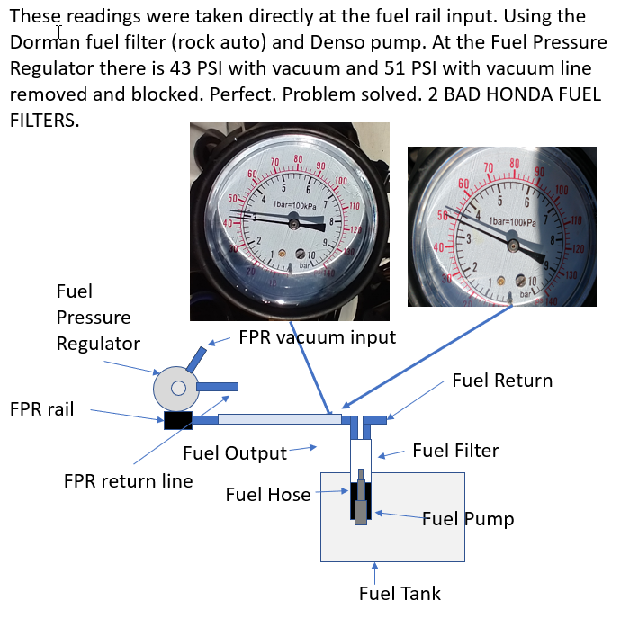

Thank you for your response. I think you misunderstood. The pressure from the fuel pump alone was good, the pressure out of the fuel filter which is connected directly to the fuel pump (in the tank) has been low. I am going to post some pictures below.
Whitetiger5,
Thank you for you response. When I got the good fuel pressure readings it was from the pump alone without a filter and it didn't matter how I hooked up the voltage. I hooked the voltage up directly to make it easier; since when plugged in it would only run for 2 seconds unless the car was running and the car couldn't run if I had the fuel lines disconnected. See pictures below.
Above is the setup that I was using to test the output from the tank. After 2 new fuel filters from Acura Parts HQ, which is out of Las Vegas, I kept coming back to the fuel filters being bad, so I ordered a Dorman fuel filter from Rock Auto and lo and behold the fuel pressure is great.
I measured 83 PSI out of the pump and through the fuel filter. I hooked this up to the fuel lines and return and measured the pressure at the Fuel Pressure Regulator and with the vacuum line attached to the FPR the measurement is 43 PSI. When the vacuum line is removed and blocked the fuel pressure goes up and stays at 51 PSI.
Final Measurement
Once you eliminate the impossible, whatever remains, no matter how improbable, must be the truth.” - Sherlock Homes
I drove the car up the hill that I have been using at a test and there was no hesitating, no slowing down, and no top end RPMs. Now I need to fix the fuel gauge meter that I broke when taking the filter in and out of the tank.
I can't believe I got 2 bad fuel filters. They must have one of the 3 problems listed below:
1. There is a blockage in filter
2. There is an open in the filter allowing the fuel to flow back into the return area
3. There is a crack in the plastic housing allowing fuel to leak back into the tank.

Incredible! Guess I'll keep that in my Acura journal - stick with Dorman for fuel filters!

I made a mistake the replacement fuel filter was a Beck Arnley part, PN 0433015 (043-3015), cost was $39 plus shipping.
Whitetiger5,
The two fuel filters that were bad were Honda parts; they were purchased from CardinaleWay Acura in Las Vegas. They are doing business online as Acura Parts Headquarters. I purchased it from them, as I figured it would get to San Diego faster, due to their proximity I assume they are selling real Acura/Honda parts as they came with the Honda red and white label with the PN on it. I think that they have a damaged lot of fuel filter parts; at this point I think the most likely reason the filters failed is they have some microcrack(s) in the plastic housing and under pressure the fuel is being pushed through the housing back into the tank. I could prove it by submersing the assembly with the a pump in a bucket and see if I can spot it or put the filter in some water with a air compressor set to 80 PSI and see if I spot bubbles. I just don't want to waste the time. I have to replace one of the mufflers (input pipe no longer sealed and pipe is moving around causing the muffler to bang around), and I need to see if I can fix the fuel gauge sending unit so I can have the gas gauge working again, along with a lot of cleanup. I also have a 1989 Volvo 240 DL that I need to get running again.
Thanks to all who provided input and comments to help me solve all the issues, right now the car is running better than it ever has!

Hi Jon, things became worse. My phone died on me whilst in vegas, so I wasn't able to do much research/communication.
My problem is that the car will not accelerate smoothly when in drive, and felt even more at lower RPM and higher load (like going uphill in 5th gear) which is information I used to make an early morning successful trip back to orange county.
My fuel system components are all original, so I am anticipating that the issue lie within either the pressure regulator, or the filter; nothing I have read points to the pump itself as I have no problems starting the car, but I will more than likely end up replacing all three (to be proactive and avoid being completely stranded some other time) if tests show pressure is not optimal.
Still looking for pressure gauge and the fitting to test the fuel pressure, anyone with easy to find info on this is much appreciated...

thanks! I became tired of waiting for the fuel pressure test adaptor to arrive, so I replaced my filter/pump with the Beck&Arnley/Denso branded products from rock auto and the car made it up the hill to Victorville with no major issues other than some sluggishness I will ask about in a separate thread…
Whitetiger5,

if I have read this thread correctly, @Jon M;16684546 the issue was the FUEL FILTER?! My car is doing the exact same thing, exact same parts replacements, (minus a few of the more invasive replacements) & still doing the exact same thing!! Please tell me my reading comprehension has not failed me today?? 🤞🏻🙏🏻🤞🏻
You are correct! It was madding at the time and I went through the original and 2 other Acura Filters. ALL OF THEM FAILED. I did not know it at the time but all the testing kept leading me back to the same thing. I finally purchased the aftermarket filter and all the problems went away!
If you are experiencing the same type of problems and tried about all the same things I would highly recommend the aftermarket filter I purchased (See previous post in this thread). From what I could figure out, it seems there were some microcracks in the Acura filters and while the fuel pump was running and on level ground all worked fine, going uphill the fuel pressure would drop and car stalled or just wouldn't accelerate. The fuel was leaking through the fuel filter and back into the tank. Once I replaced the filter wit the aftermarket unit, I had full fuel pressure at the manifold and all worked great.

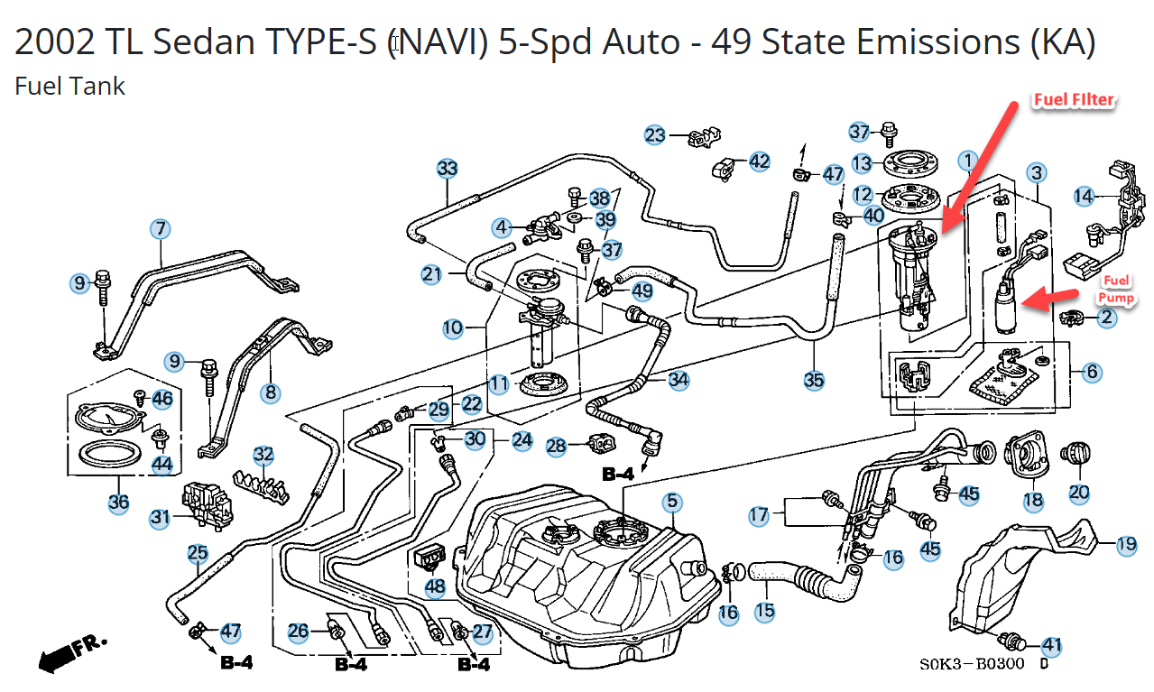

The filter is located in the gas tank. It is the large white and black plastic unit that the fuel pump where the fuel pump sits inside.(See Diagram Below) . The diagram came from https://acura.bernardiparts.com/acur...=5&assembly=43. The unit can be seen under the carpet in the trunk close to the rear seat, just to the left of the middle, drivers side. You will need to carefully remove the two fuel lines going in and out of the unit and take out the bolts that hold down the flange and rubber seal and the electrical connection. Then you can pull out the entire unit which includes the fuel pump in the middle of the filter. You will need to remove the fuel pump and reinstall it in the new filter, which is the big plastic unit.
Yes, do NOT buy the OEM buy the Beck Arnly unit. Much cheaper and it works. Beck Arnley part, PN 0433015 (043-3015) for 2002 Acura TL and TLS. Doing a quick check online you can get it from Amazon for $42 now
Amazon Amazon
or Walmart for about the same.
The filter on the sending unit is for the fuel pump and the big plastic piece is another filter unit for after the fuel pump (sending unit filter). If you replace the fuel hose in between the pump and the plastic housing make sure it is rated to be submergible fuel line or it will melt.
2002 Acura TL and TLS Fuel Tank ETC
Yes, do NOT buy the OEM buy the Beck Arnly unit. Much cheaper and it works. Beck Arnley part, PN 0433015 (043-3015) for 2002 Acura TL and TLS. Doing a quick check online you can get it from Amazon for $42 now https://www.amazon.com/Beck-Arnley-0.../dp/B004LGJAI2 or Walmart for about the same.
