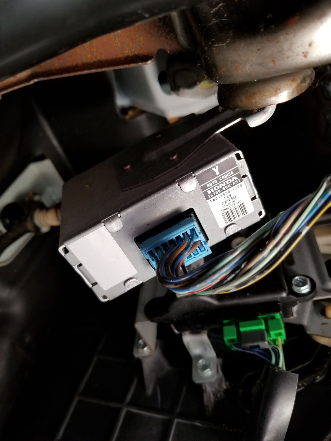

check that the cruise box is plugged in. some have a plug on the front of the box. could also try replacing the brake pedal switch.

I'd checked the plastic piece and fuse. still can't find the problem. where is the cruise box located?

follow the cable across front to pass side

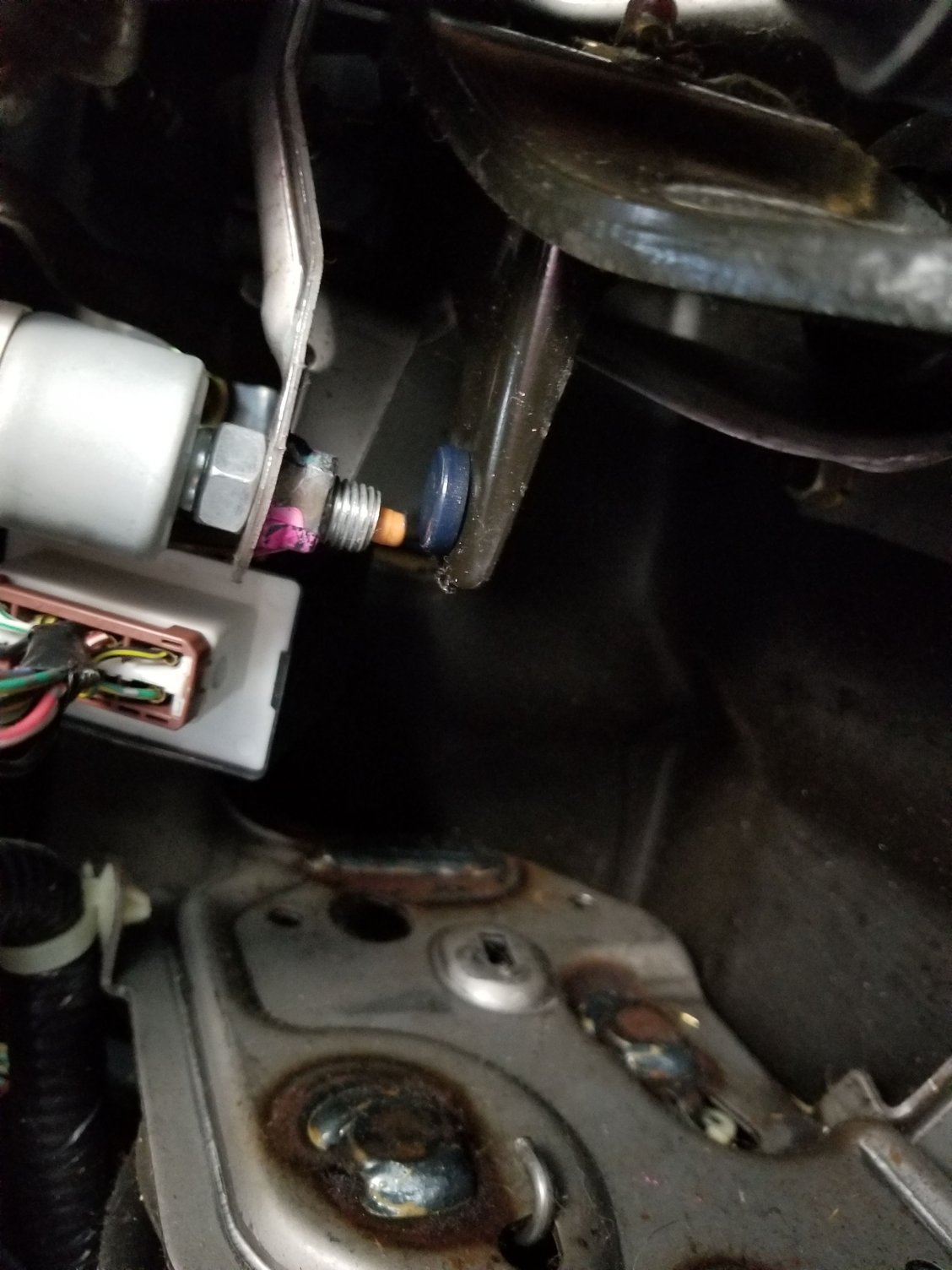

LOOK under dash at brake pedal -there are 2 switches, 1 for brake lights,
the other to diconnect cruise
If that switch is loose, out of position, of just plain failed- no cruise
replacement is easy and cheap

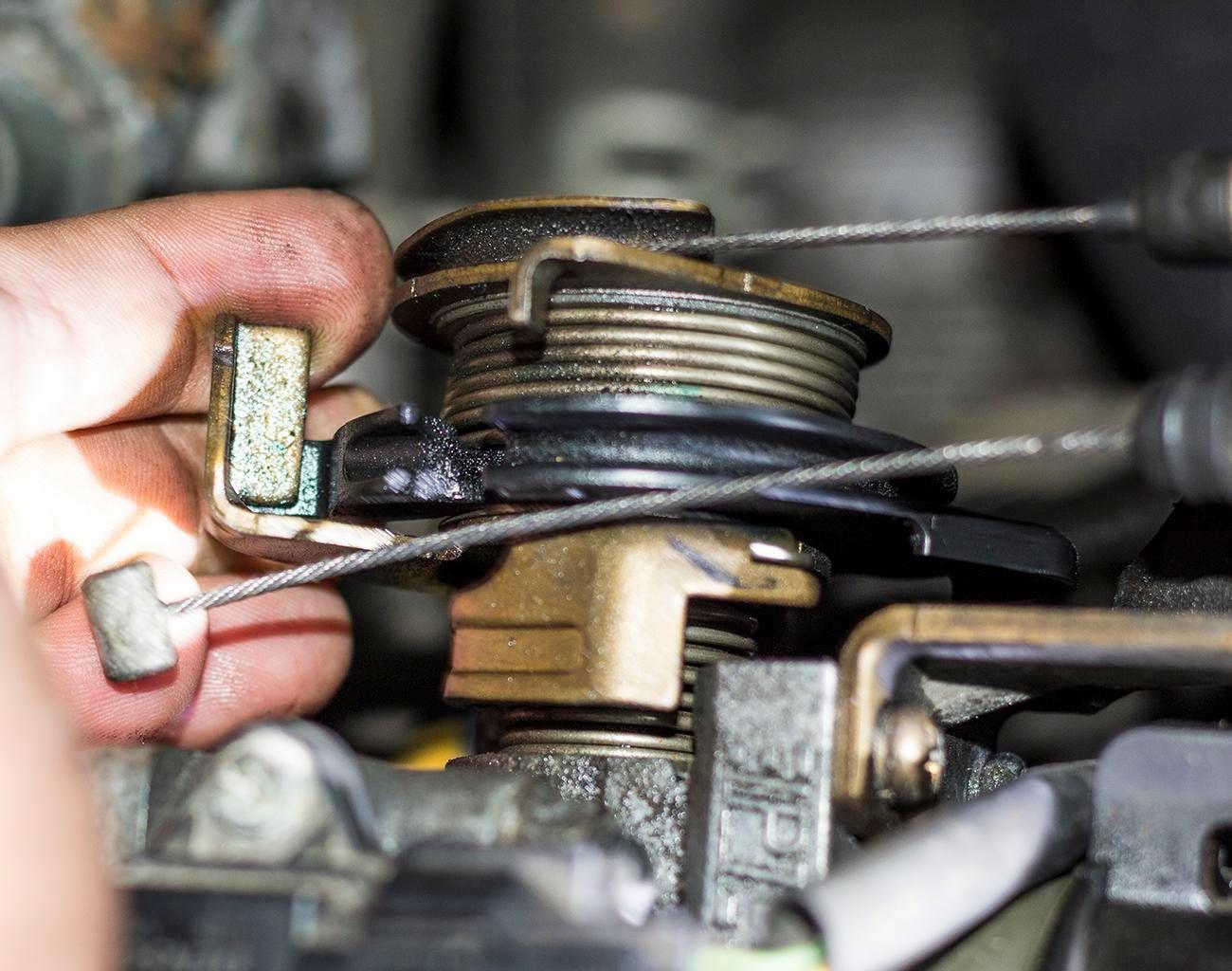

Well, I'm down to the last thing to repair on the $600 TL, cruise control. I'm trying to find pictures of what the engine looks like without the engine cover to compare my throttle body to others. When I push the button on the dash, the green cruise light turns on but the "set" button on the steering wheel does nothing.

Ah! Some deeper searching came up with these pictures. This plastic part on mine is in perfect condition, so, must be something else for me but I figured I would add them here to help anyone in the future.

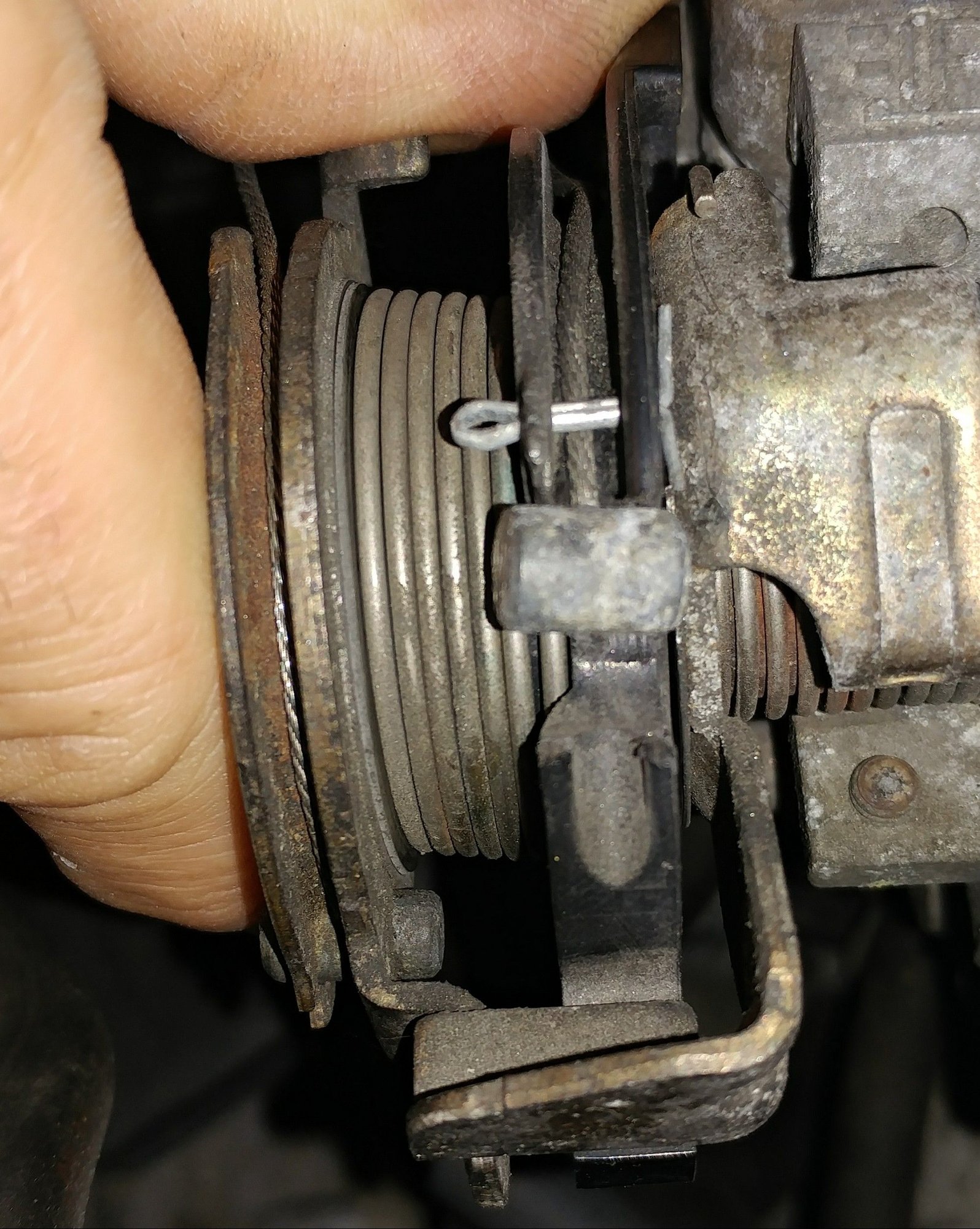

Mine broke a few years ago and here's the fix I came up with.The cotter pin just holds the cable end down to engage the cam so there really isn't much force exerted on it. The only thing you have to make sure of is that the bent tabs of the cotter pin are totally flush with the side of the cam otherwise there could be binding issues between it and the TB casting as the cam rotates. Just took this pic a few minutes ago so it looks like it's holding up ok.

Nice fix there! I was going to plan a salvage yard day but this sounds like a great option if the wheel is broken.

Kris, Are you saying your cam does not look like the pics you posted? IIRC there should just be a small slit for the cable to go through and the cable end is almost fully surrounded by the plastic cam to hold it in place.

Correct, mine looks like new and is all attached as it should be. Just figured I'd post those comparison pictures for others in the future.

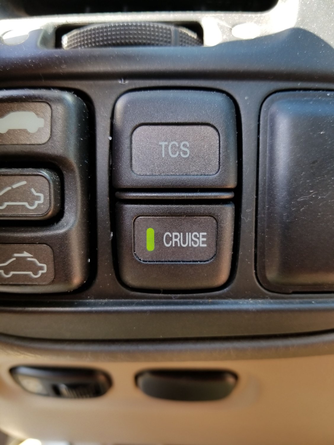

Just so I understand. The Green cruise light above the fuel gauge comes on when you activate the master switch to the left of the steering column?
The green cruise control light should only come on after you press the set button while you are above 25mph and the master switch is on.

No unfortunately, only the green light on the actual button comes on, the dash light never engages. The plastic wheel on the throttle body is in perfect shape so that's not it. I also checked the cruise control box that the line runs to but the wires are plugged in and everything looks fine. I'll have to review the factory manual when I get a chance to work on it this weekend.

Well I had a chance to go out and test everything today. I checked the switch at the brake pedal and it seems to be secure and clicks in and out while moving the brake pedal. I also bench tested my cruise control servo box from under the hood and it makes a whining noise and does nothing. Just for fun, I went to the pick'n'pull and bought a spare CC unit and bench tested it to compare. The new one actually clicks and seems to engage but CC still wouldn't work after everything was put back together. I'm not sure what else to try?? Only thing left is to just replace the pedal switch and/or that box under the dash so I guess I'll do that. I hardly ever use CC but now I've done so much research on it, I'm determined.

If the brake light switch is bad, is there an easy way to tell? Would there be a CEL or issue with the brake lights themselves?

Well your brake lights wouldn't work.
Old May 16, 2017 | 04:30 PM
Posts: 48,317
And you'd have intermittent issues shifting out of park
