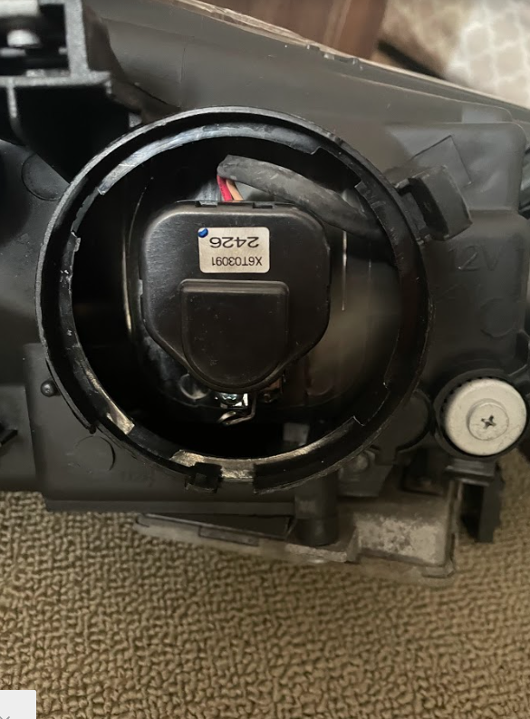

Here is what they both look like:
(side note I finished my installation, they both work fine)
This is the OEM one ^
This is the aftermarket eBay one ^
Old Dec 10, 2022 | 06:39 AM
Posts: 48,313
Strange, might just be an extra ground cable on some headlights.

The wire appears to be soldered to the metal case, if that is true it is a ground connection. If so you can connect this to any metal part of the car chassis. As Thoiboi mentioned these are used on multiple different cars so sometimes you wind up with "extra" connections. I usually connect extra ground connections to the chassis.

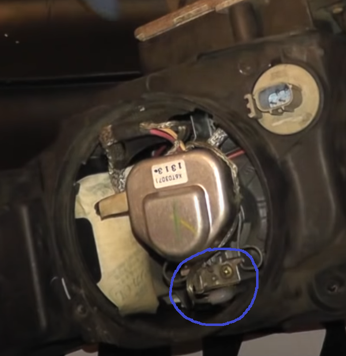

These are two photos from a similar configuration from a 3rd gen tl that is similar to the ignitor i put in my 2nd gen tl. It appears there is no bar to connect it to or the two pin to plug it into in mine, so I left it hanging. Headlights turn on all good.
