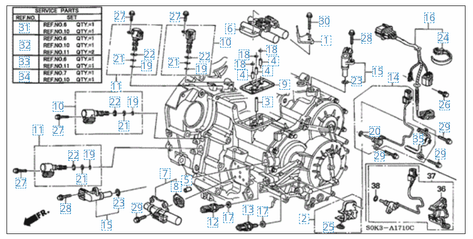

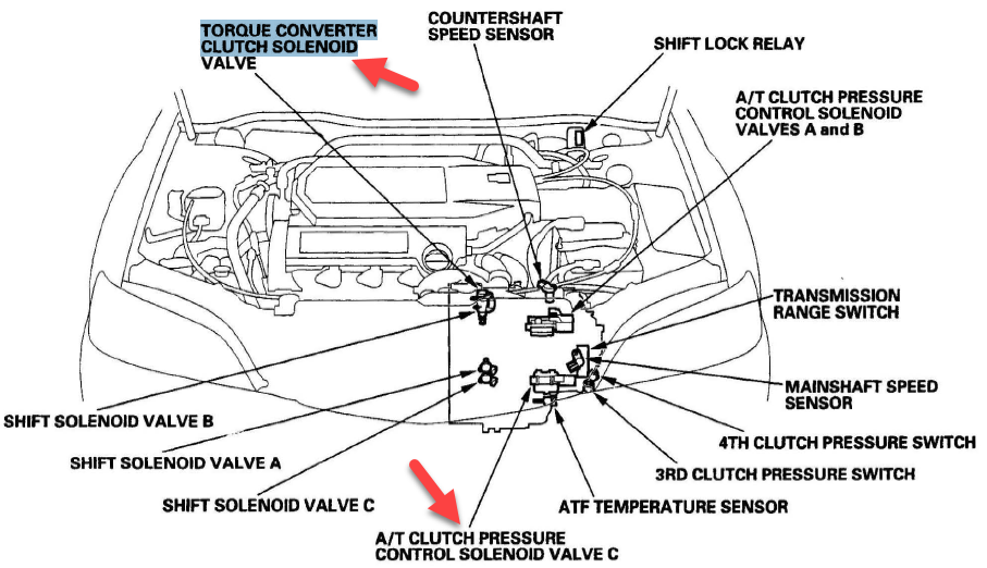

Ok. Sounds as if the fuel system is good as you have control of the RPMs. To me it sounds as if your torque converter is disengaging. This can happen if some of the solenoids are worn. I would replace the Torque Converter Clutch Solenoid set and the A/T clutch pressure Control Solenoid valve C.
The Torque Converter clutch solenoids are located on the top of the torque converter housing under the water hoses. The A/T Clutch pressure control solenoid Valve C is located forward facing on the transmission housing.
I would highly recommend that you try replacing the torque converter solenoid first before buying the much more expensive A/T clutch solenoid.
Clutch solenoids are Items 10 and 11. A/T Solenoid is item number 7
Item 10 = Solenoid Assembly (A) (Keihin) 28400-P6H-013
Item 11 = Solenoid Assembly (B) (Keihin) 28500-P6H-013
Item 7 = Solenoid Assembly, Linear 28250-P7W-003
You MUST buy the exact part number. OEM is best but reputable others should work. Avoid cheap ebay and Amazon parts.

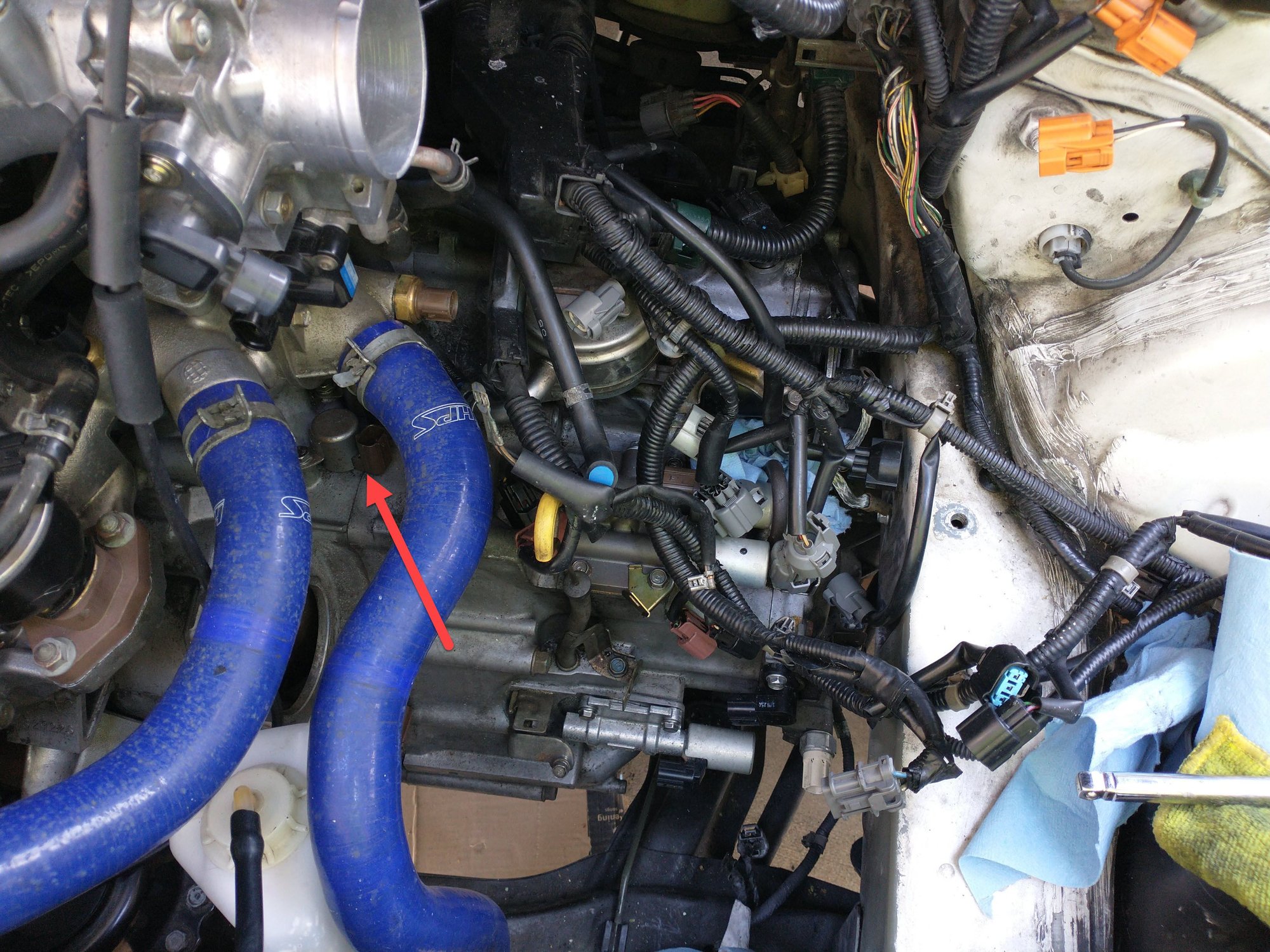

If money is an issue RockAuto has SMP parts for the two solenoids (10&11) they are ~$35 and $39. Otherwise the OEMs are about $67 each. One will have a black connector and will one be brown. Make sure you put them in the correct spot or bad things will happen. Also, see the picture below, the set you want to replace is at the top of the TC housing. There is another set below the starter DON'T replace those. The reason I would try these first is the car runs fine for 15 minutes then after a restart it moves again. I don't see that as being a worn out Torque Converter. I suppose it could be but my experiences is when they start to slip they keep doing it. Also, this is much cheaper than a new TC.
TC solenoids under throttle body and coolant hoses.
