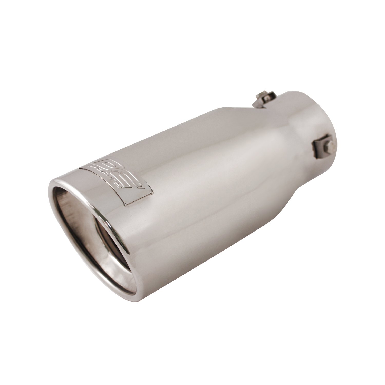

These are the DC Sport Tips (Yes I welded them to the Pipes):
Product Number: EX-1013
