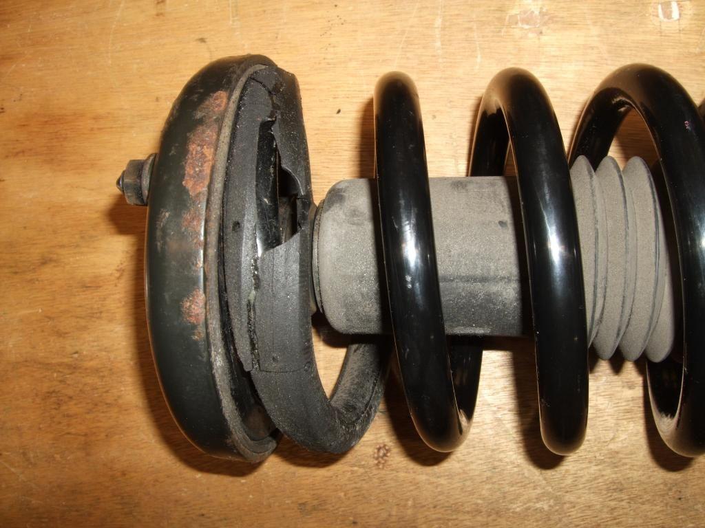

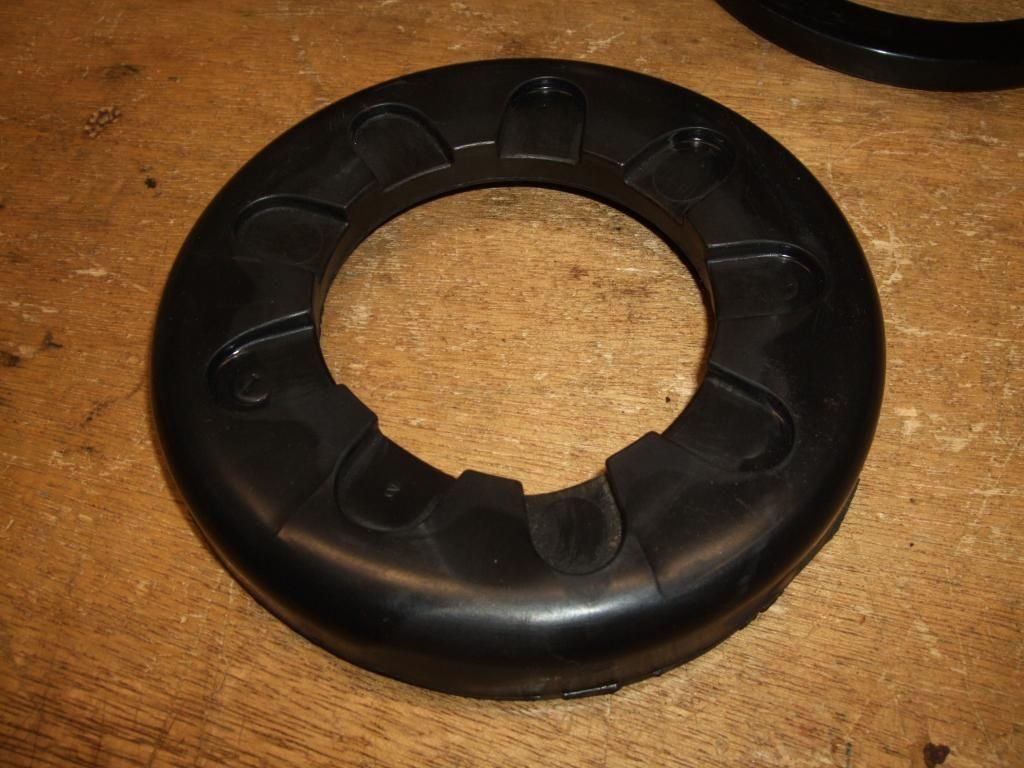

Nope, not the one I was referring to. Like you said, that's the upper spring seat (seen below). That's gotta be in for sure.

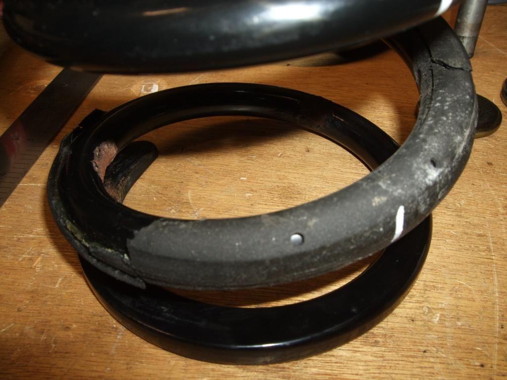

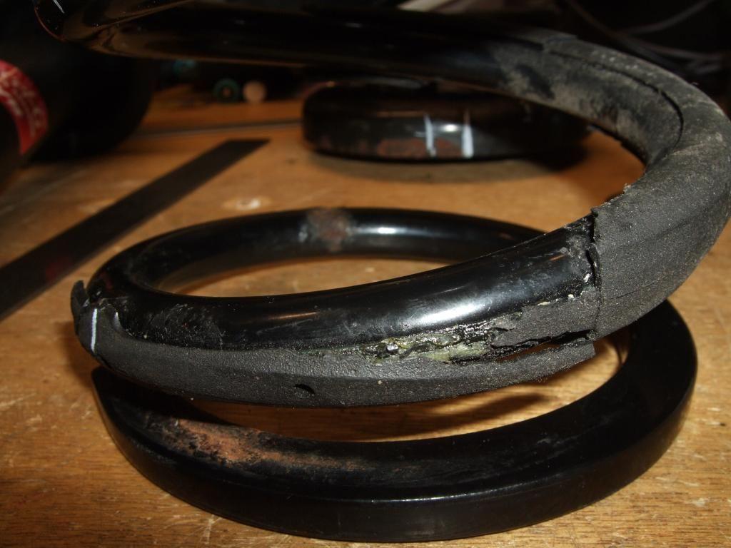

TLer's got it. The rubber half tube that's glued on the upper part. The crumbling part seen below.
Springs sitting upside down on my table.

Oh I see, yeah it's not important. It's probably there to prevent contact with the coils themselves or the body.

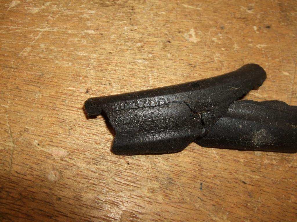

That's in line with my general experience too. Here are the only markings i found on it. I couldn't find anything about it on google. SOL for now i guess. I'll call a dealer tomorrow, and i'm sure other springs on some other vehicle has it. I'll find something, make my own, or give up :P.
