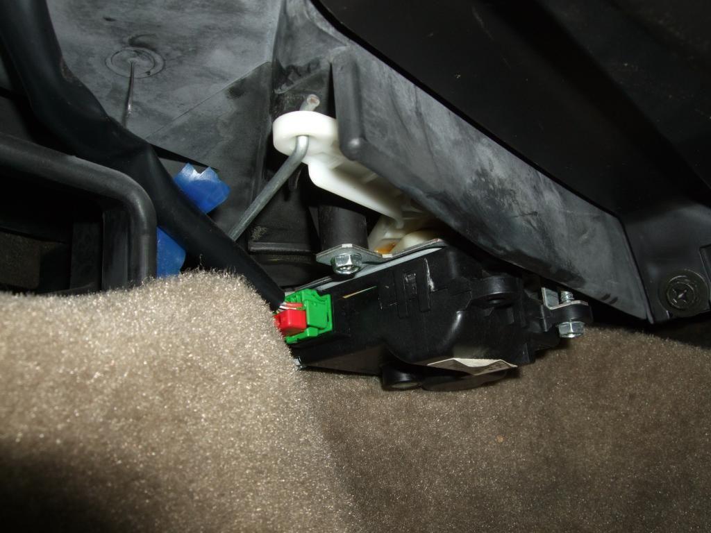

cominfromafar's Avatar
Casper
Posts: 111
Likes: 16
I'm going with the diagnosis of, "funky operating mix motor", if you've checked the coolant and stuff. Here's some pics i just took, if you need to reference them.
My experience with it was in the winter (jan/feb) of 2009, when my nuts were in my throat because my heat wasn't working all of a sudden. I reached down one day and lightly held the linkage, turned the temp to max cold then to max warm, and the linkage wouldn't move. So i turned the temp from cold to warm again and this time i assisted the linkage by pulling it to the left (that's the direction it goes when you turn it to hot), and it worked. I did that several times in that winter season, saying i would change it in the spring, but it started working again and i forgot about it. I may actually have a worn/broken tooth on the plastic gear inside.
So if it is your problem, yank it, open it, give it some care, and put it back.

Old Oct 2, 2014 | 10:48 PM
01tl4tl's Avatar
Posts: 33,535
Likes: 1,142
thanks for the very helpful pics and tips!
Old Oct 2, 2014 | 11:36 PM
Casper
Posts: 111
Likes: 16
Np. Btw, when i said "yank it", in my head i was was implying to remove the module and do your maintenance, but yeah, check the linkage movement first of course as described.
