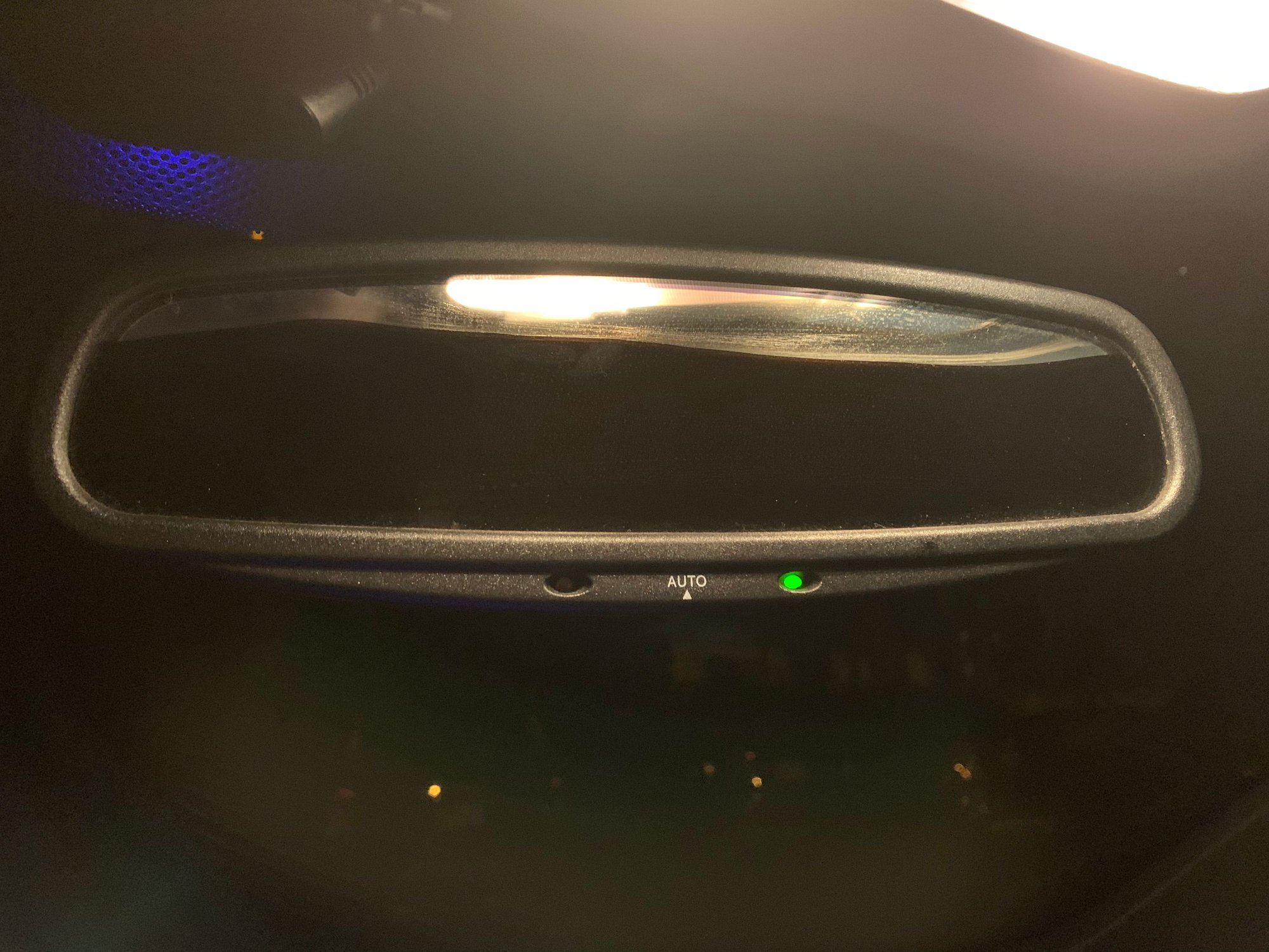

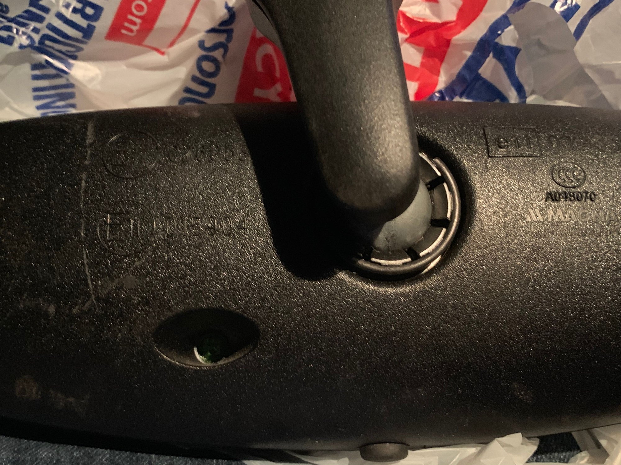

Hey guys,
so picked up a replacement rear view mirror because the idoit previous owner tried to tint the current one and failed horribly. Any ideas how I can replace just the mirror and put on the replacement? Can I pop out the original and put in the new one?
This is the current one.
This is the replacement
Can I take out the moveable ball? And replace the crappy one with the new one..well pop out the mirror itself from the ball.

Originally Posted by Jamesharoldk
The video wasn’t much of any help. I’m having issues and I’m getting frustrated trying to remove the old one. Any ideas?
It's an auto-dimming mirror. No one tried to tint it. What you're seeing is typical of how they fail. Talk to a shop, they should be able to tell you or ask Acura Service Dept. Since it's wired in, you probably need to remove it from the arm and disconnect the power wire to it and then swap it out. Is there a retaining ring that you can remove?
It was actually super easy found a step by step and was able to get it off. Me just over thinking things like I do.

2G TL Type S with auto-dim mirror. Used the Acura shop manual instructions and a T20 torx bit to slide off the mirror (removed the plastic cover piece over the wiring first).
Replaced it with a flip up/down mirror from a 2005 Nissan Altima 3.5 SE. Perfect fit, same amount of mirror surface area, more compact. The auto-dim was failing, year-by-year, to dim as much as it did when new, and the addition of rear window tint messed with the dimming logic (as in, it wouldn't dim enough).
