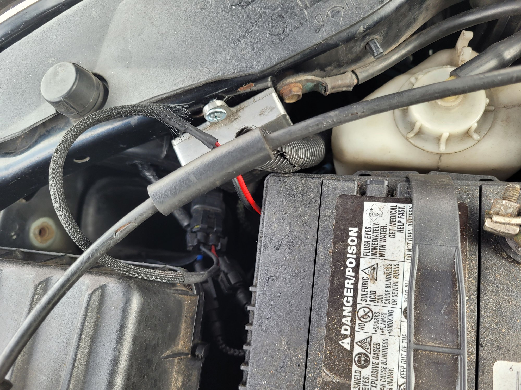

I failed the safety inspection for having an aftermarket HID kit. The bulbs are D2R but the inspector told me I need to put back the original HID kit. Is it the ballast and ignitor?

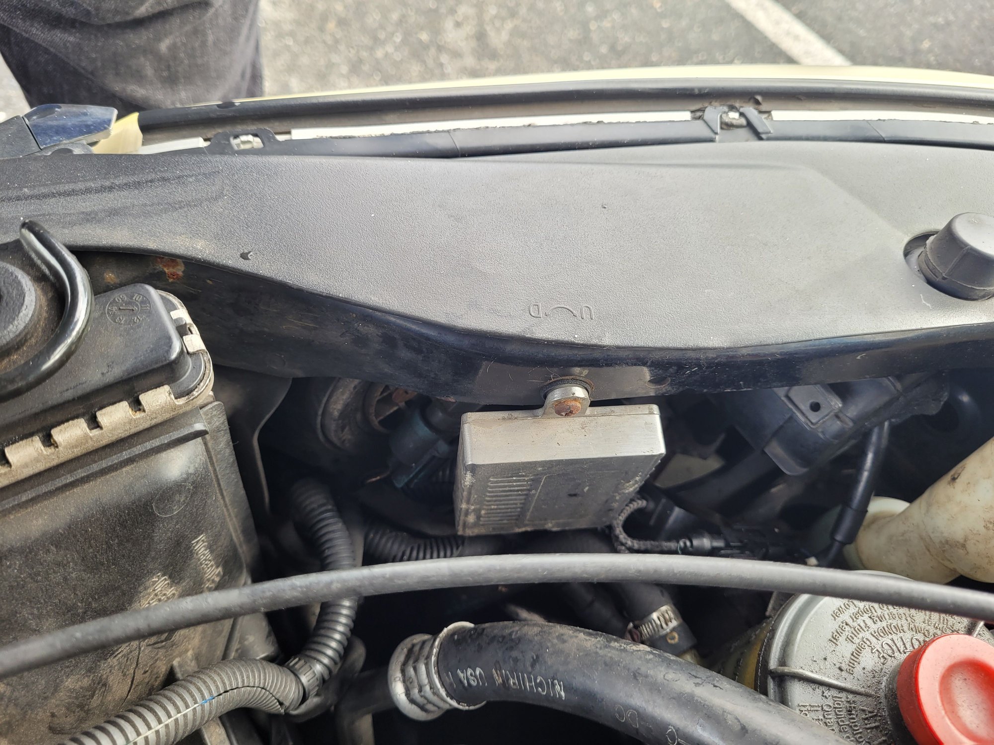

this is what I have installed now

Just curious, could it be the reason the 'inspector' is being a PIA be more of an issue of where you have mounted the ballasts on the radiator support, in terms of 'safety'?
Since the OEM one normally lives under each headlight unit and is not 'viewable' like your current ballast mount set-up?

Seems like it. Can you find a way to mount the ballast in the original location (beneath the headlamp where the OEM ballast is normally mounted)?
You'd probably need a way to route the wiring in a less conspicuous way, there's probably a safety concern with the wires being out like that.
Are you dem ballasts still in tact? I believe that they seal the headlamp assembly to prevent elements (dirt, dust and moisture) from getting inside the headlamp, without it the headlamps will definitely not be as clear as they could be on the inside.
Are you interested in some part numbers for replacement parts that will fit oem style and work with the bulbs you have? I replaced my headlamps beginning of the year and can provide some good and some bad part numbers.

It could be. That's a good point. Now that I recall he did mention something about the wires.

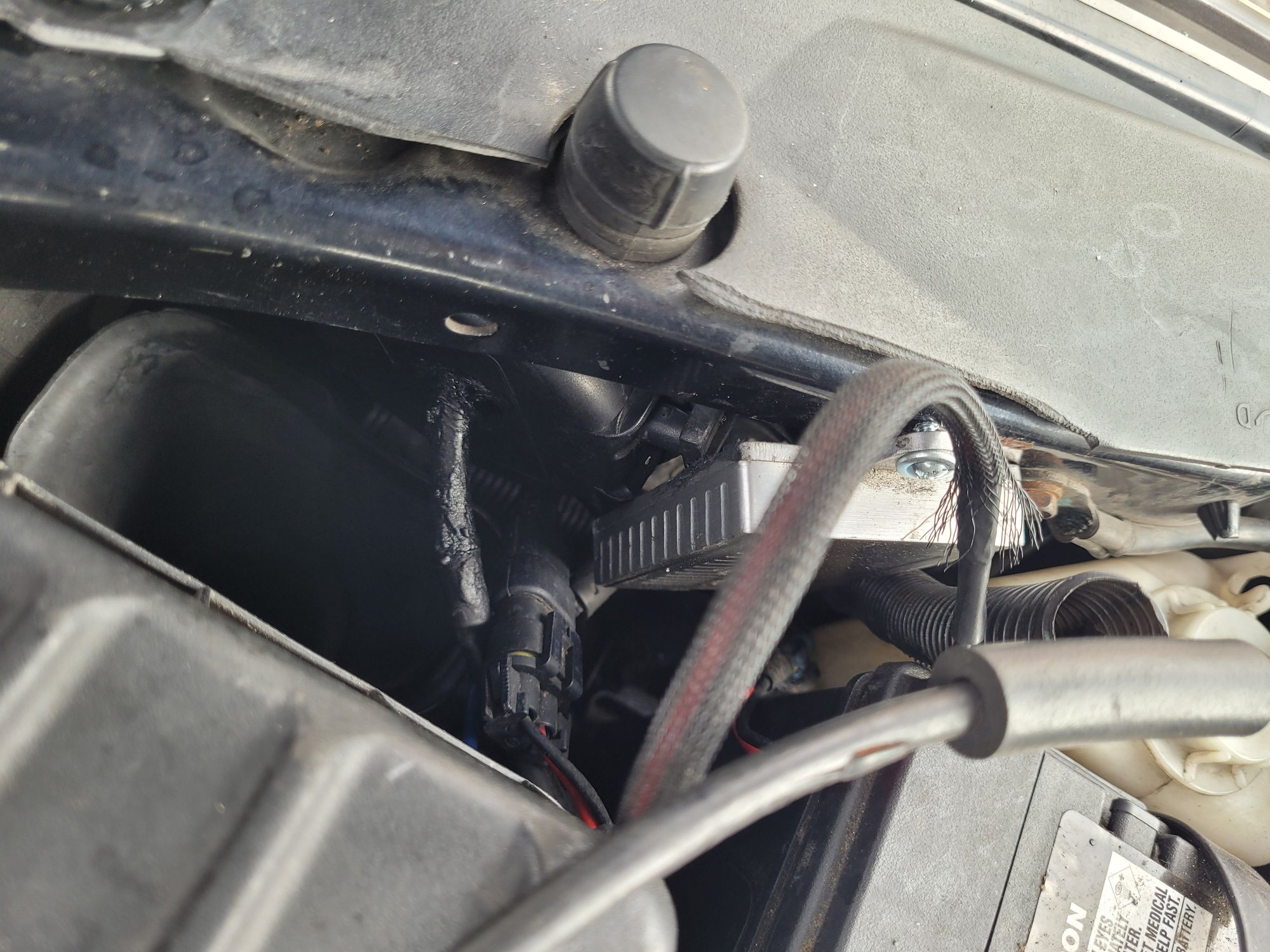

The person who installed the aftermarket kit suggested mounting it this way because of the size or something else, but I can't remember exactly, as it was so long ago—about 10 years ago
So, just to clarify, did the installer actually remove the headlight assemblies to remove the broken bottom mounted OEM ballats/igniters or are they still there?
I only ask because when I replaced mine, many years ago, with an aftermarket set-up, there was some 'fabrication' involved to get them (ballasts/igniters) bottom mounted on the headlight assemblies.
Then, of course, there was the whole reinstall of the assemblies and FSM adjustment process for proper aim of the hi & low beams.

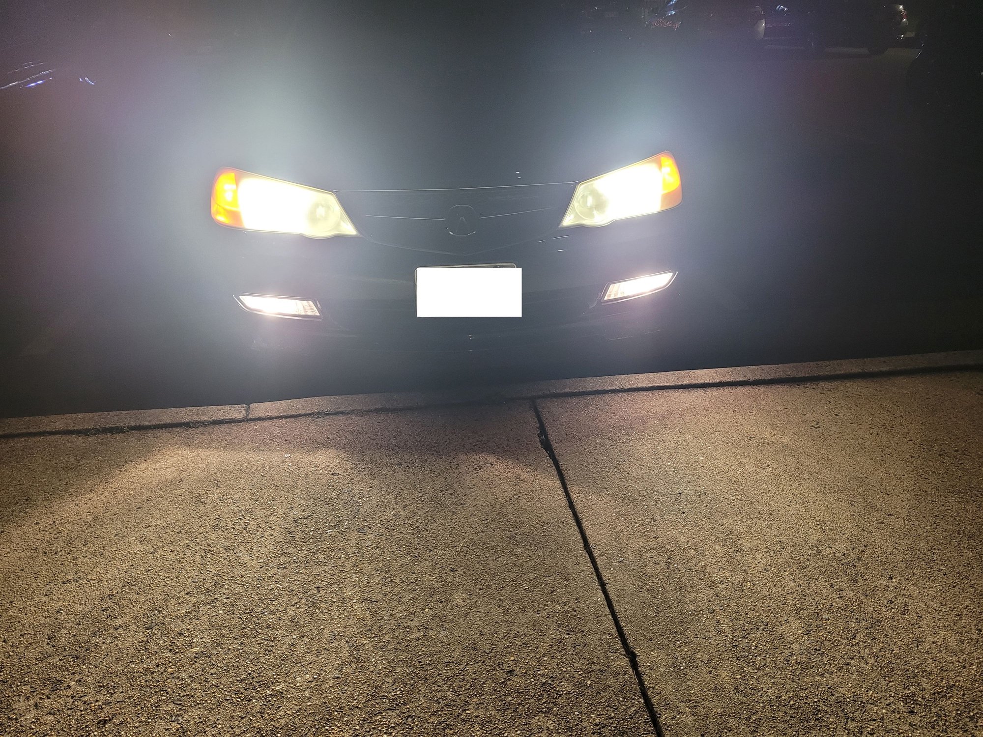

Current HIDs at night
I have a mechanic who can check that. I don't have issues with debris showing inside the lens area. However, the lens area fogs up, but it may still be there. Is there a way to see it without removing the head unit?

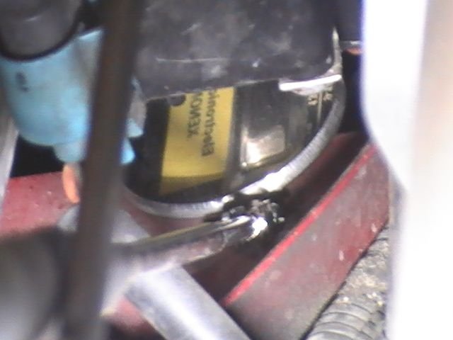

If you have a small mechanics mirror you may be able to on the passenger side headlight assembly.
Here are a couple from my CL-S passenger side, sorry that they are blurry.
You can see the yellow sticker on the aftermarket ballast, though barely.
Not sure if you'd have the same access on your TL.
The $64K question is how did you get away passing yearly inspections, with the ballasts at their present location, all of these years?

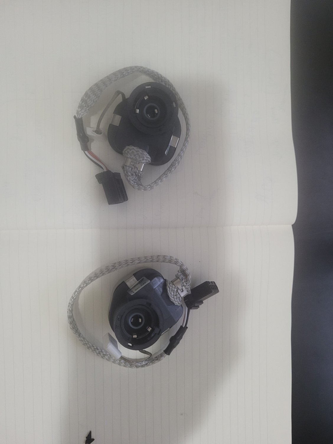

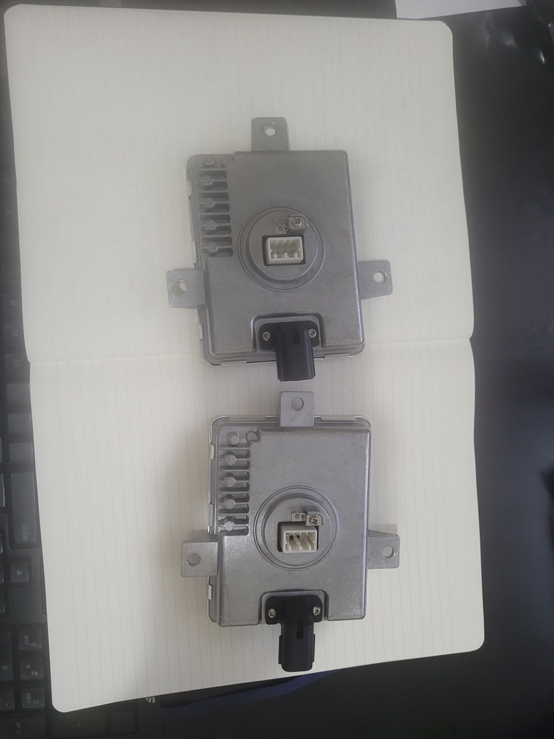

Ok.just received the parts this week. Does the Ballast look bigger or no?
Ballast
Ballast
Ballast
Ballast
Igniter
