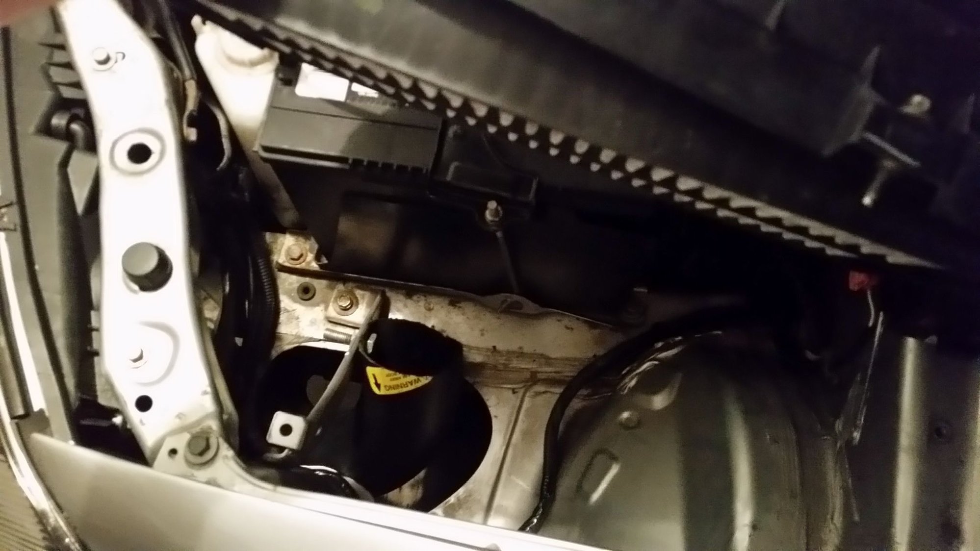

1. I think the stock resonator was damaged and my car does not have anything underneath the air box. I don't mind the sound of the intake, but my wife hates the humming. Does anybody have those parts for sale (or better yet, free)?

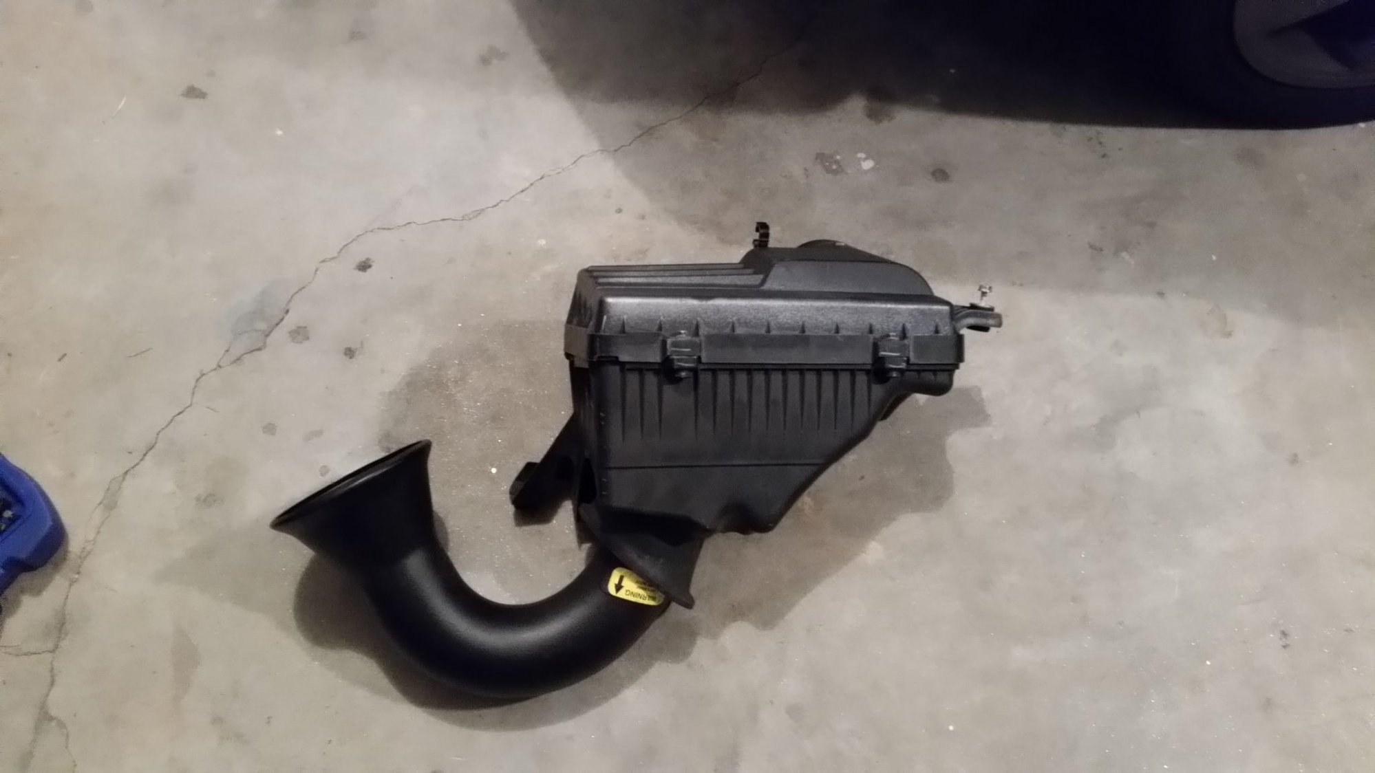

Alright, so I just did away with the air box altogether.
Just screwed the filter to the upper portion and removed the lower part. Ran a snorkel from an opening in the front of the bumper to just below the filter. The hum is gone, the intake is quiet until you step on it, and it pulls much better.
I'll take a look at the iacv this weekend. Thanks again for everyone's feedback.

Can you elaborate or post a picture. At first, it sounded like you created a SRI, but then you mentioned running a snorkel. Second part leads me to believe your stock intake is in place and you added a snorkel to the bottom where the intake resonator used to sit?

It's basically a sri and the tube would direct some air to the filter when moving. Probably not effective from a standstill, but I could feel enough difference to say it was worth the time.
Old Sep 23, 2014 | 10:18 PM
aTLanta1's Avatar
Joined: Sep 2014
Posts: 18
This is what I initially tried, but the hum was louder. Removing the lower part of the air box took away the resonance

Ok, that makes sense. Basically you made a custom CAI or (SRI with airflow snorkel - e.g., Icebox). Still got hum, so you cut the snorkel.

ahhh you kinda want that airbox setup- supposed to remove lower res box and its Y connector to main box but leave in place
ok to drill a few more large holes in bottom of box
A lot of critical ecu information concerns air temp and flow rates, as well as protecting the filter from water splash and penetration during large puddle encounters (see hydro lock)
notice no one else has suggested what you have done - NOT anywhere near the diy! and we have tried everything
keep you foot out of it and under 4000 rom and noise hum should not be an issue
Keep spouses favorite cd ready to go in the car- covers all noises!
Thanks for your feedback. The noise was annoying only at idle. My son's room is directly above the garage and he was able to hear it! lol
The car's running great right now without a hum. It's basically a sri with a regular filter. I think it sits high enough to not worry about hydro lock or water getting to it. If anything does act out of the ordinary, I'll figure out another solution.
