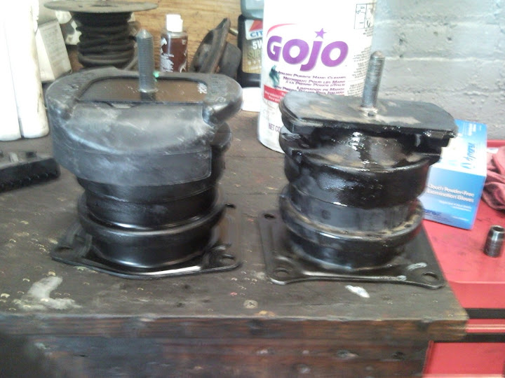

what happens is: the tech puts the car on the lift and sees the bottem of the front motor mount has its special hydraulic fluid leaking out.
If you notice a few strange oily drops on the floor, under the radiator, after being parked....front motor mount likely
Its really easy to replace the front mount with trans out- dealer only charges .3 of hour!
the part cost ~$120, its fluid filled and some years are vac boosted during hard throttle!
The passenger side mount is often found bad at the same time- use normal visual, prybar and brake/throttle test to check it
Doesnt matter if trans removed for that one.
Depending on mileage it can be smart to pull the flywheel and replace the engine rear main oil seal- $10
If it fails the trans must be removed, and at 450 pounds, not a job you want to do twice on the garage floor- IMO

Rear mounts don't go bad, save yourself the $$$.
Front mount goes bad, and side mounts go bad.
Simple brake TQ in Forward then Reverse will show ya a bad front or rear engine mount.
Most dealers charge about 550 to do the front or rear mounts. I know we do the fronts on MDX,CL/TL about 10x a week minimum in our shop.
Dude, rear mounts go bad. Ill show you a picture of mine when they take off it and you can decide for yourself. Im sure they last much longer than front and side but they still go bad with time.

I've been with Acura for 8 years now.... and I have NEVER seen a rear mount go bad. I sell the front ones like they are goin out of style.
Unless the car was in some kinda collision and the frame is tweaked putting stress on the rear mount. I just asked my buddy who works next to me how many rear mounts hes seen go bad.... he asked if you are on drugs. We combined have done probably around 10K TL/CL/MDX transes over 8 years.
Never seen it.
Never seen it.
Here you go, the one left is obviously the new one, the one of the right is one you would say isnt broken. Obviously the hydraulic fluid its cover in wouldn't be a sign that its broken for you either. Also the fact that my car stopped shaking violently once they changed it out wouldnt mean anything to you.
I guess I should ask you what vocational school and you ur buddy flunked out of and who you had to blow to get a get a job with acura. Thats 10k acuras over the past 8 years that you didnt service properly. K thanks bye.
