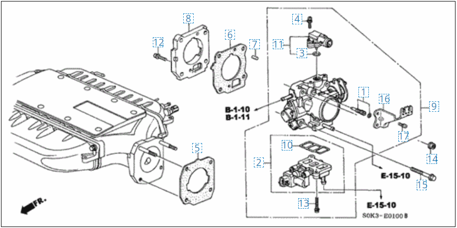

Parts you might need.
#5 Gasket, Throttle Body
16176-P8F-A01
#10 Gasket, Rotary Air Control Valve
16456-P8A-A01
At worst case
#2 Valve Set, Rotary Air Control
16022-P8A-A03
Please go to an Acura parts site and confirm the part fitment using your VIN number.
